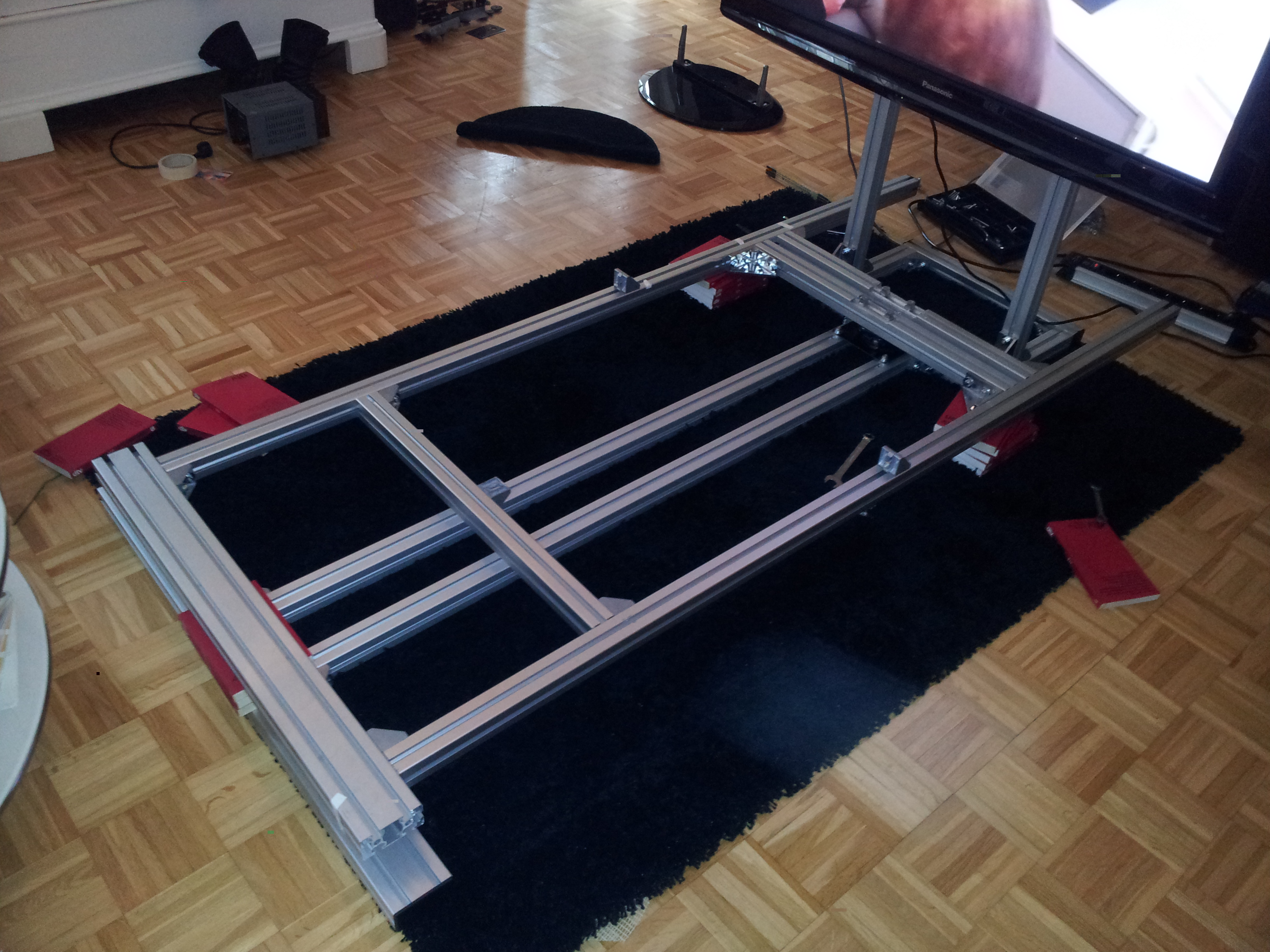

This is a very nice build!
Can I ask you howmuch did you spend on that aluminium frame?
Grtz
Arno

Postby yokoyoko » Fri 21. Sep 2012, 20:28
@ Arno
The aluminium I ordered at "BlankMt" it is a seller located at the south of germany. He sells this alu stuff on ebay.de too.
I used 45x45 and 45x90mm parts (called Nut10). Meanwhile i am sure 30x30 for the frame would be ok too but on the critical parts I recommend minimum 40x40mm.
This stuff costs about ~10€ per meter. The bigger one ~17€ per meter. They ship length to 2m. Shipping cost in germany are about 30-40€ for the whole sim.
I dont know if they ship to the netherlands? Where do you live exactly??? I am going to amsterdam for holliday in a month, if there is no option for shipping - please pm me.
But please keep in mind - the mounting things for the aluminium are close as expensive as the alu itself. 10 piece 90degree "holders" will cost about 20€ the small and 50€ the big one. I needed ~40 piece of this so far...
At all this alu is cool stuff - it is like lego for big boys.
Best regards
Yoko

Postby dearn » Fri 21. Sep 2012, 20:53
Hi Yoko!
Thank you for the information. My current frame is build out of steel. I still need to make a frame for my 23" Lcd monitor, this material may be a good alternative. (The monitor will not be on the sim, and I don't like a table for it)
I will take a look at it!
I live nearby Arnhem, next to Emmerich am Rhein and Kleve.
