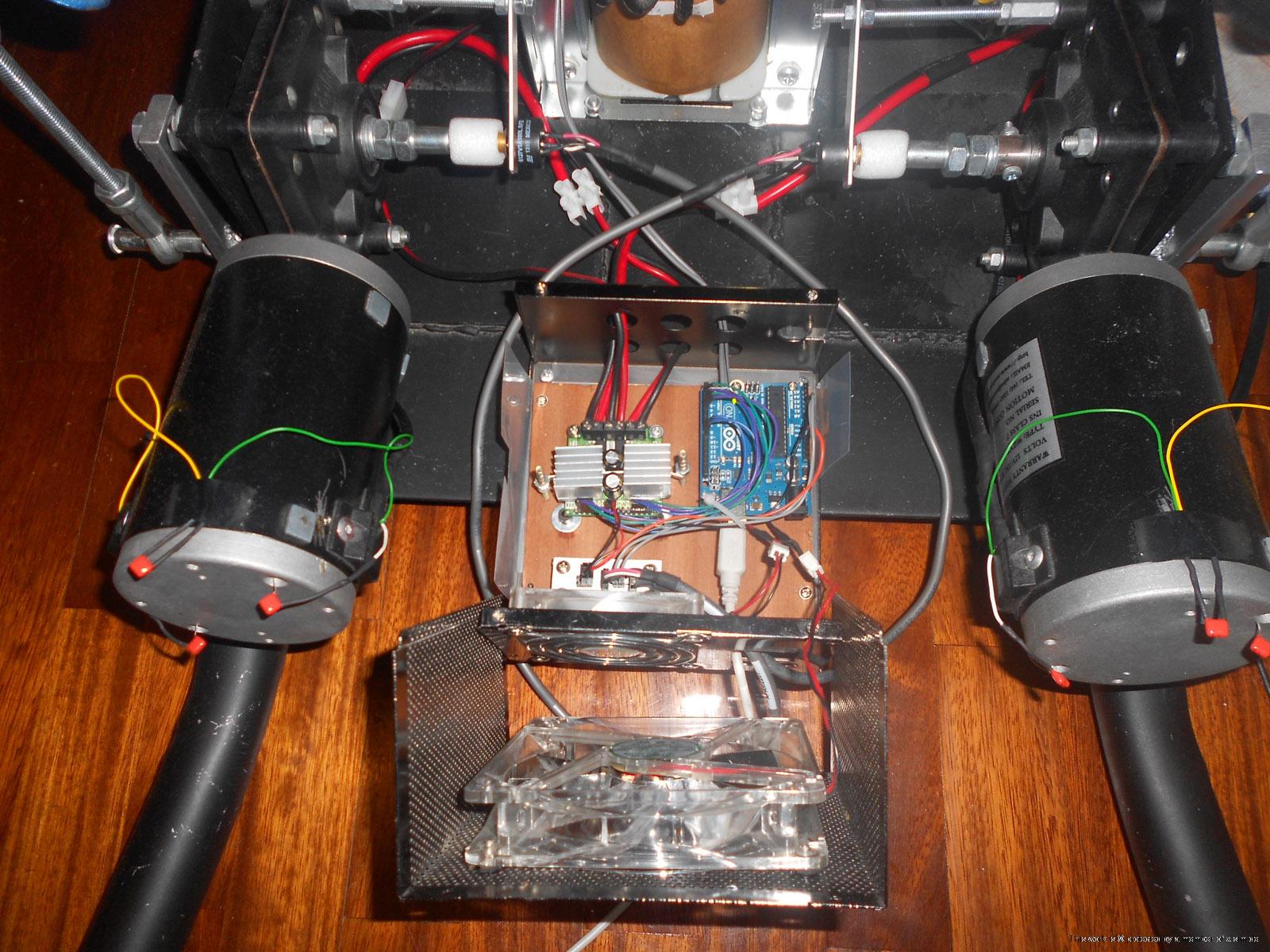

hi all,
After a period out, i am trying to finise my project.
i abounted Thanos Amc and bought an arduino R3 http://www.pololu.com/catalog/product/2191
http://imageshack.us/a/img841/8691/iqzv.jpg

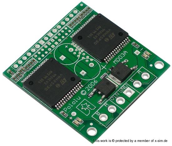

i also bought Dual VNH2SP30 Motor Driver Carrier MD03A http://www.pololu.com/catalog/product/708
http://imageshack.us/a/img7/930/b3wh.jpg

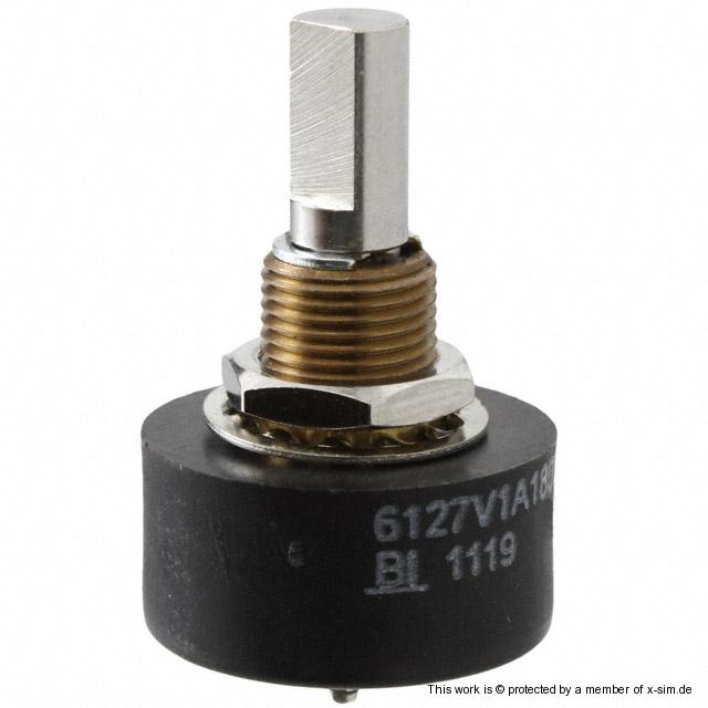

and for pot those: SENSOR NON-CONTACT SINGLE TURN 6127V1A180L.5 http://www.digikey.com/product-search/e ... vendor=987
http://imageshack.us/a/img824/3699/a4i1.jpg
For programming the arduino i used this code:https://github.com/X-Sim/X-PID-Arduino-PID-motor-control/blob/master/XPID-Arduino-Firmware/XPID.ino
i have assambled all in the sim and will start testing it.

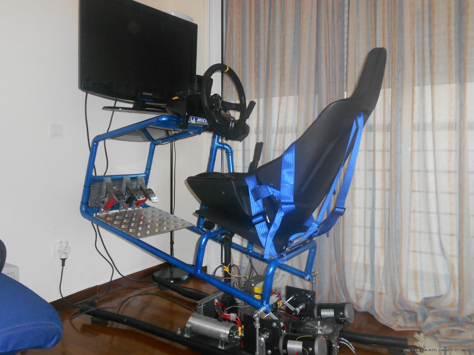

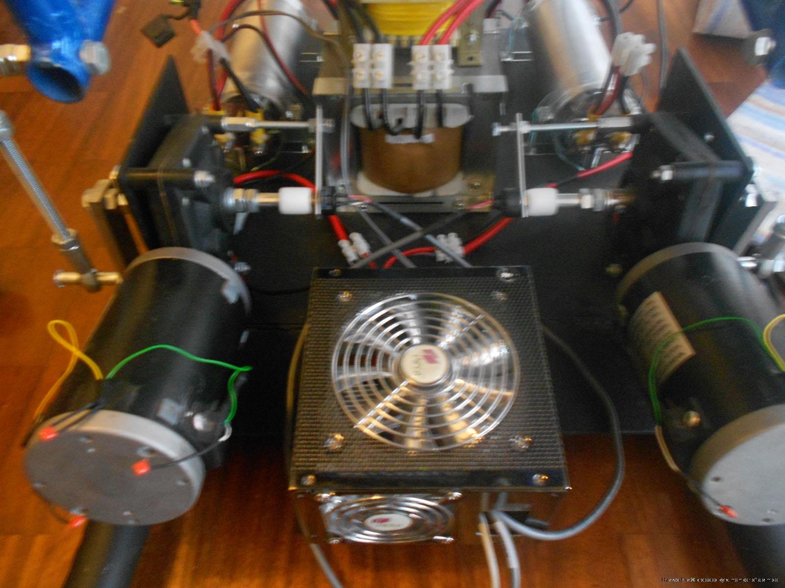

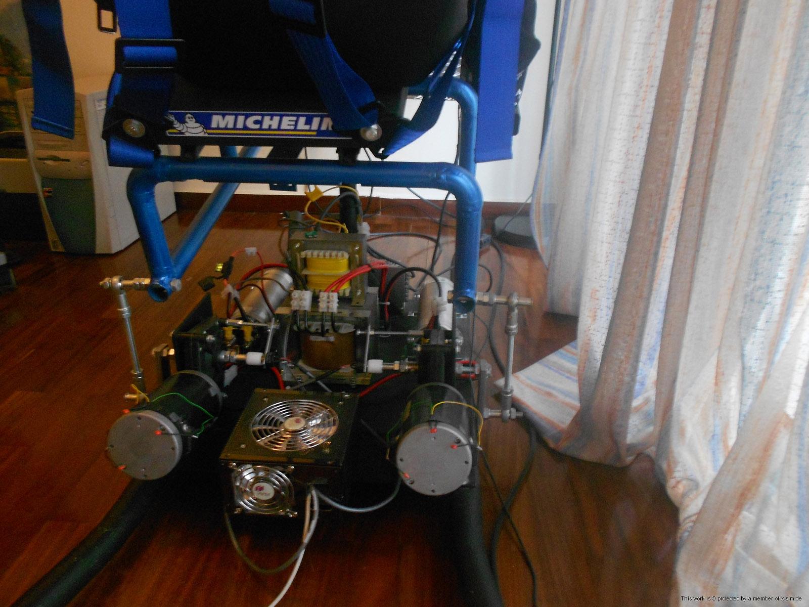

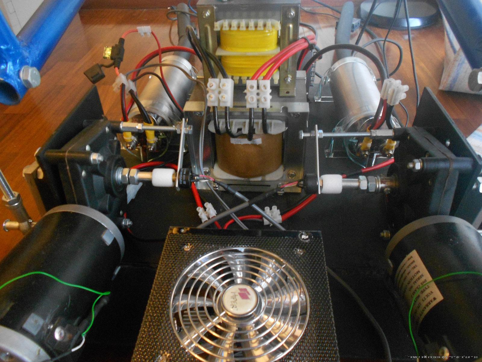

Postby spartan300 » Tue 29. Oct 2013, 21:45

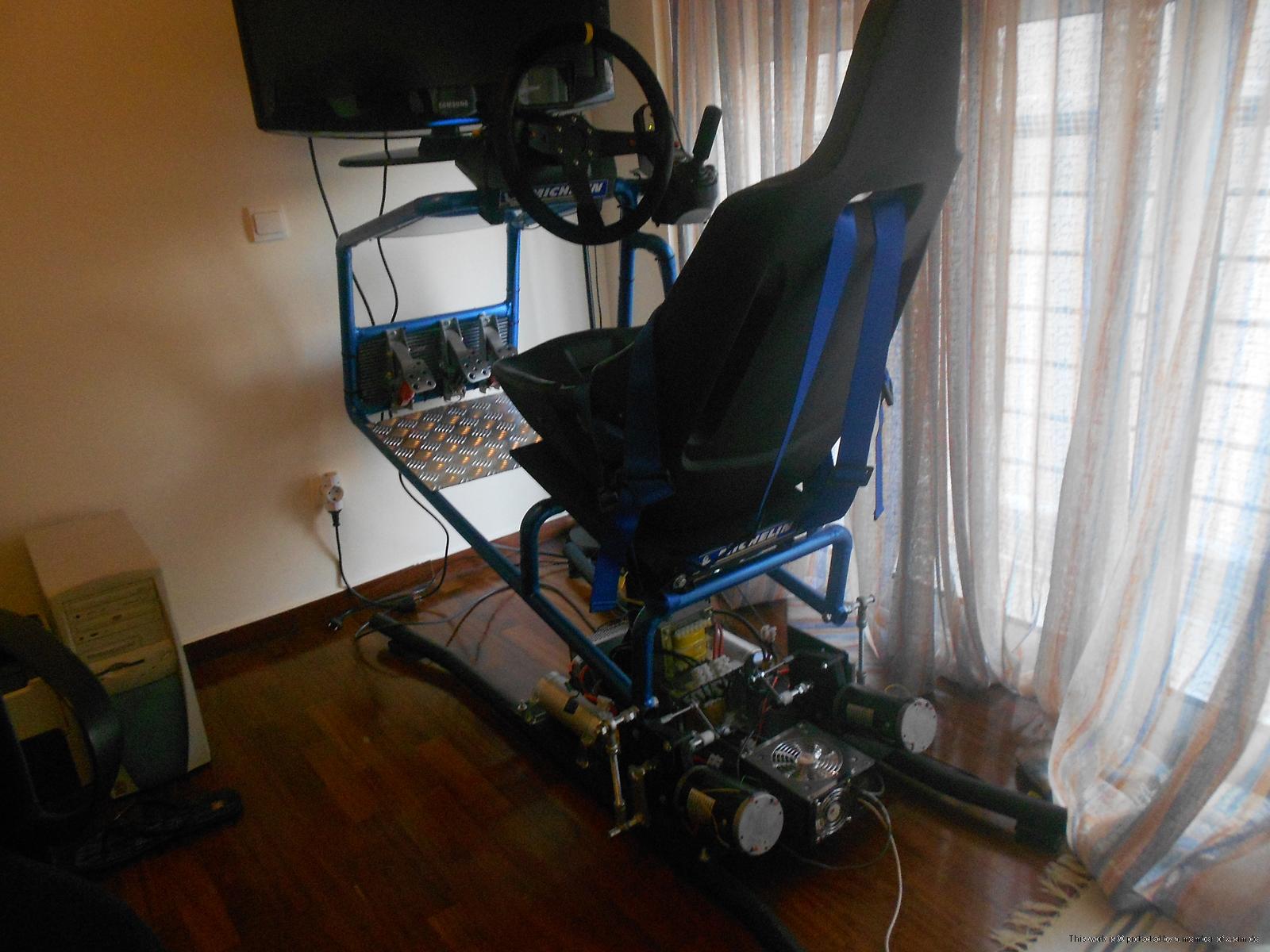

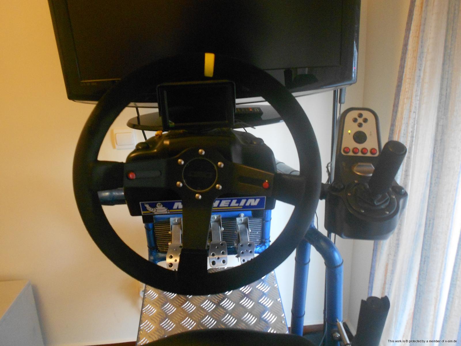

UPDATE 25/10/2013
2263226122622272227122702268225922582260
spartan300
Posts: 36
Images: 16
Joined: Thu 9. Aug 2012, 20:41
Location: Athens Greece

Postby prodigy » Tue 29. Oct 2013, 22:31
Can this Pololu driver handle those big motors?
I had big troubles with same motors ZYT90 and Pololu JRK's, I also did the similar rear mount like you and I couldn't get it to work, JRK's couldn't handle that load and they were "choking". I had to resemble everything and do the shoulder mount to make it work.
I'm curious to see how this is going to work, have you already tried it?

Postby spartan300 » Tue 29. Oct 2013, 23:37
prodigy wrote:Can this Pololu driver handle those big motors?
i made i few tests, they move it but sometimes they act like they are "loosing" there position and move free.
I will try to make a video with the setting and the problems that happens.
