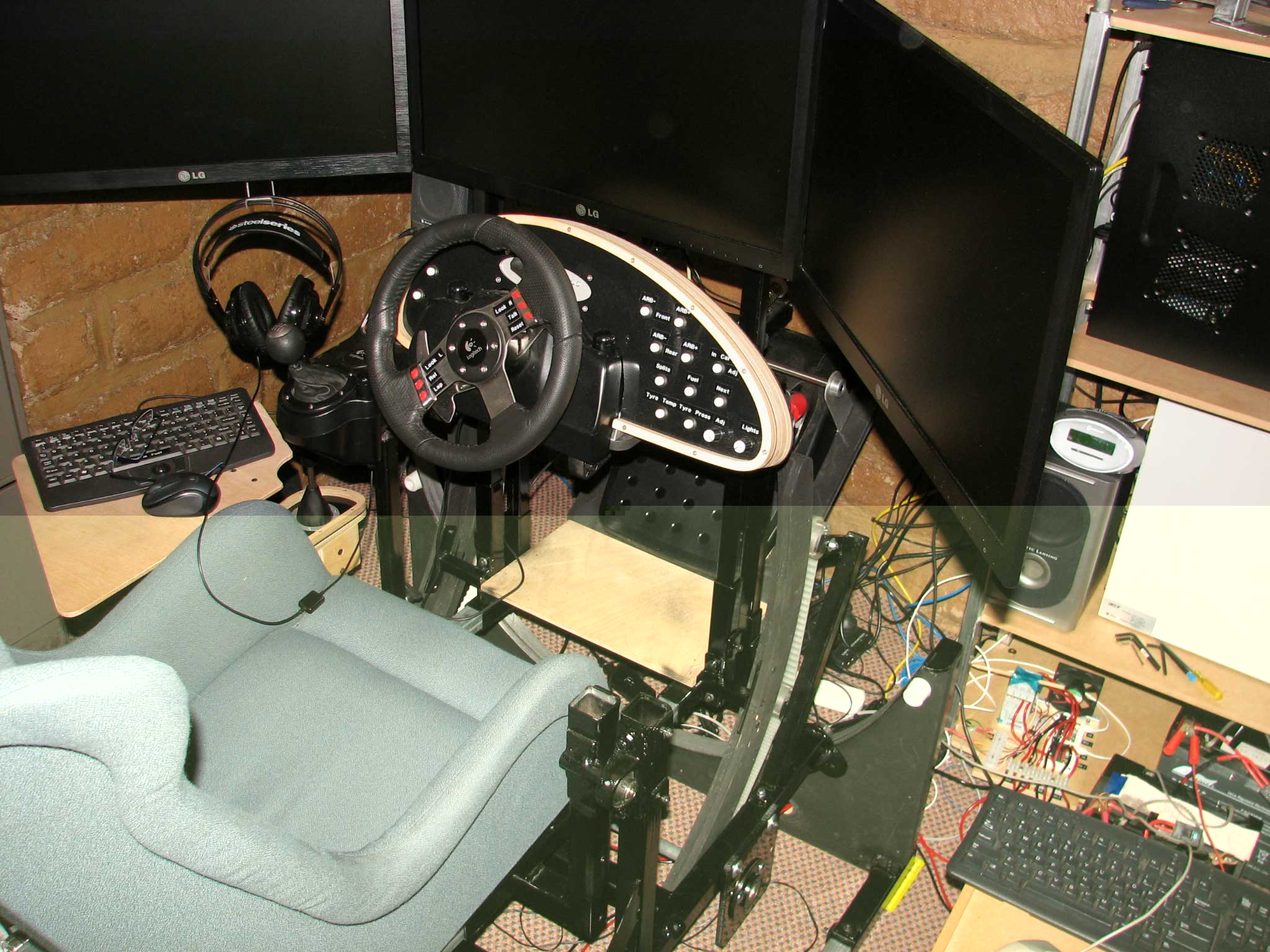

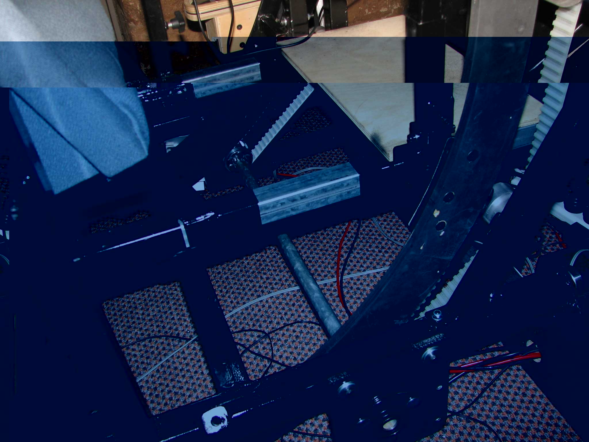

Below I have given a bit more explanation on some of the things I have done on my sim.

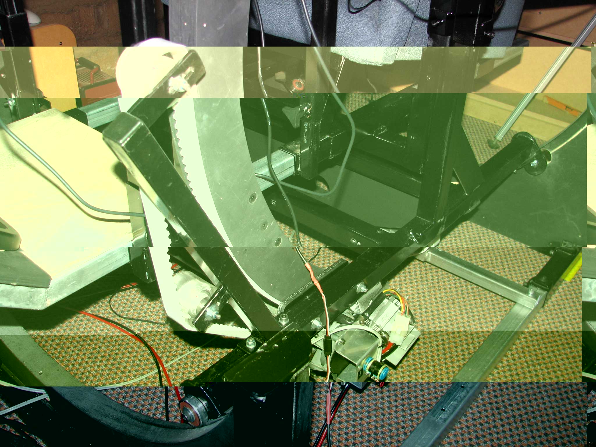

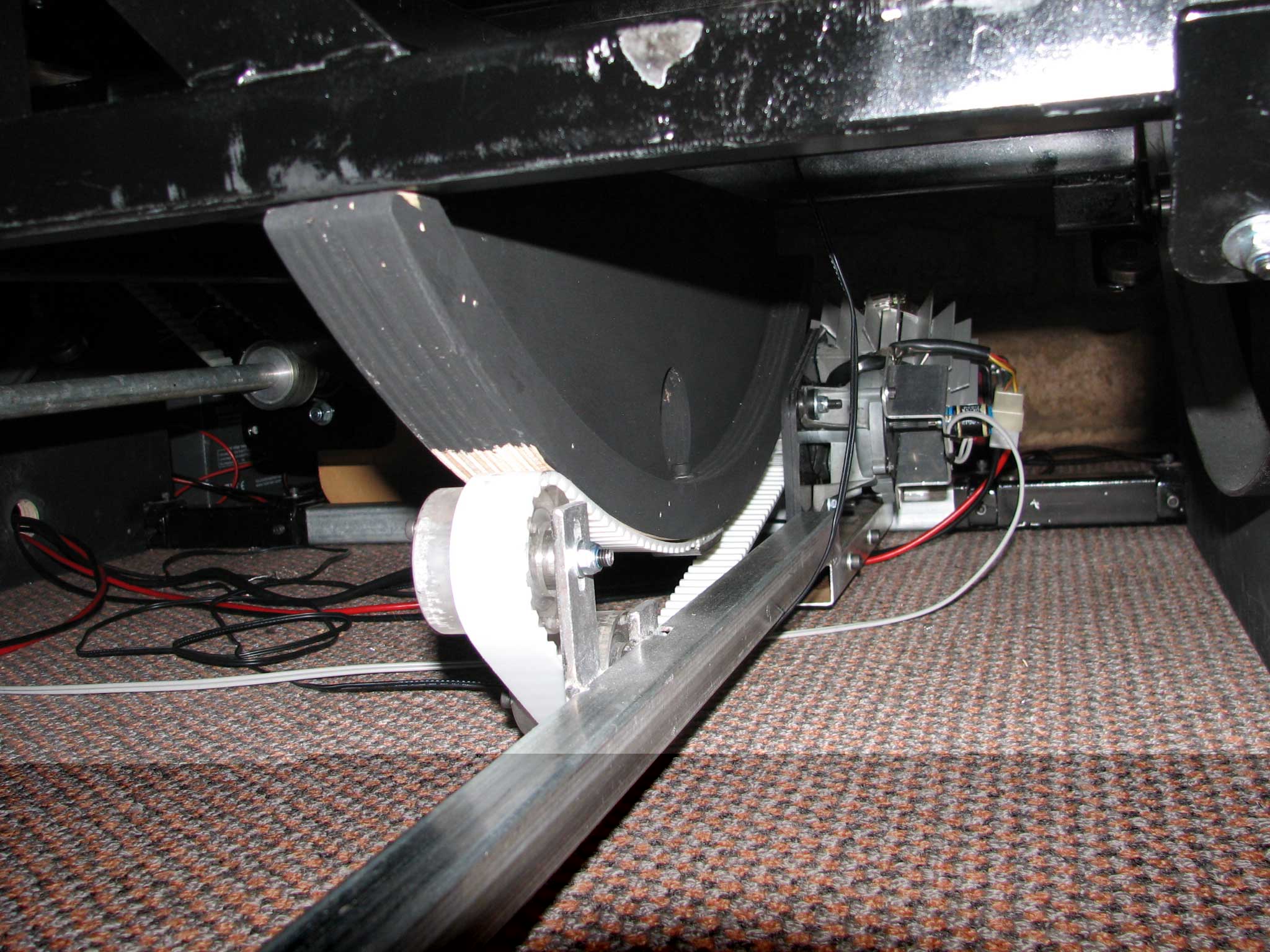

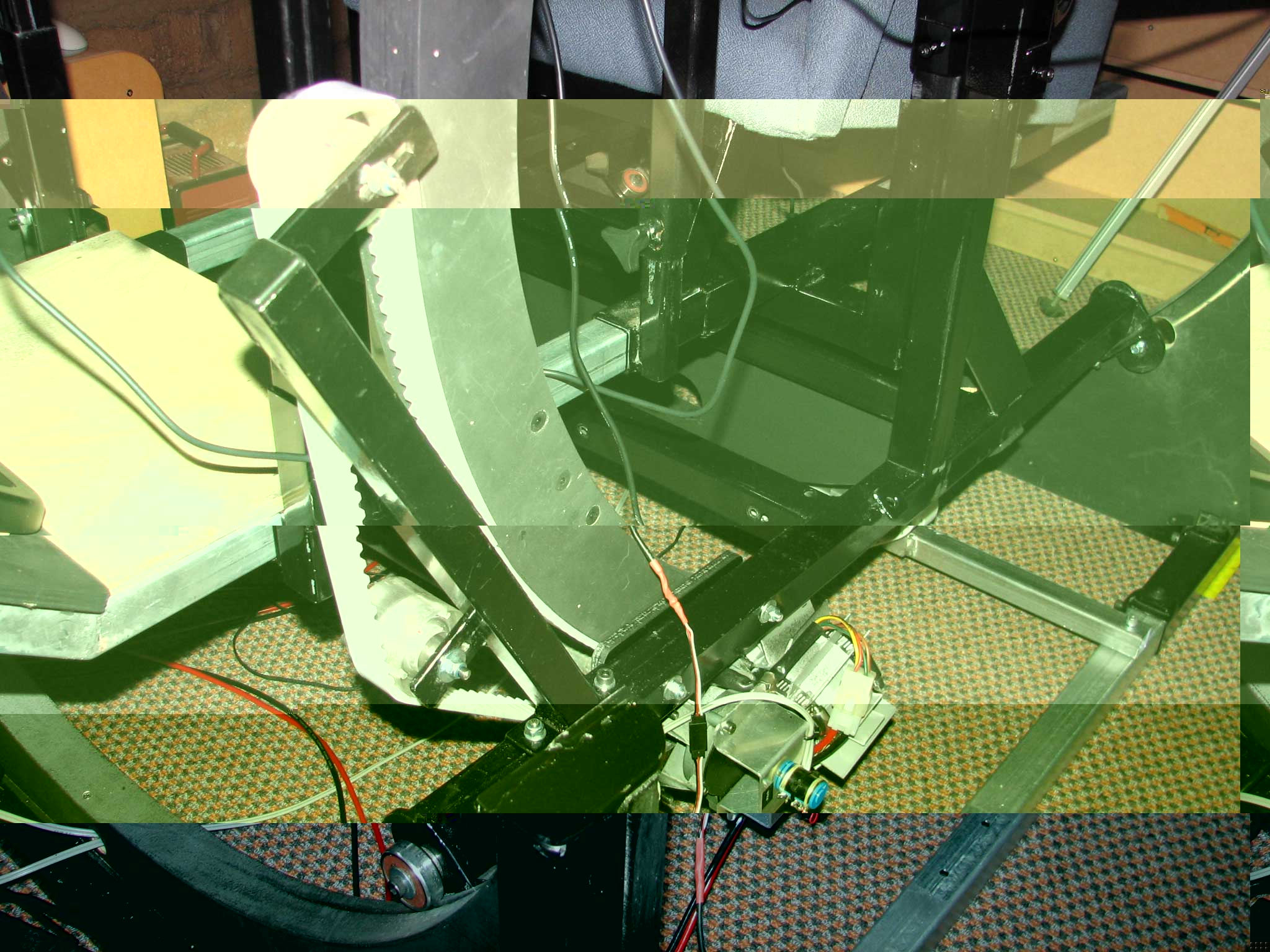

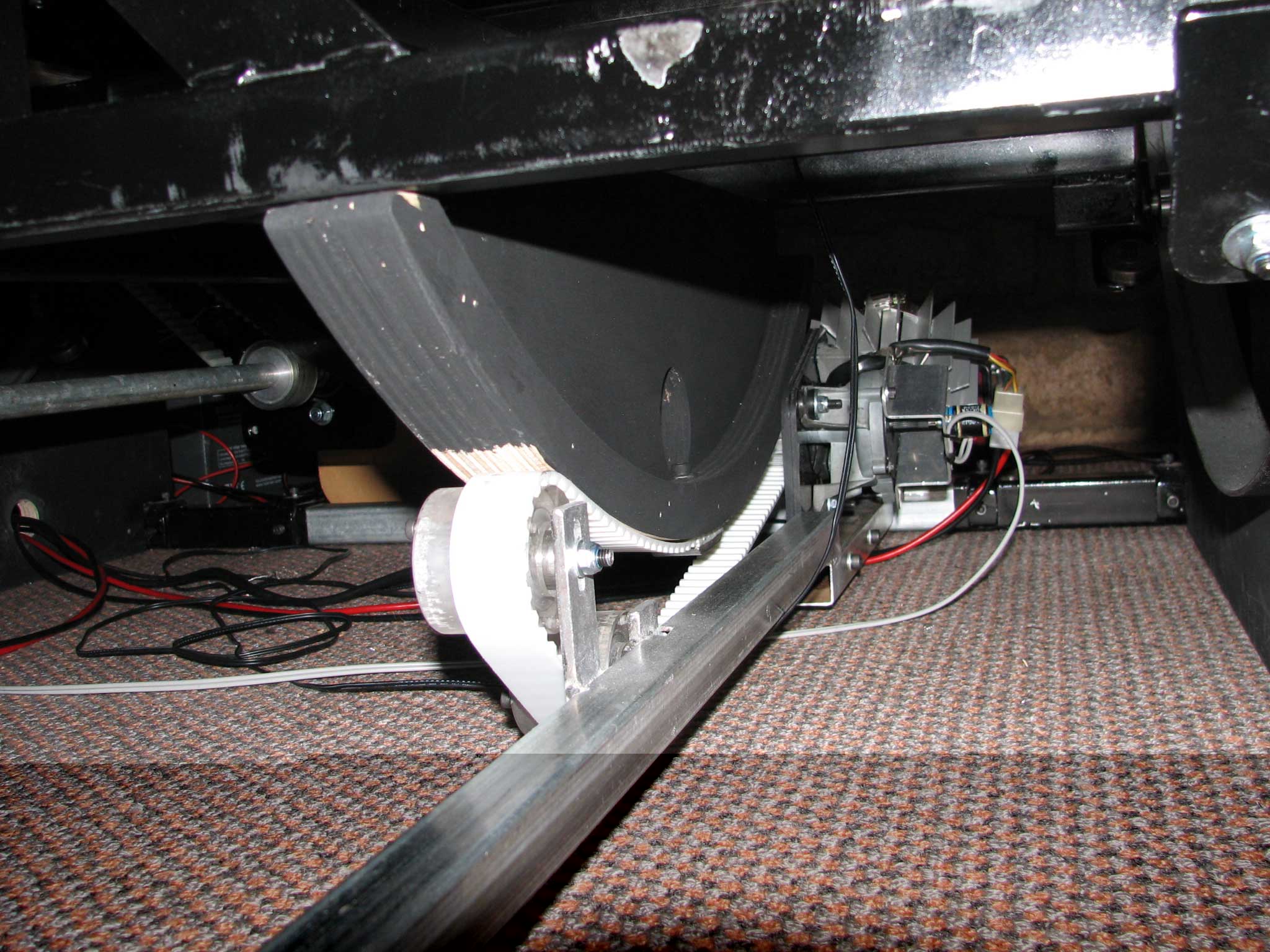

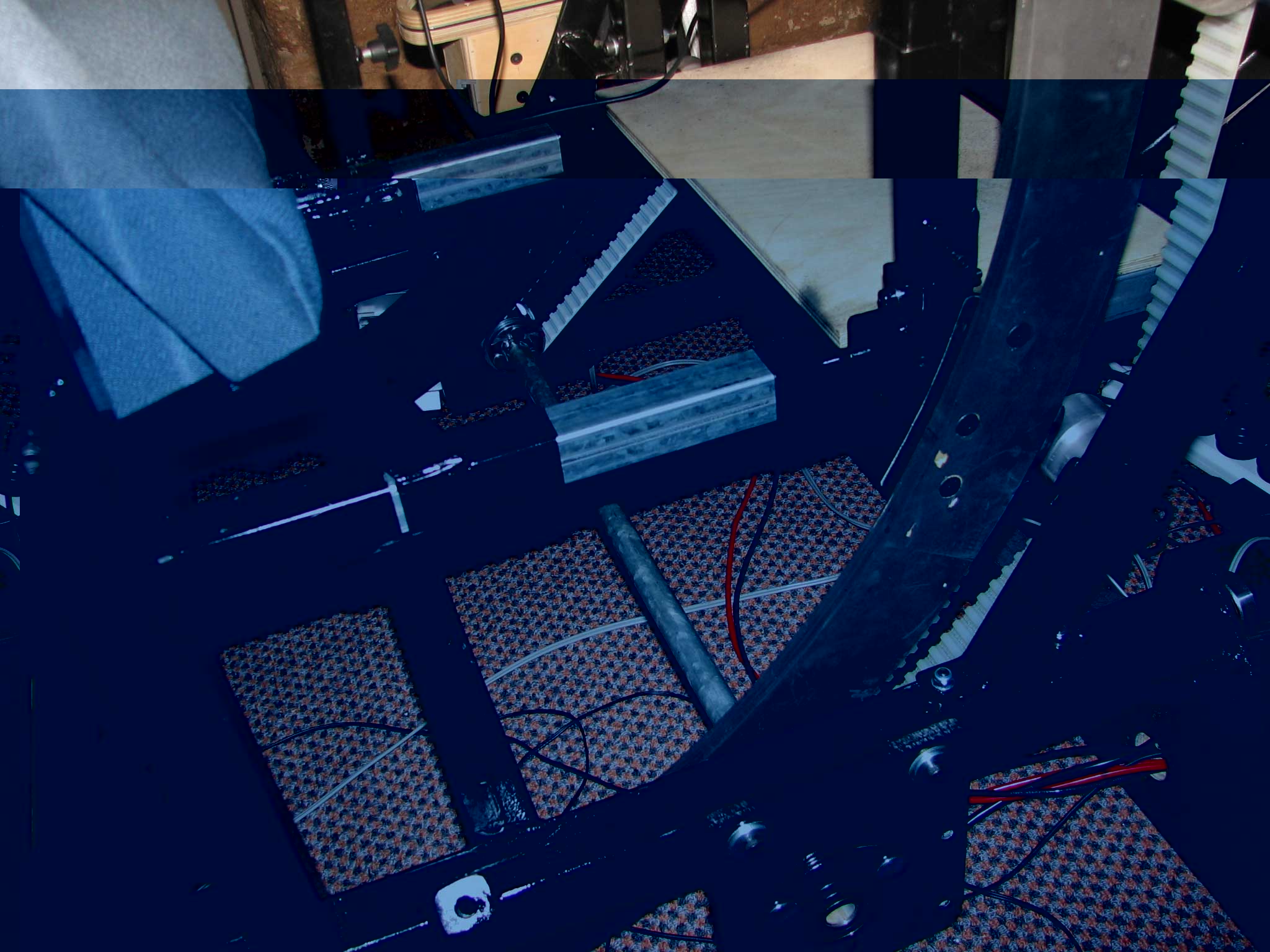

Pitch Axis Motion. This is the final system that I have used. It works very well and has all the backlash removed from the system. The curved belt guide are same radius as the distance from the pivot point and so no slack is introduced when the system is displaced away from the center position.
The wiper motor has a shaft on the output that duplicates the puley/belt system on the other side of the pitch frame. I found this necessary to eliminate and twisting moments when the accelerating of deaccelerating in the pitch motion. ( works really well )
The transverse shaft is supported at the end by a bearing.

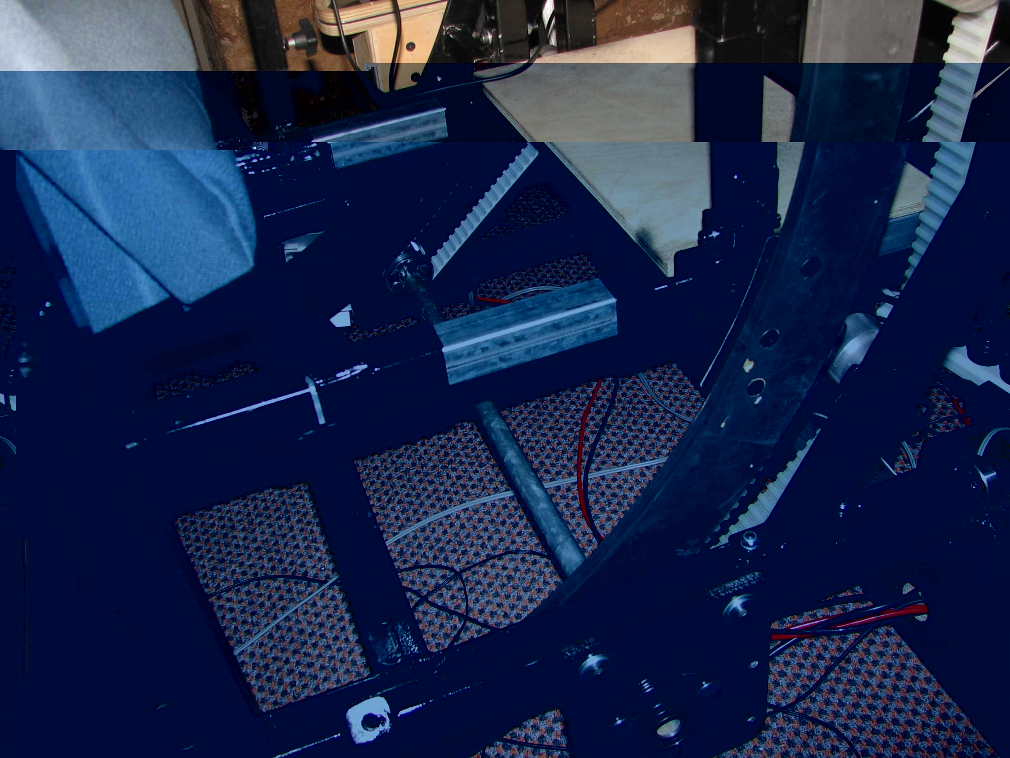

The Roll Axis motion is similar but allot simpler as there are no twisting forces to deal with.
Again, the belt is supported on a guide that is on the same radius from the pivot point. ( missed some paint :o )

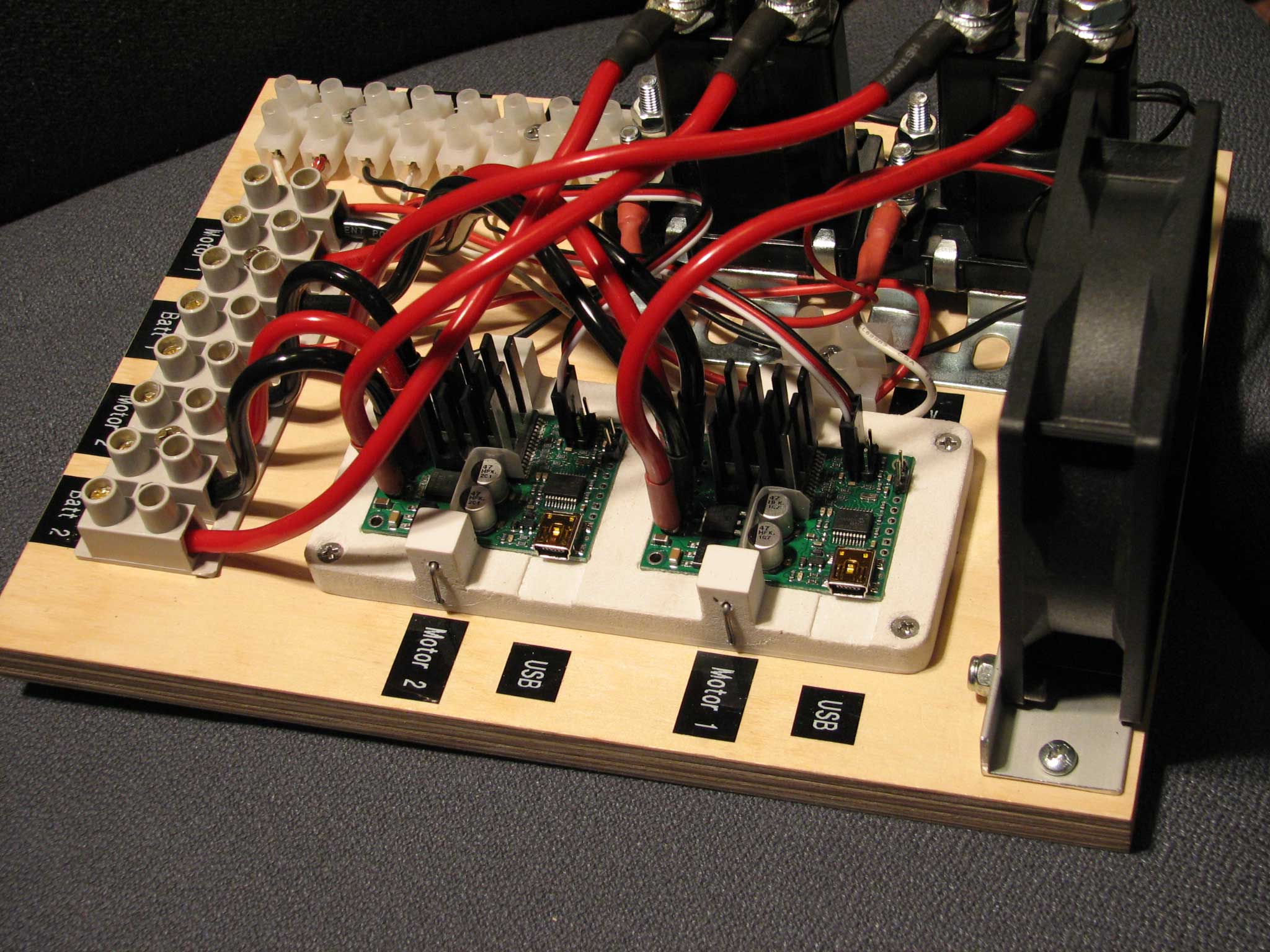

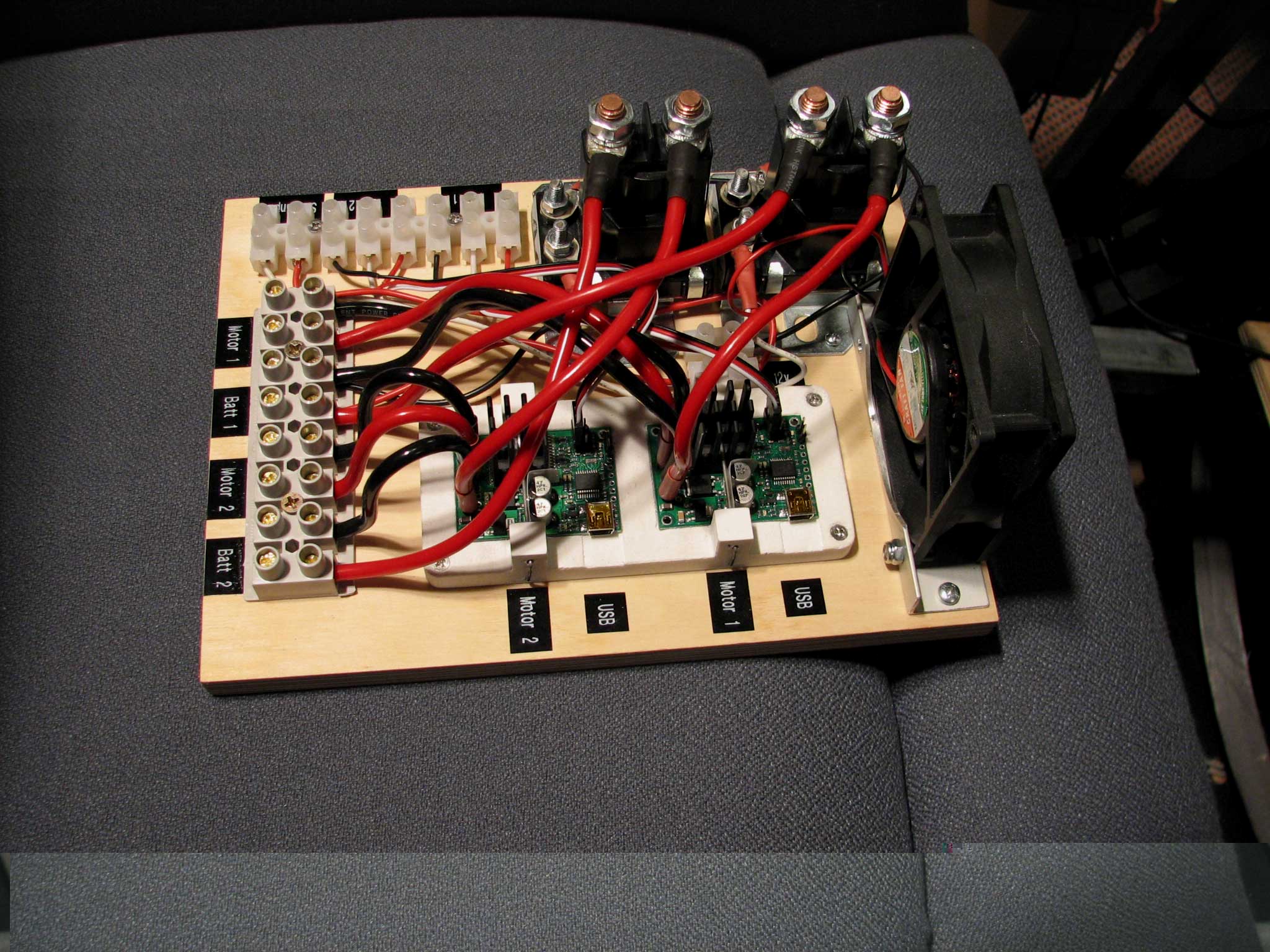

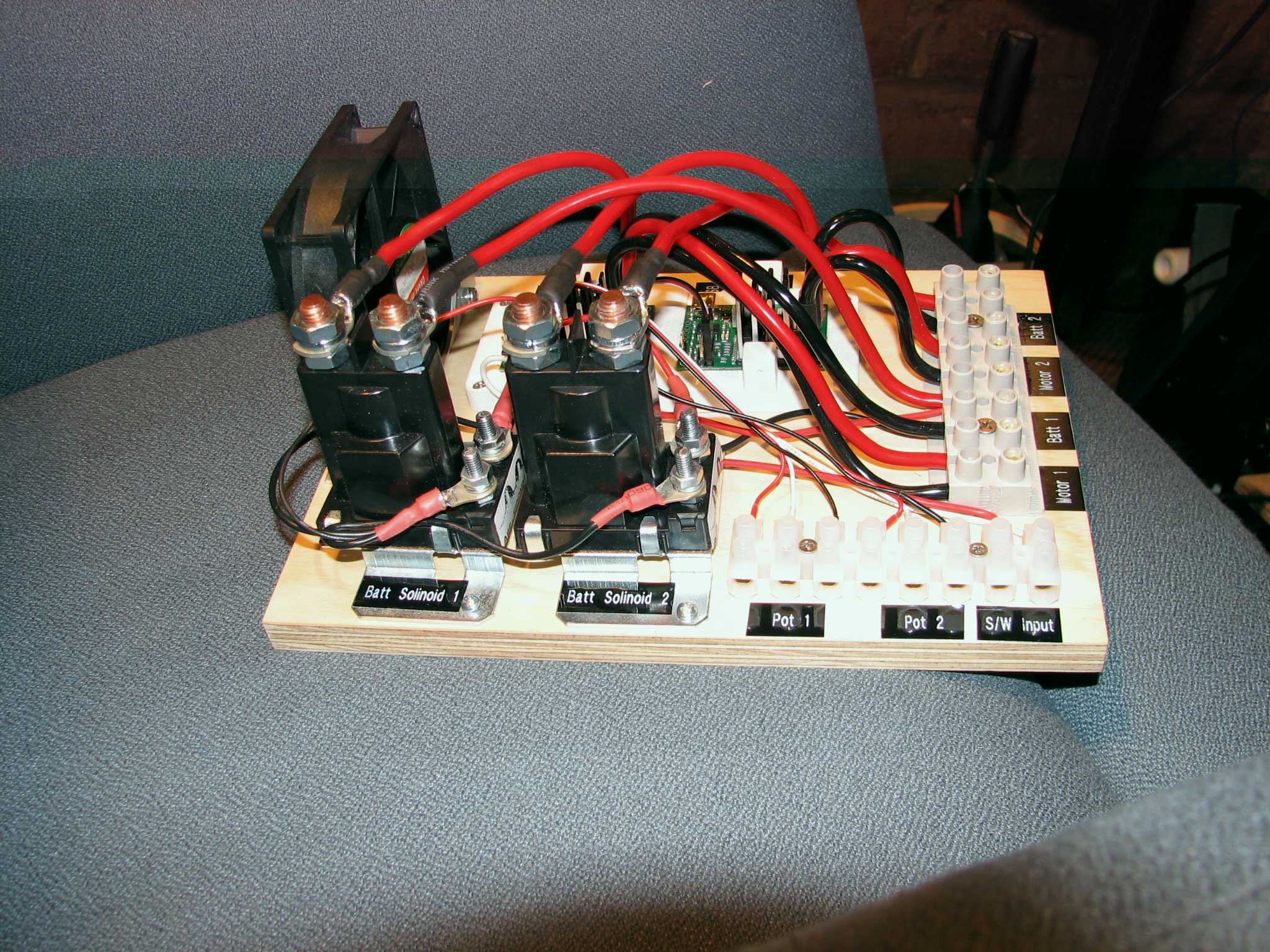

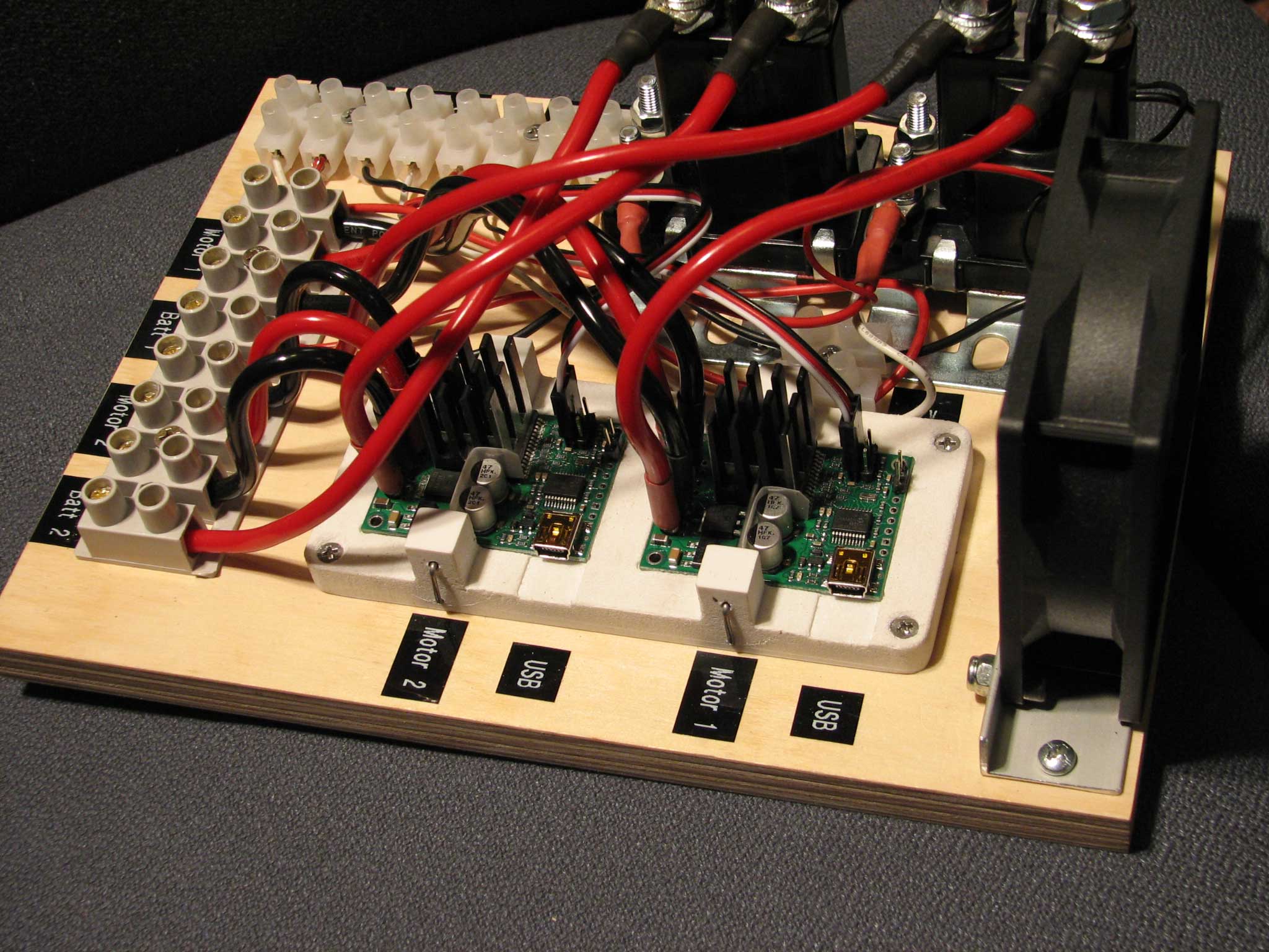

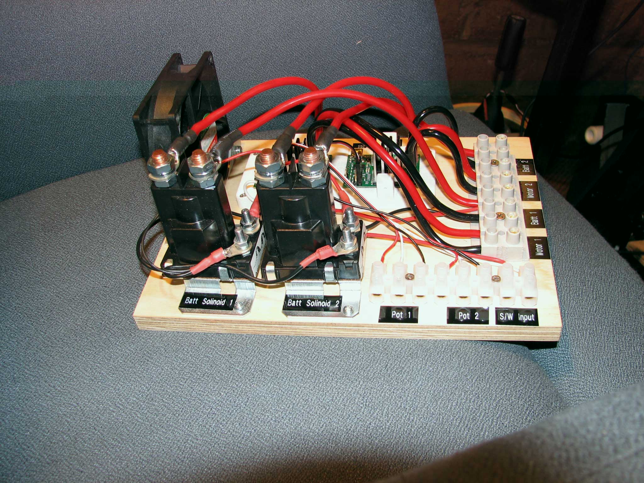

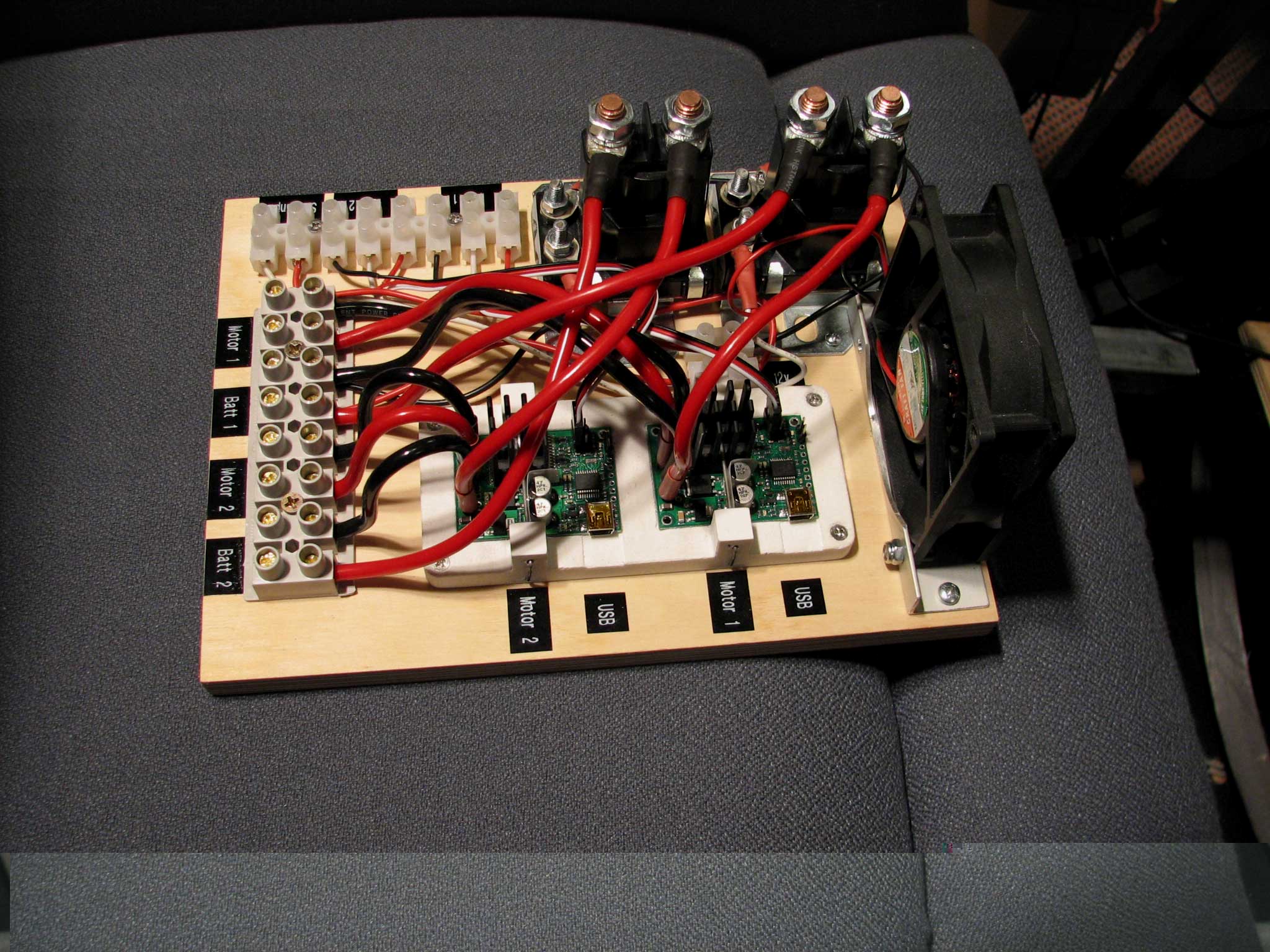

I have used 2 Pololu JRK's. I made a mounting system to hold the boards in place whilst firmly holding heat sinks onto the controller IC's. The boards and heat sinks are held in place by a spring clip/wire. A cooling fan turns on when 12v supply is turned on.
I have fitted 2 of 12v solinoids to switch the 12v Battery supply to the JRK's. The solinoids are controlled by a toggle switch. ie: the Batteries are disconnected from the system by operation of the switch when the sim is not in use. ( I could also wire the switch through a Emergancy Stop button in the future)
