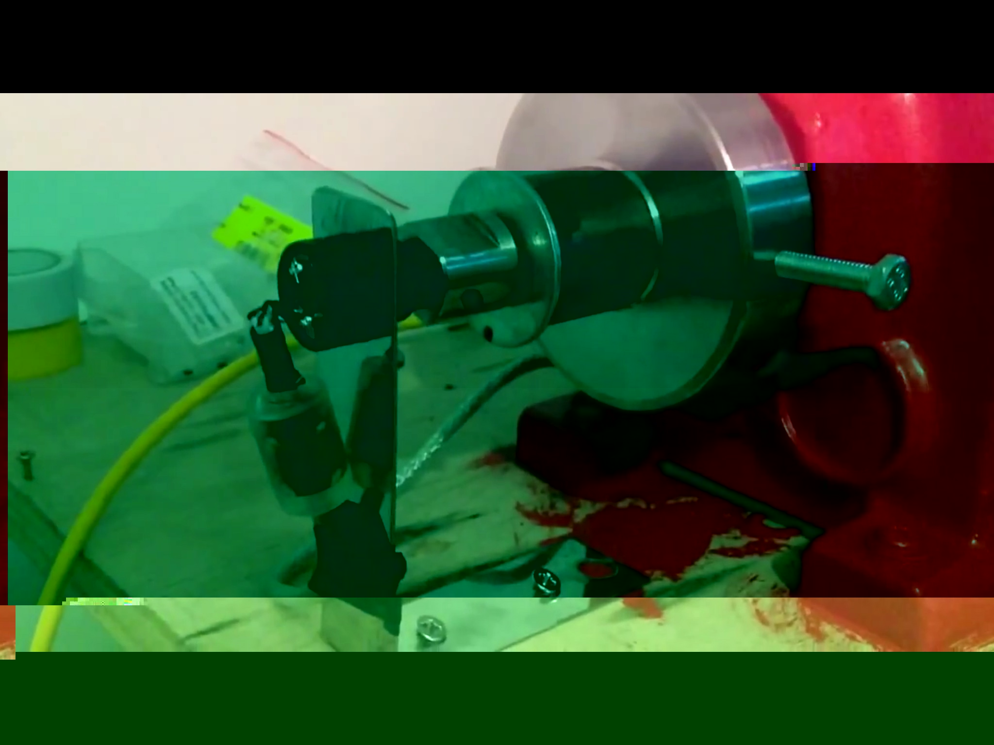

Monaco85 wrote:Do you have technilogy Level for your movitrac's ? Do you use real Encoder for your Motor ?
What do you mean technology level ?
In the the movitrac there is a simple start up procedure , it's quiet easy .With 5 paramaters more that's enough for our need.
No I don't have real encoder , just a sensor position (linear hall sensor) connected directly on the gearbox output shaft.

Sensor
