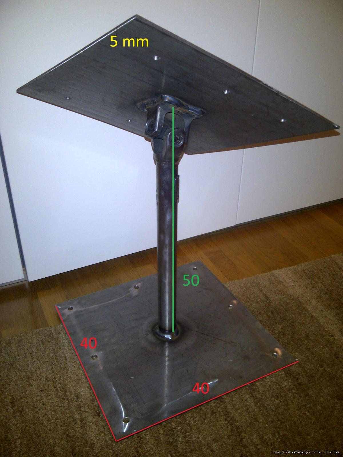

What are the dimensions and thickness of those steel plates you're using (that are soldered to the ujoint)?

the thickness is 5 mm, the dimensions 400x400 mm and are soldered to the ujoint .
i start for dimensions from width of aluminum profile under seat.

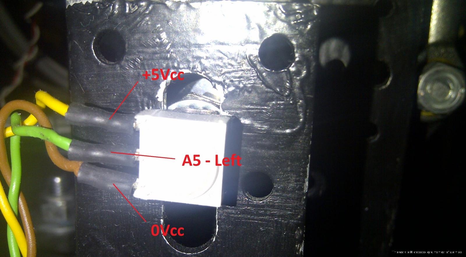

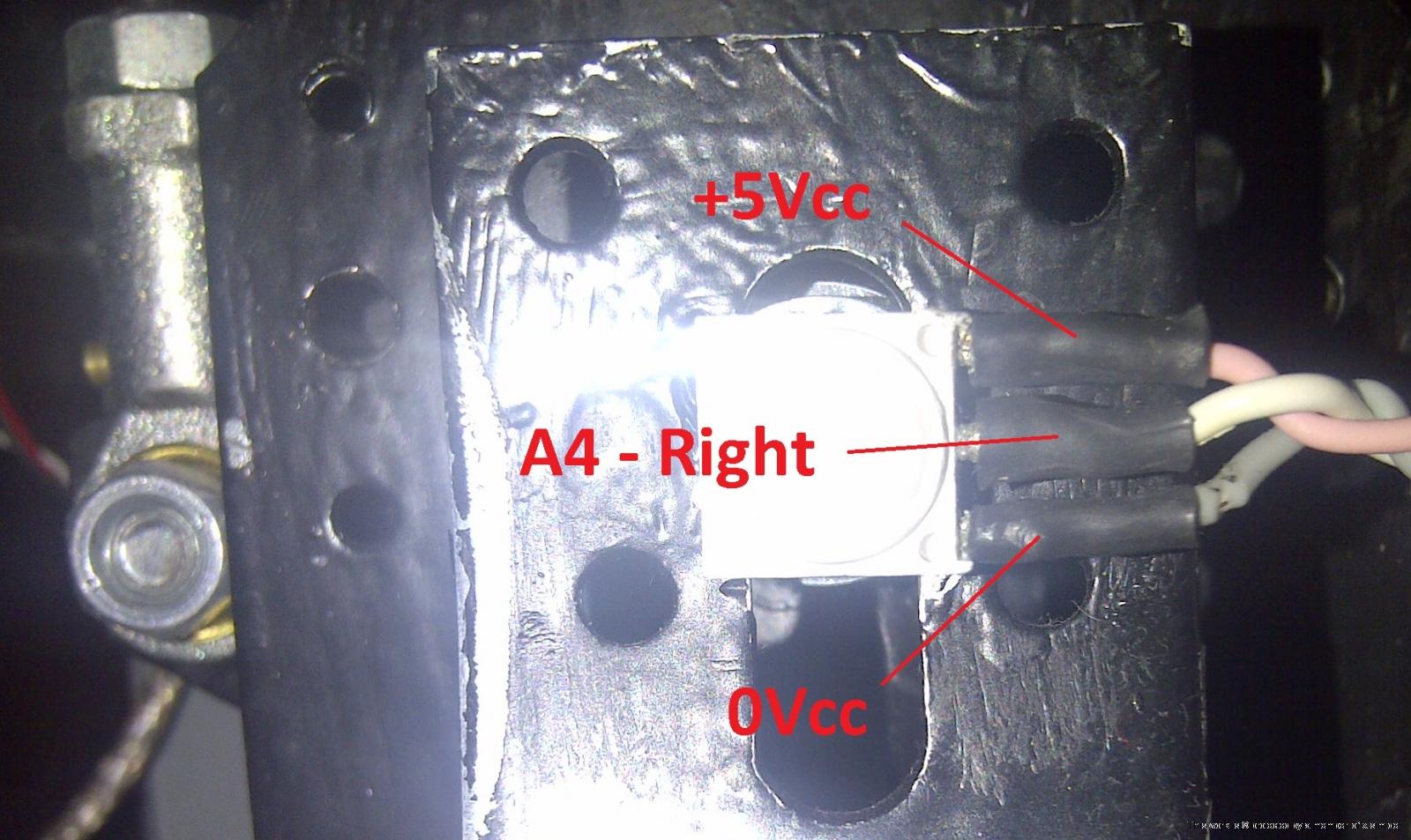

short answer : re-check wire, be sure to have a good +5Vcc for pots and arduino, check motor isolation like reported in post :
viewtopic.php?f=37&t=1103#p9337
detailed answer :
- Arduino UNO R3
- Monster Moto Shield
- if pcbs are not stacked
Arduino .../... Monster
.GND .../... GND pin
...5V .../... 5V
pin 4 .../... pin 4
pin 5 .../... pin 5
pin 6 .../... pin 6
pin 7 .../... pin 7
pin 8 .../... pin 8
pin 9 .../... pin 9
- 12V power supply to monster (+12Vcc to +Monster and 0Vcc to -Monster)
- 2x 10k-100K linear pots (prefer CERMET type) (A5=left, A4 right)
23042303
- for my +5Vcc of pots have connect +5V on monster/arduino connected only via USB to pc; in some posts you can read to prefer attach to different power
- check wiper motor isolation (viewtopic.php?f=37&t=1103#p9337)
- Left Motor power attached in A1-B1 of Monster
- Right Motor power attached in A2-B2 of Monster
- my arduino code from first post or from racingmat project
- attach USB of Arduino to PC
- move about centre/middle position motors and pots (i have +2.5V on middle pin)
- power on 12V power supply
- now motor move/stay in middle position
- can test with arduino serial monitor
I'm available for extra help. regards.
