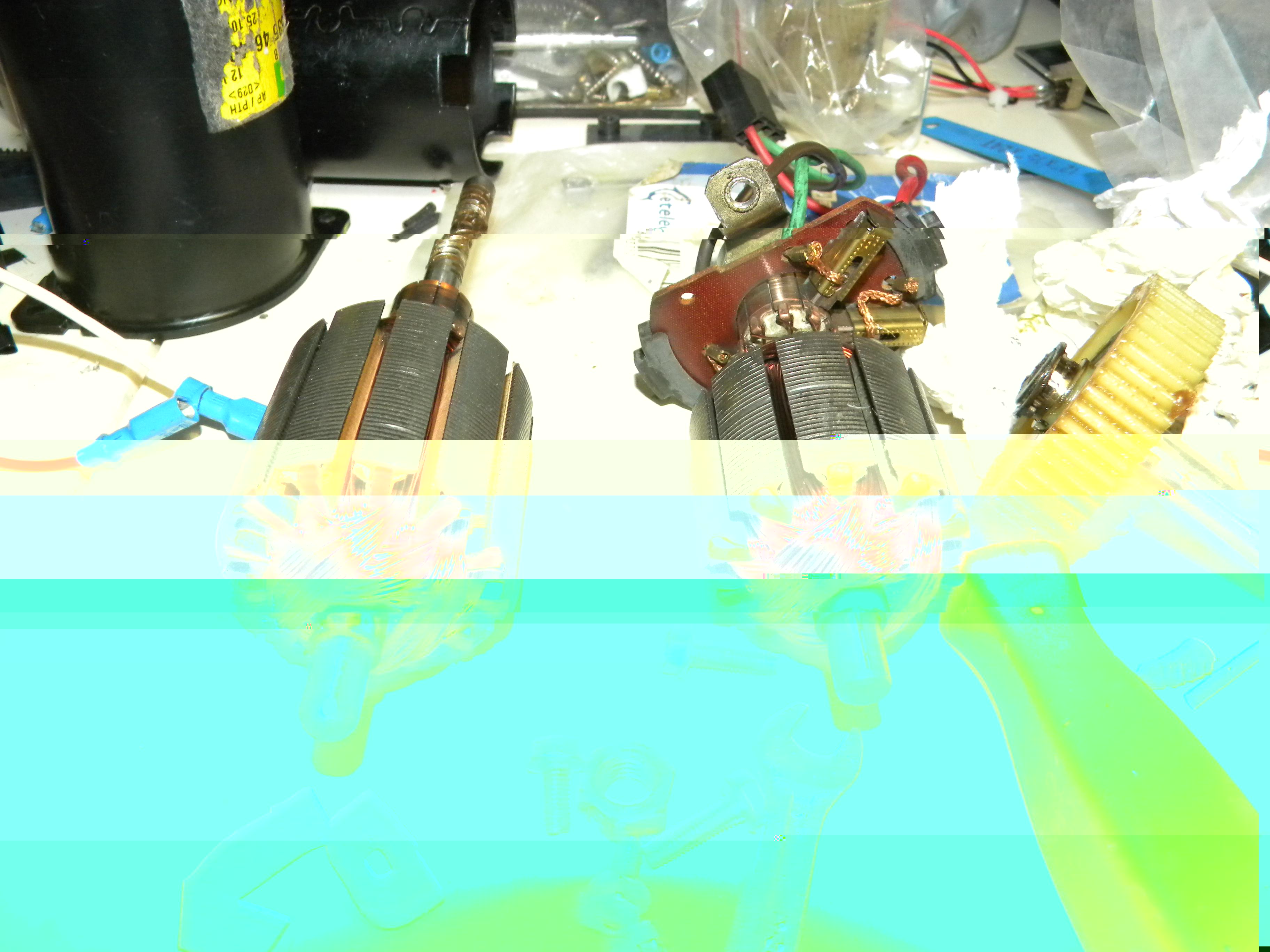

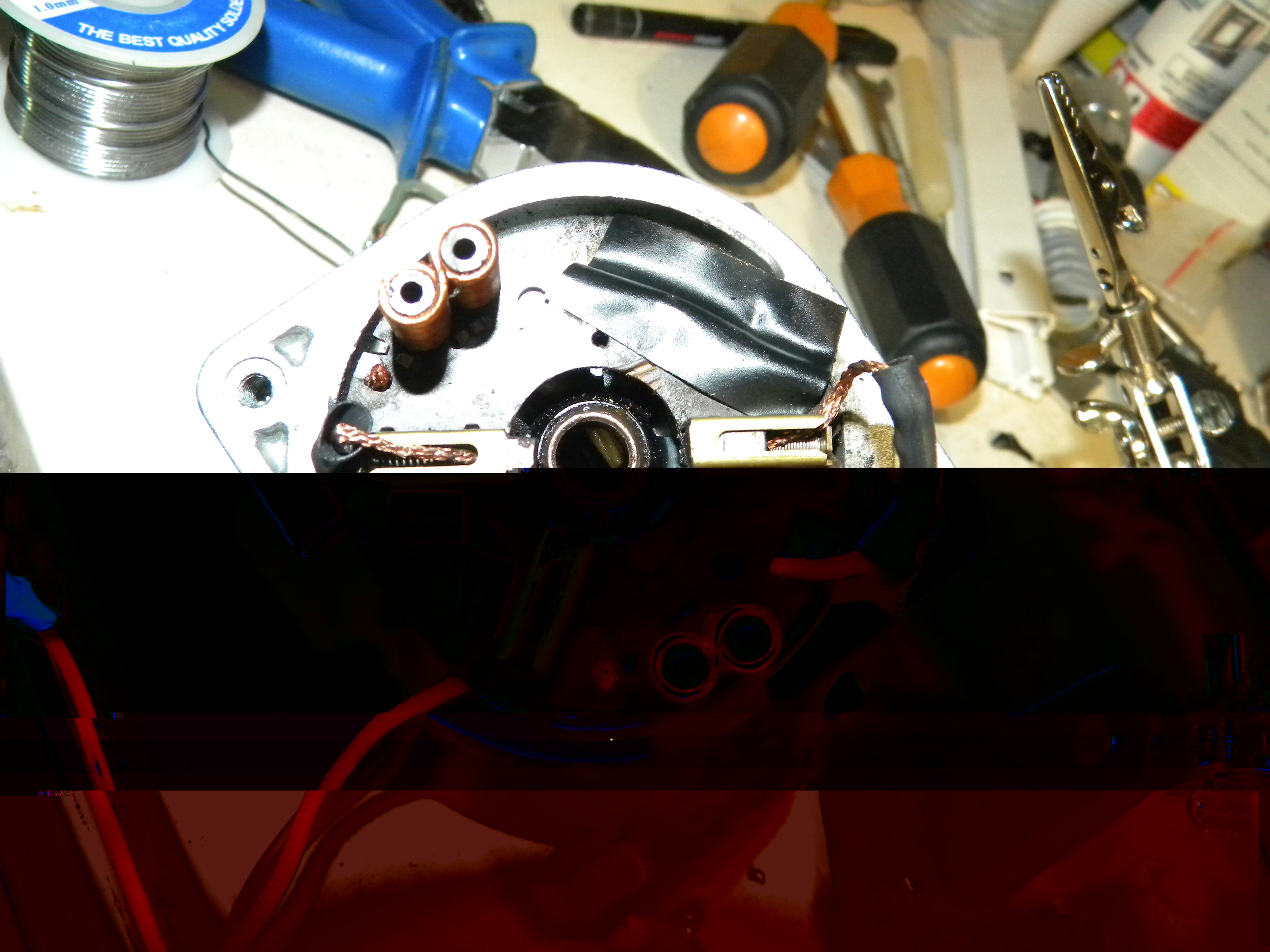

Postby micma80 » Sat 18. Jan 2014, 19:10
hi all,
new engine, I replaced the old that is broken. I modified the wiper motor, removing the ground connection, connected to the brushes you need and reassembled the whole thing (ps if you happen excludes inductors and the rest, directly connected to the brushes, because the power is PWM)
old and new engine, the newest and largest (VALEO 579151 - 1993 to 2002 peugeot 306)
change brushes, no grounding
engine ready
installed
regards

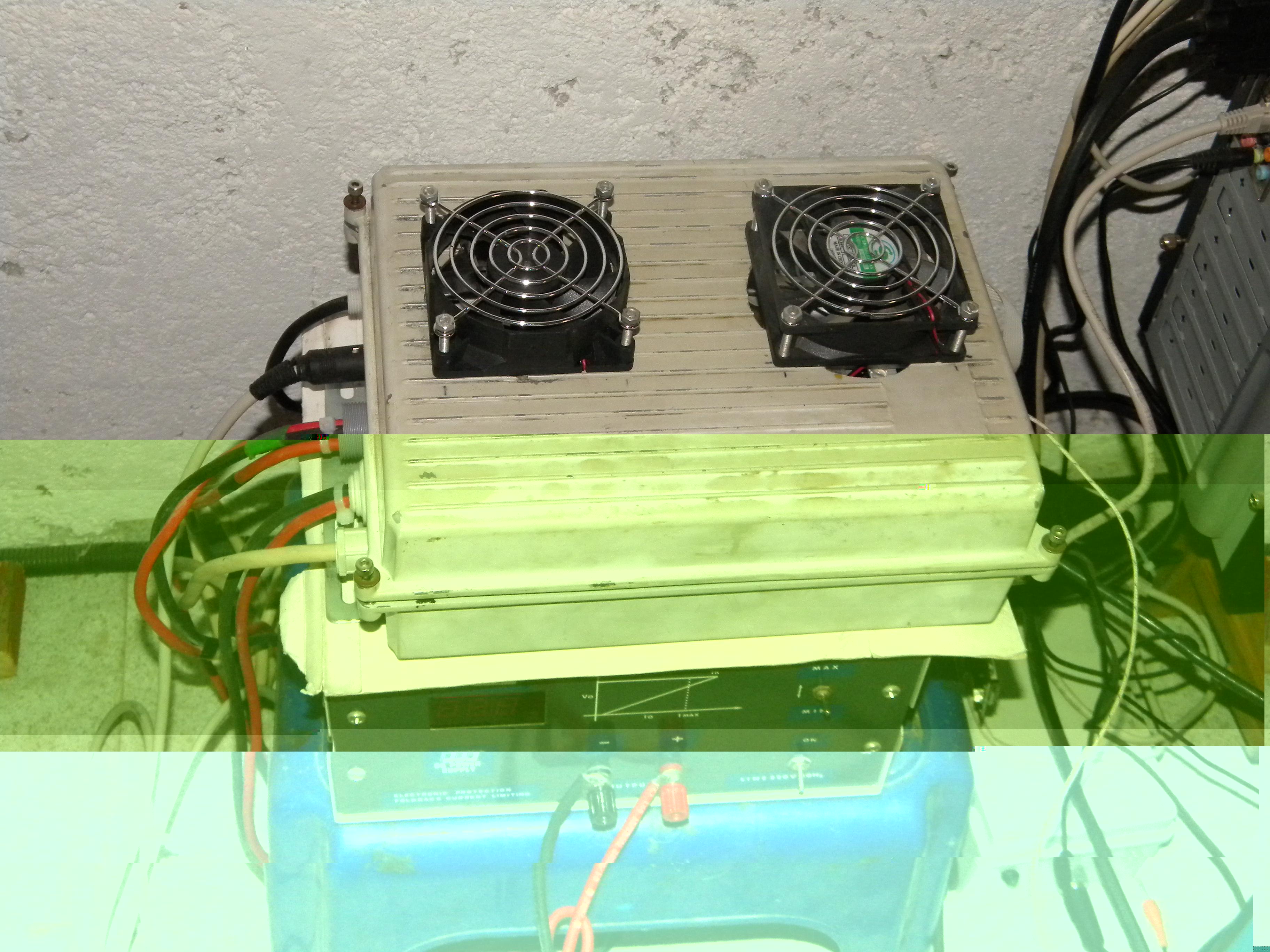

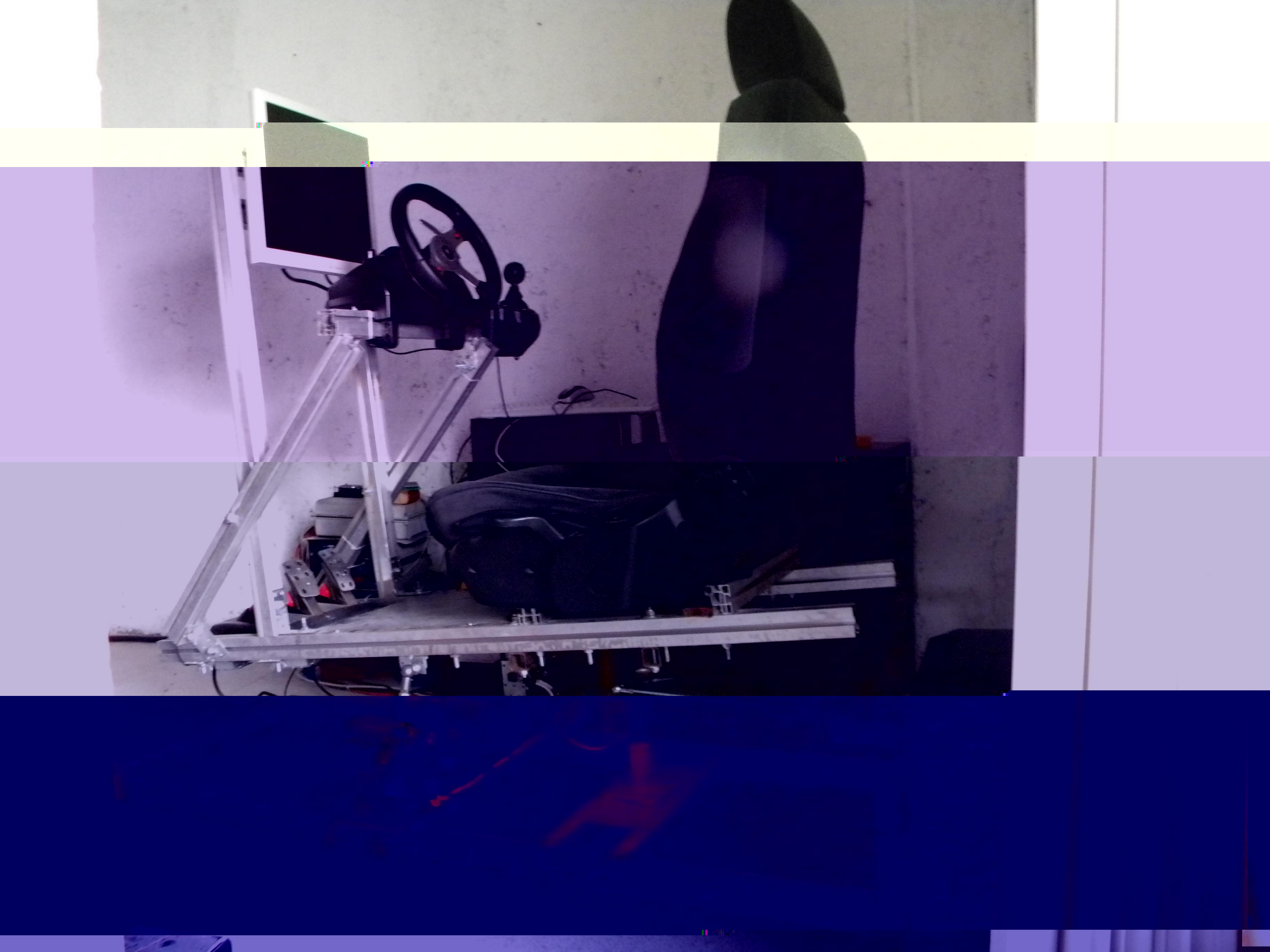

new look & AMC DSMhb boxed ... SIM again ready to run.
box AMC+DSMhb
box inside
SIM go go go
