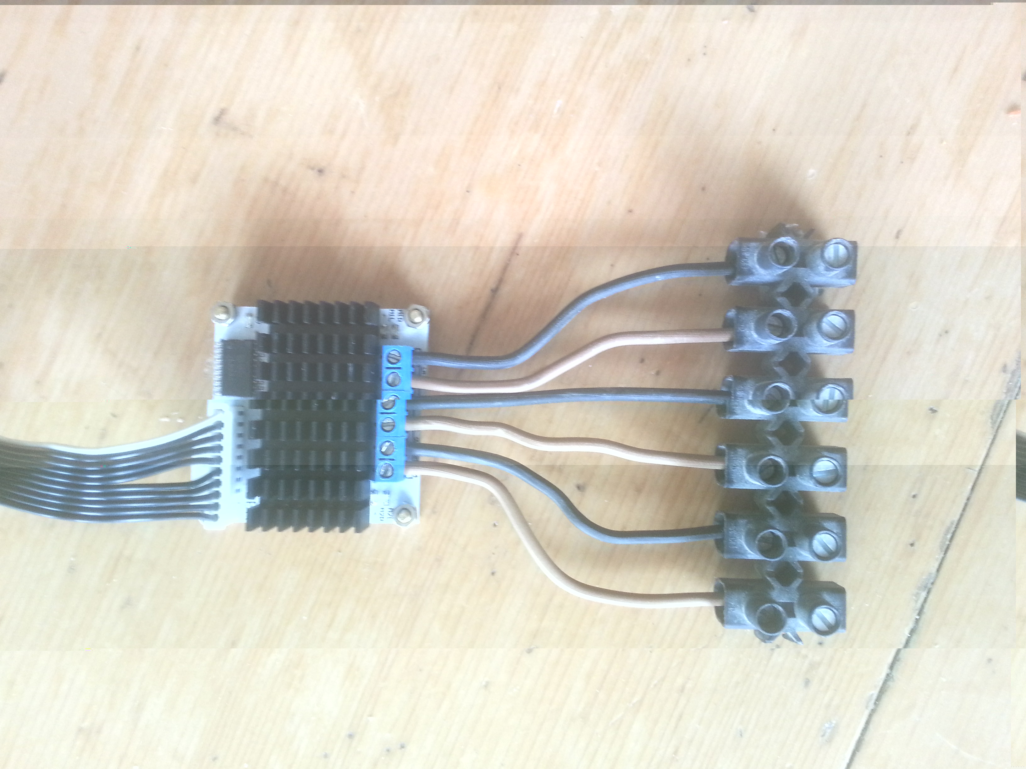

my motors have 24v and 180Watt
I change because i want using pwm and the solution Vellemann and Sabertooth is not so good.
Is it posibble to connect the sabertooth to the Arduino??

Dimension Engineering now have an add on controller board for the sabertooth called the Kangaroox2
and an x-sim plugin is available, I am bench testing a setup at the moment. Kangaroox2/Sabertooth 2x60
I think the code on the Arduino would have to be modified to run the sabertooth.
The H bridge you have has connectors that are not able to carry the rated current (to small)
the clue is that your motor wire wont fit the connection.
regards Terry

Postby menix » Sun 15. Sep 2013, 12:39
i solved my connection Problem.
I hope this is good

Postby menix » Mon 16. Sep 2013, 06:33
Unfortunenatly my H-Bridge burned down.
i dont know why but my Arduino sunnenly lost connection to pc, motor stand still and smoke comes out from the H-Bridge.
So i have now use my Sabertooth till i get new H-Bridge.
Anybody has tried the Arduino with Sabertooth??
