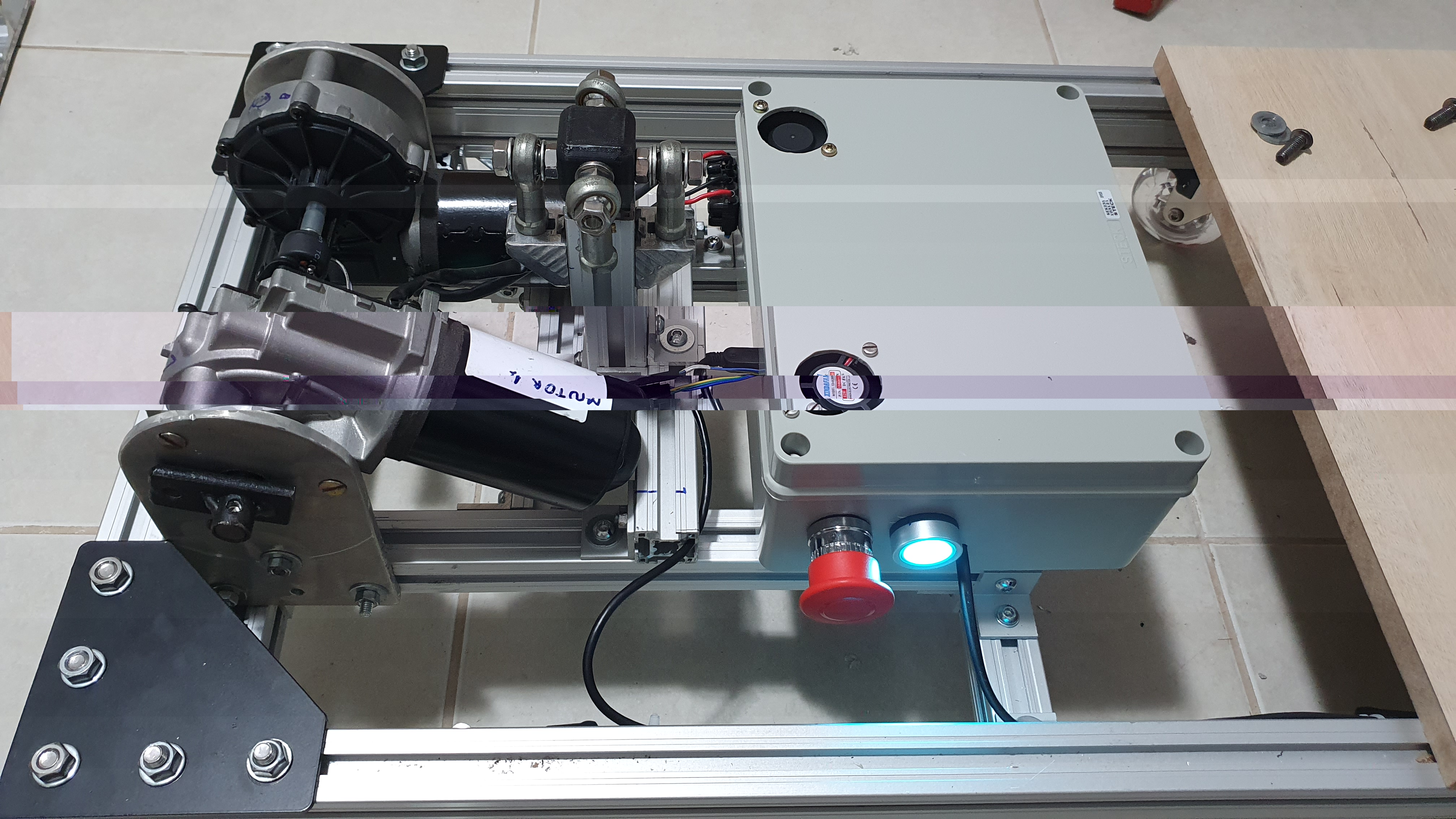

Dear All,
Today I do some mods on my Rig.
Change the Joint for more strong:
Install All Eletronics on a plastic box, with coolers, Emergency button and "power light":
