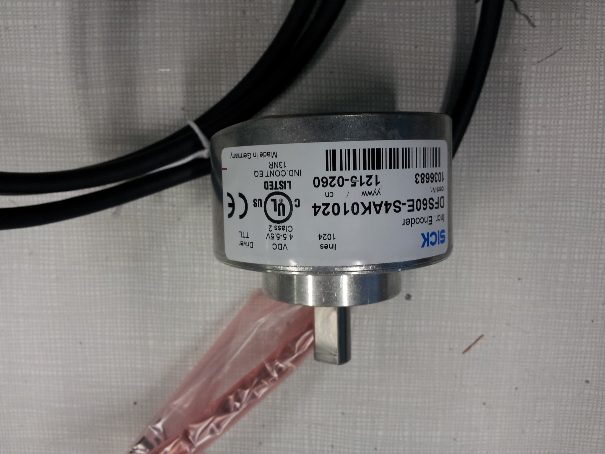

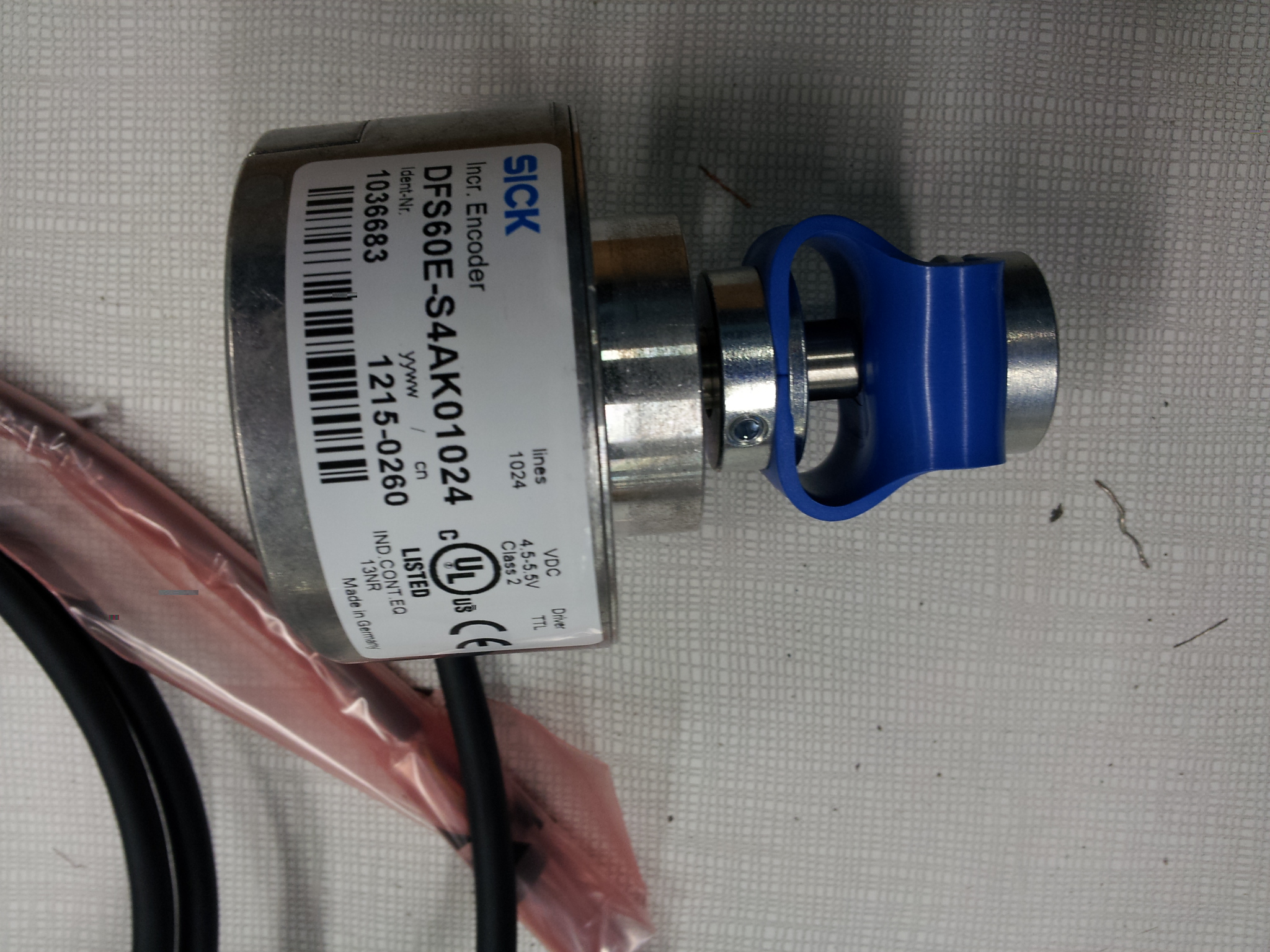

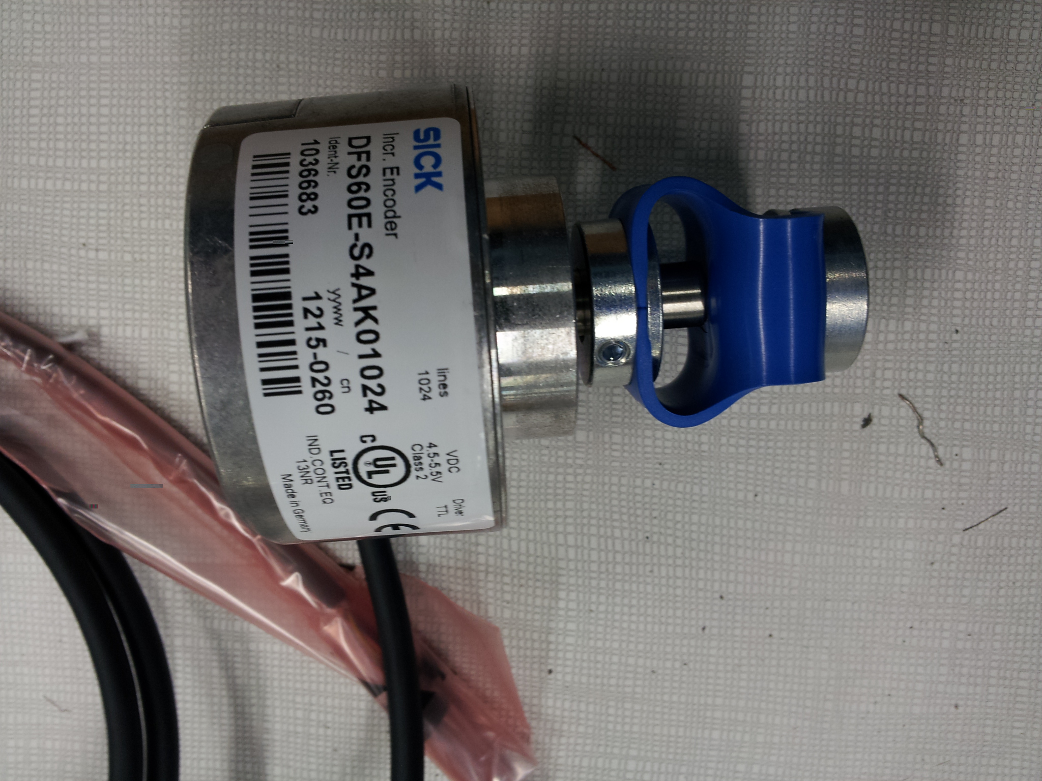

Hello everybody,
Quick update about the encoders. These are two industrial Sick incremental rotary encoders (including couplings) with following signals:
- 1024 pulses per revolution
- A, B and Z signal
- 5V pulses
- more information can be found in de datasheet I included
- price: 109 euro's a piece
With the right encodermodule you can get 4084 positions per revolution. For our simulator this means that we can measure the position of the platform up to 0,0225 degrees accurately. I hope the students can finish their holders soon en couple them to the motors. Once there we can start testing the movement of the motors.
In the meanwhile the woodshop has started sawing al the pieces for the cockpit that will be mounted on the platform.
Greetings,
Bart
online_data_sheet_DFS60E-S4EK01024_en_20120924_1433.pdf
(555.35 KiB) Downloaded 1110 times

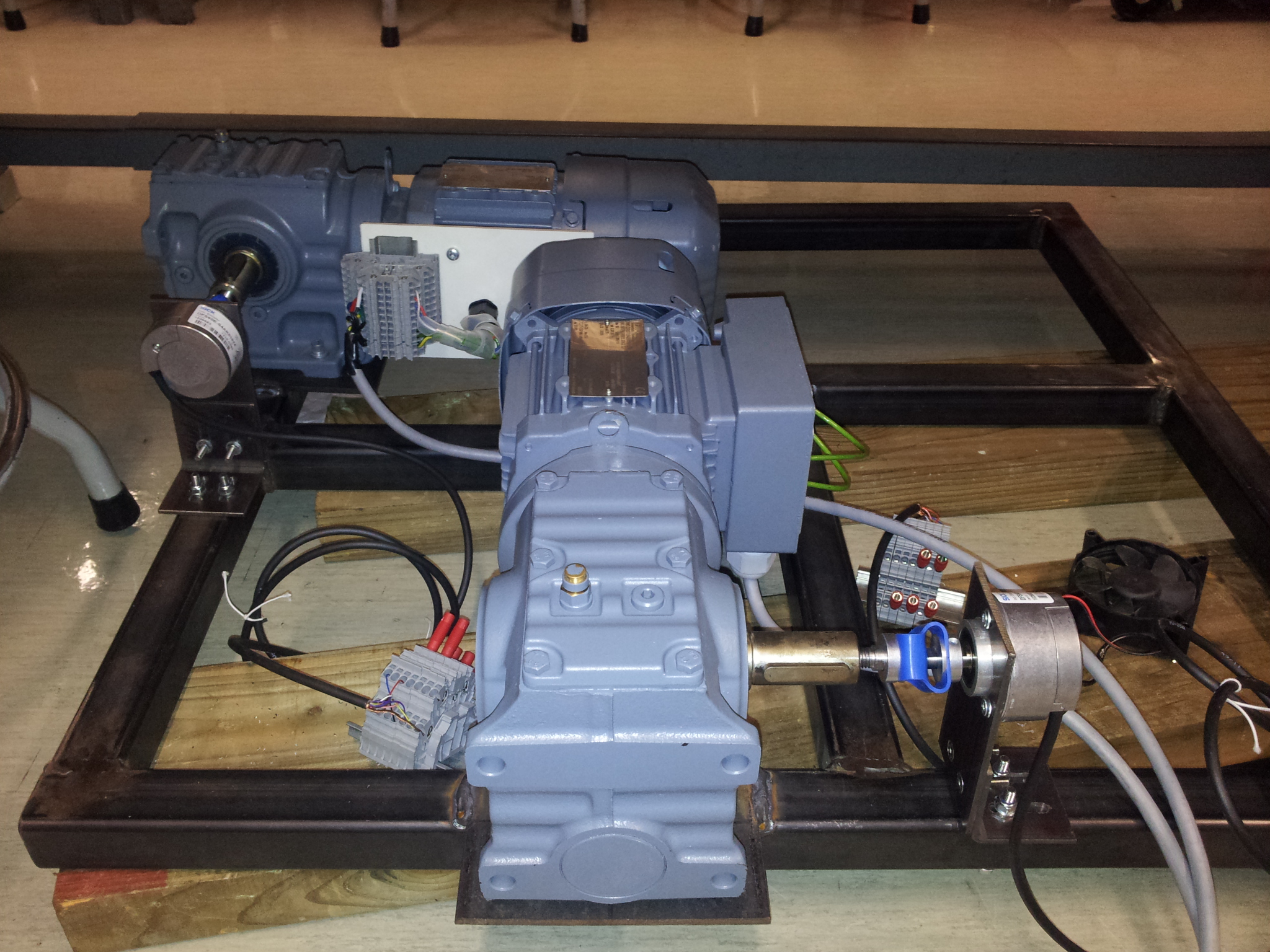

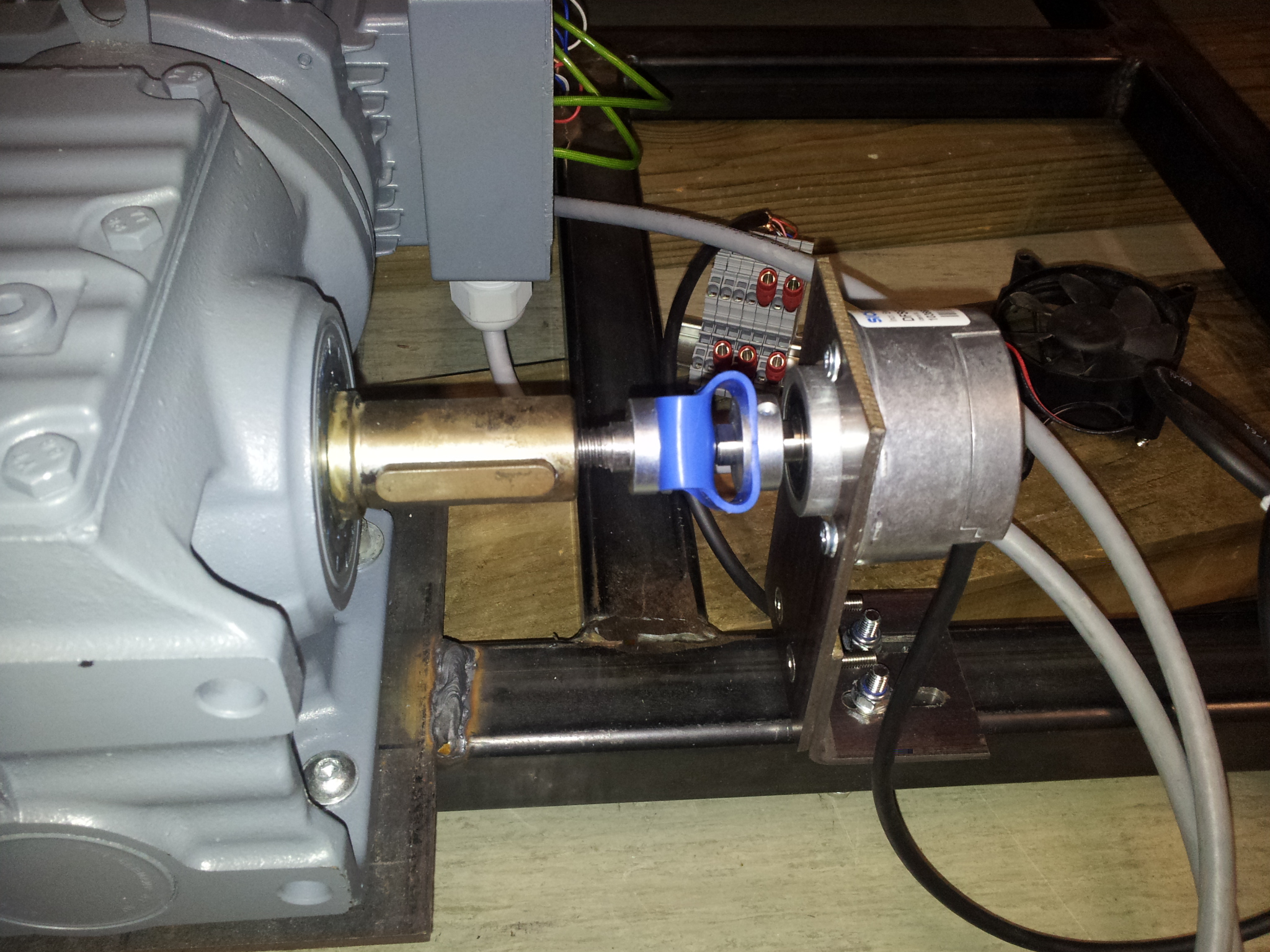

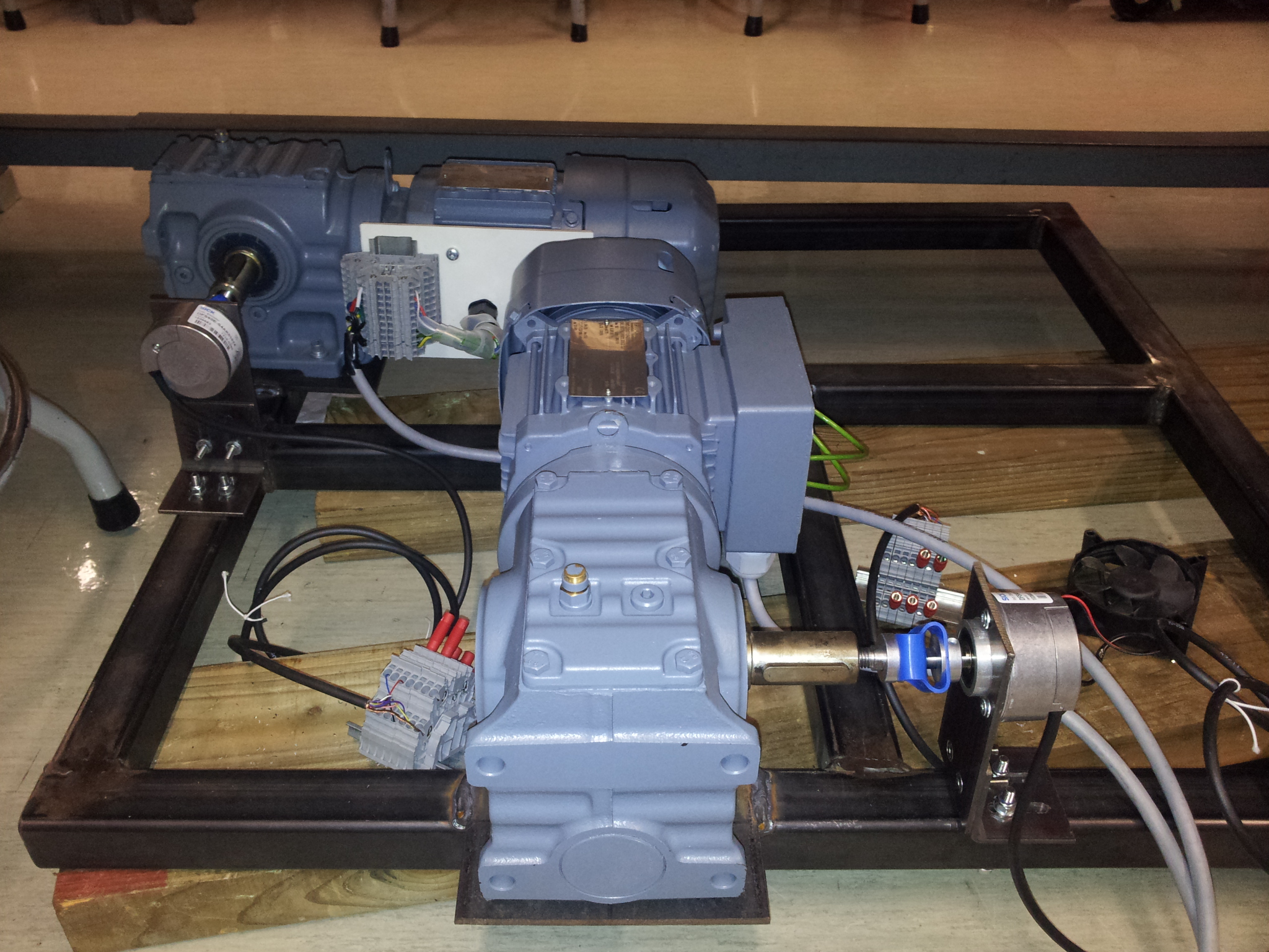

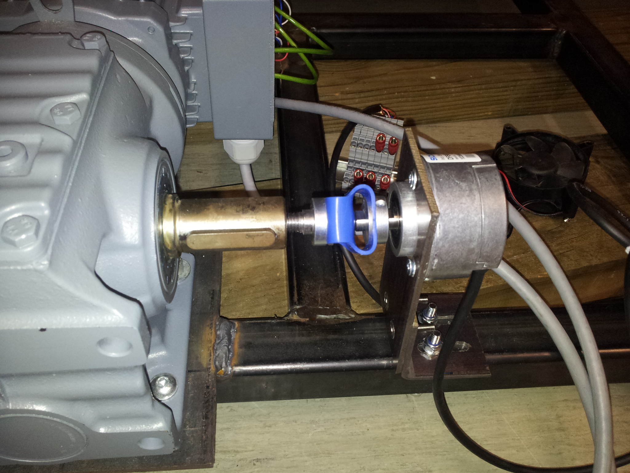

Postby Mertensbart20 » Sun 20. Jan 2013, 00:31
Hello everybody,
It has taken a while but we (the students) finally made good progress. We coupled the encoders onto the motors as can be seen in the picture.
Now testing can begin. Plans are to have a working simulator by the beginning of march. I will keep progress up to date.
Greetings,
Bart

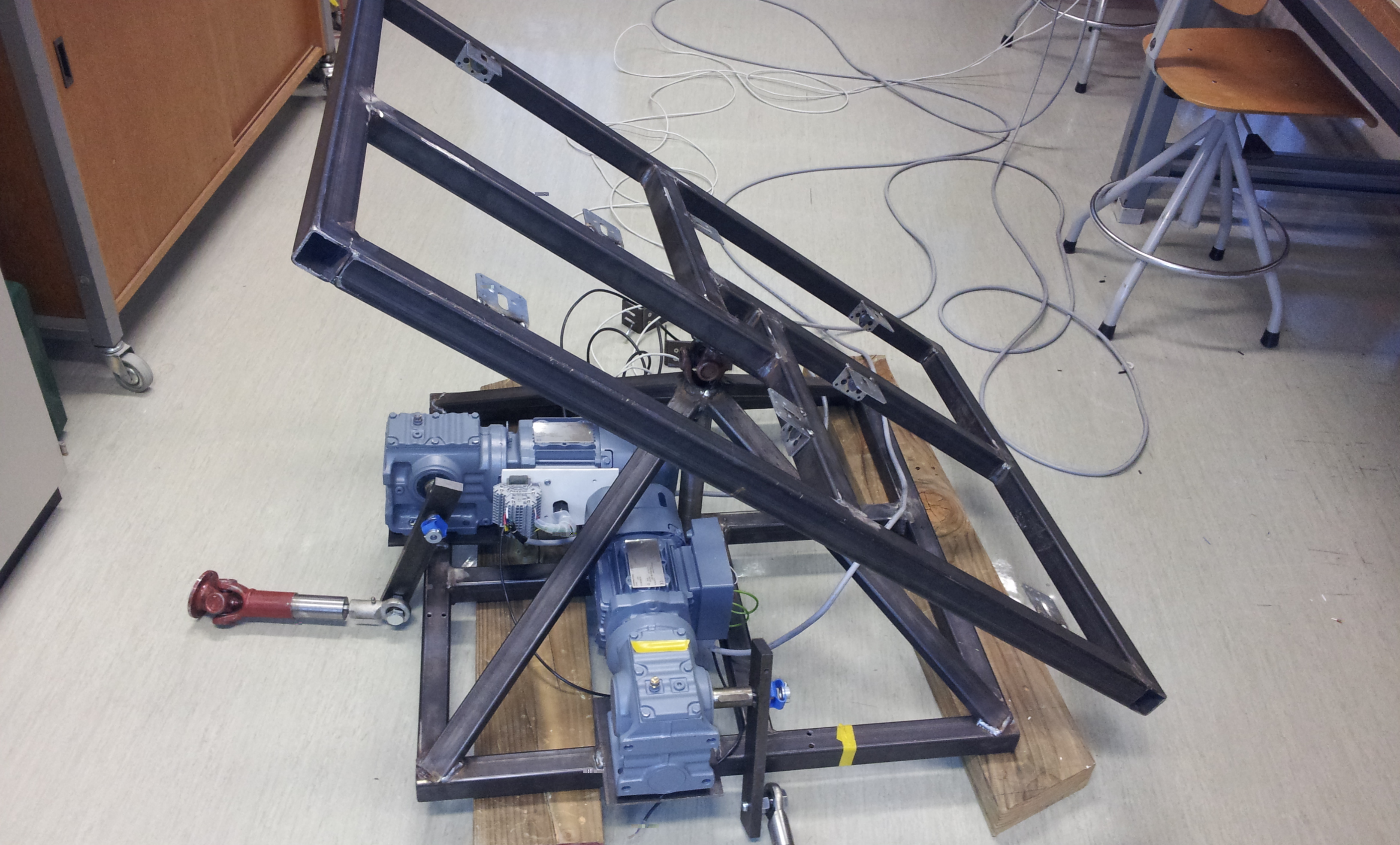

Postby Mertensbart20 » Fri 8. Feb 2013, 21:38
Hello everybody,
We have made some steps forward. The cockpit has been build (you can see some pictures below). Paintjob will be done soon.
The mechanical structure is almost finished. I also included some pictures. First tests should start within three weeks.
Greetings,
Bart
mechanical structure picture 1
mechanical structure picture 2
mechanical structure picture 3
cockpit picture 1
cockpit picture 2
cockpit picture 3

Re: 2DOF simulator based on CKAS Thruxim
Postby vicpopo » Fri 8. Feb 2013, 22:20
Hi,
It looks really like CKAS 2DOF.Same frame , same motor manufacterer...
Impatient to watch it in motion.
Postby Riton » Fri 8. Feb 2013, 22:52
what will happen if there is a bug with electronics?
If the motor running without stopping?
I think it's dangerous, you may break the encoder and the cams if they tap against the structure.
But, it's a good simulator, nice motors , and nice frame! ;)
Riton
Posts: 291
Images: 70
Location: France
Been thanked: 16 times
Postby Mertensbart20 » Sat 9. Feb 2013, 09:26
Hello Riton,
Good remarks and ofcourse we have taken this in consideration. The simulator is protected by the invertors in two ways:
1. Should the motors overheat a thermal safety will open in the motor which will interrupt a signal to the invertors. The invertors are programmed to stop the motors once this signal has been interrupted.
2. Should the motorarms move beyond the extreme points the motorarms will hit a positionswitch (these are not installed yet). This positionswitch will interrupt another signal to the invertor. And again the invertor will stop the motor once the signal is interrupted.
The safeties above will also work when there aoccurs a cable-break.
The design looks a like the Thruxim but our motors are bigger because we want to have a pitch- and rollangle of 18°. But I don't think they use wormgearmotors for the Thruxim. I think they use a motor with an axial reduction which is better for the lifetime of the motor and the energy efficiency. But these type of motors are far more expensive. And SEW assured us the motors will last a lifetime since it is a simulator for private use. And energy efficiency is not really a big deal for a device that will be used maybe half an our each day.
At this moment anothers student has started working on adding a yaw-axis by placing the whole simulator on rotating point directly driven by a motor. But since it is a schoolproject it will take about a year to finish :-) .
Greetings,
Bart

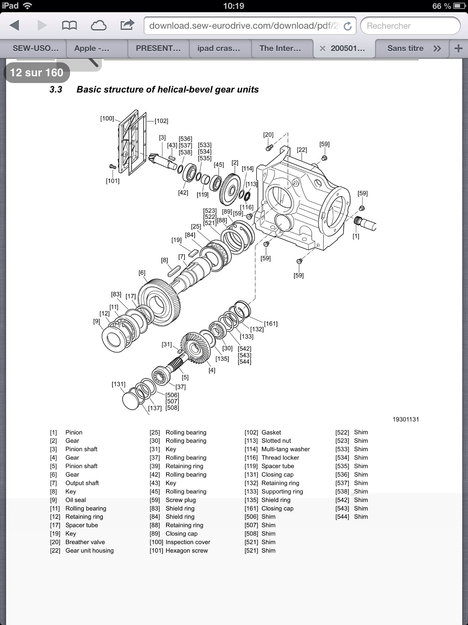

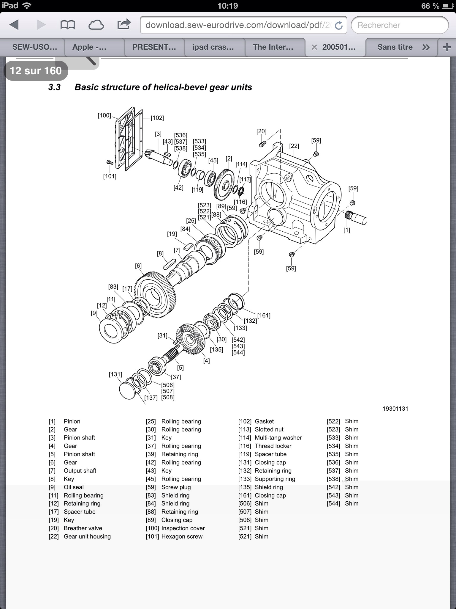

Postby vicpopo » Sat 9. Feb 2013, 10:14
Hi ,
Yes you're right for the Thruxim that is helical gear box type R27 or R37 .
But with Ckas new 6 dof plateform " low cost " there are not the same gearbox as you that is helical-bevel gearbox unit.
When you look at the technical specification for the same power wanted (0,25 kW for example) with the the same gear ratio ( output shaft gearbox 12rpm) you've got the same amazing torque (between 150 and 180 Nm).
The efficiency is a little better with helical gear units but the torque is the same.
The big advantage for the helical bevel is the space you can win with the output shaft at 90° to the motor shaft.the design is compact and all the motors are under the plateform, nothing go outside from the lift plateform ( security advantage also).
And the last advantage is that the use a hollow shaft.One side there is the arm to lift the plateform and the other side you find the angle encoder .This solution is compact (room saved) and 100 % safe for the encoder.
Edit : I don't really saw your gearbox is it a helical bevel gearunit or helical-worm gear units?
Seems to be helical worm gear units.
The helical worm gear unit is possible also but with less efficiency.

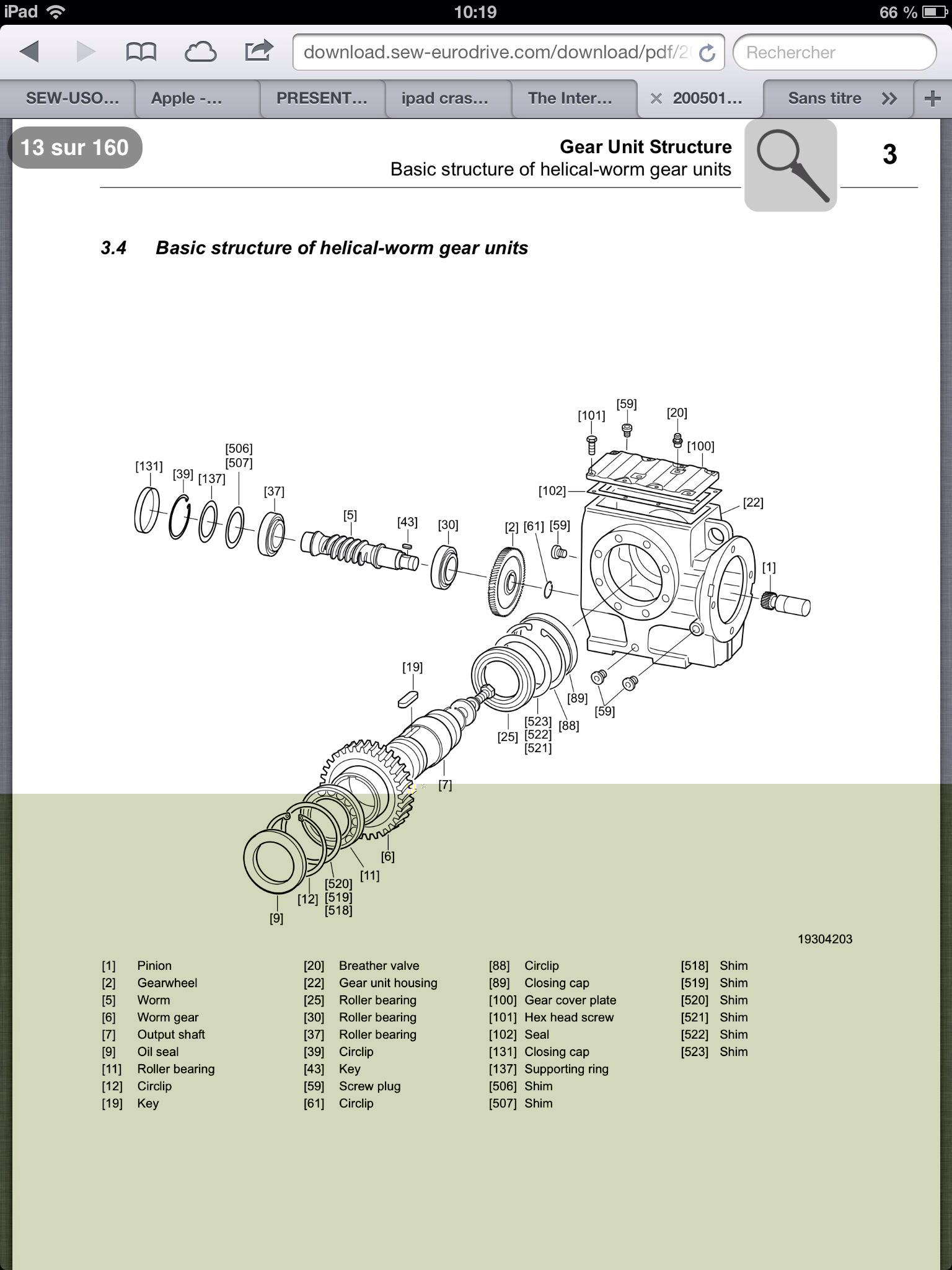

Edit :
Helical gear units
Helical
Helical bevel
Helical bevel
Helical worm
Helical worm
