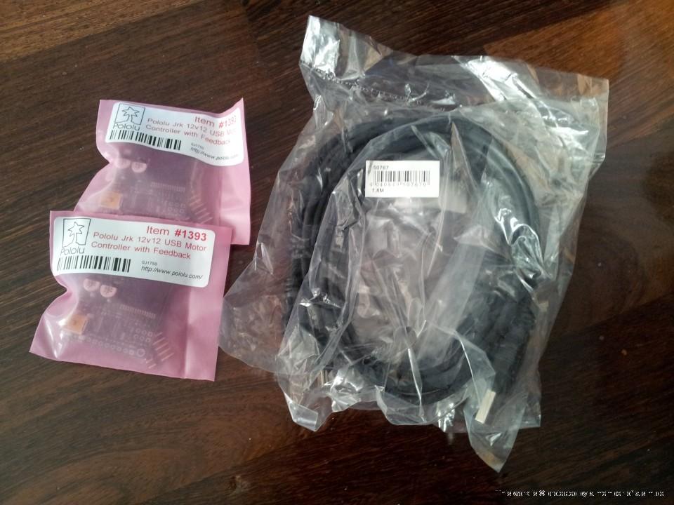

I did a lot of work the past week(s) on the race simulator. Also all the parts are arrived!
I found some cheap, but good speakers and the Pololu's where arrived
313
314
All the pins are solderd after waching tutorials at Youtube :?

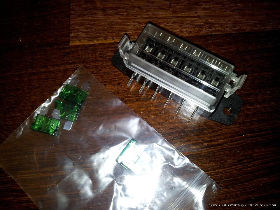

Fusebox with 30A fuses:
315

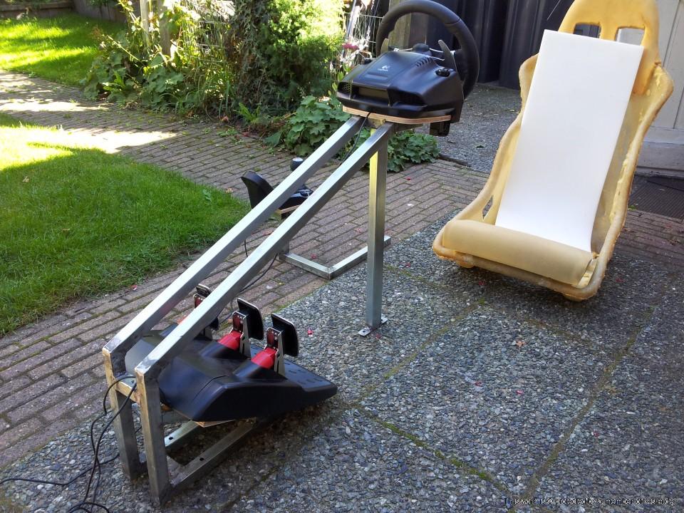

Next the frame again. The mounting for the pedals is on the frame itself. I will just move the whole frame back or forward to adjust it.
321 322
323 324
325 326

Next thing is to get the seat done. I buyed foam that is cut to size and in 2 different densities.
334
346
Glued it on with some hot glue.
347 348
New red fabric :D Damn... that was a ^%#$%@ work.
349 350
351 352
Thats it for now :)
