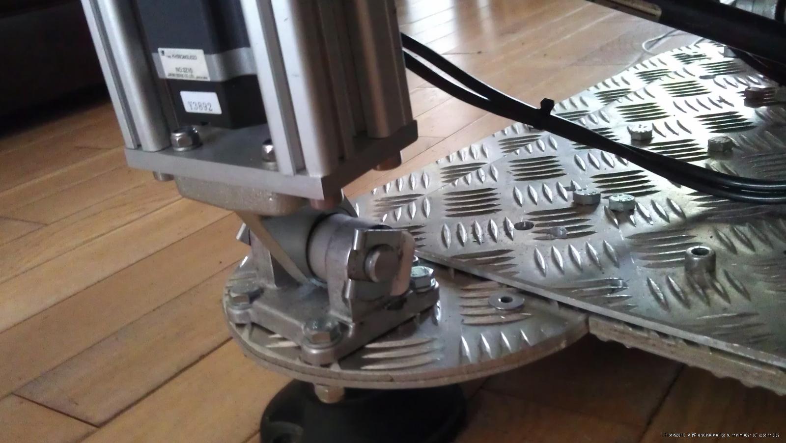

Here is a sketch of the articulated pneumatic mounts I used to attach the drive to the base

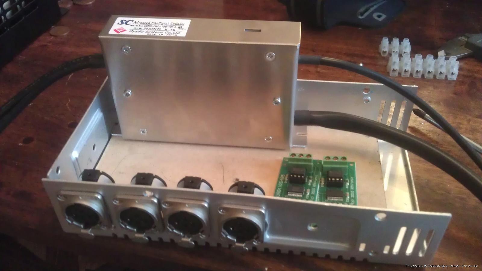

First job on my electrics was to build a housing for the usb/rs485 converters. I used up an old psu case and some old 3 pin xlr chassis mounting sockets as an isolate point.
2800
I then fitted the converters, drive cards and soldered everything up
28022803280528062807
You will notice that the drive cards are very close to each other in my first attempt. This was a mistake I made and you will see that they are now sited outside the psu case and very well spaced indeed.They get very warm very quick if too close to each other but fortunately I spotted this before any damage was caused. Beware if like me you like to tightly package things. It does tell you in the user manual to space them carefully but unfortunately I missed it. It pays to read twice all the documentation available before building stuff. Here is how they are *
