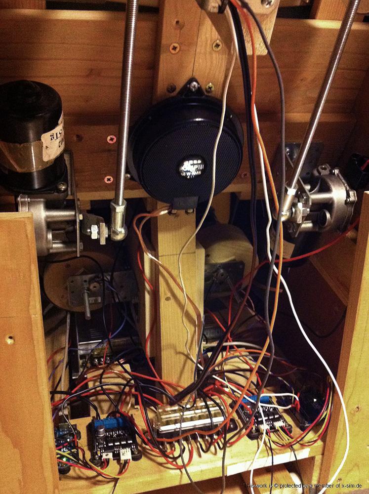

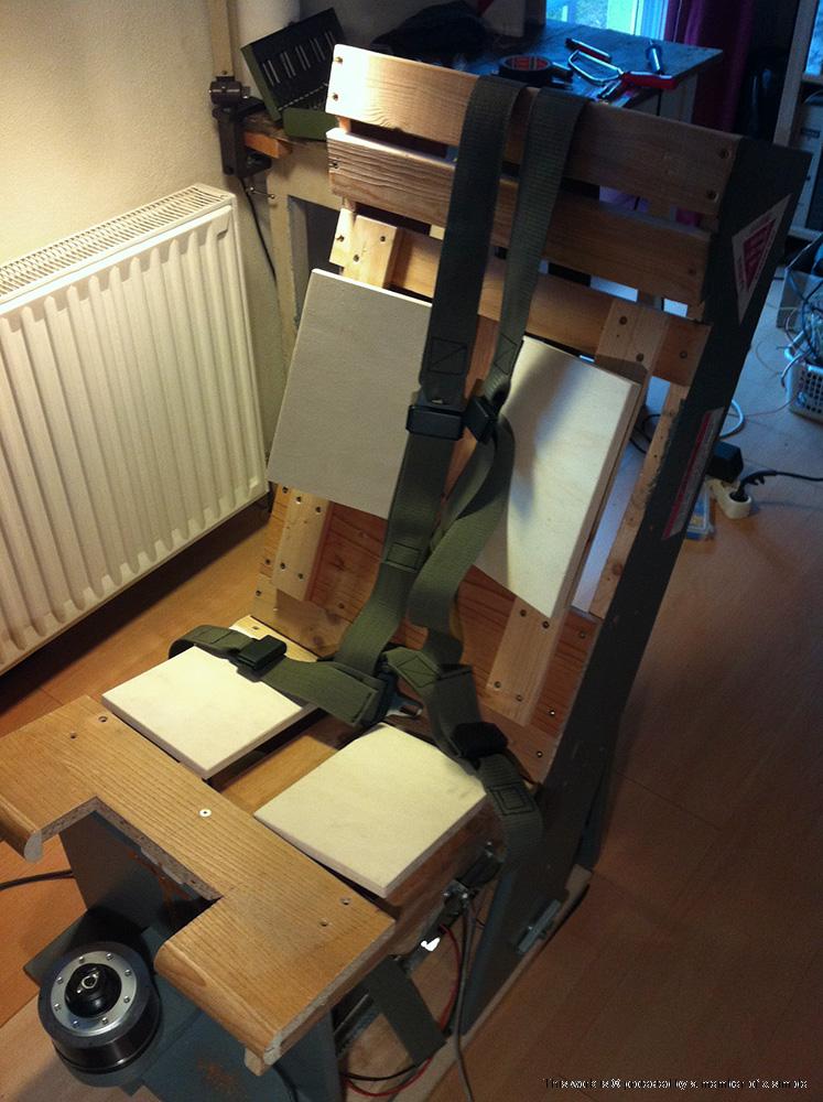

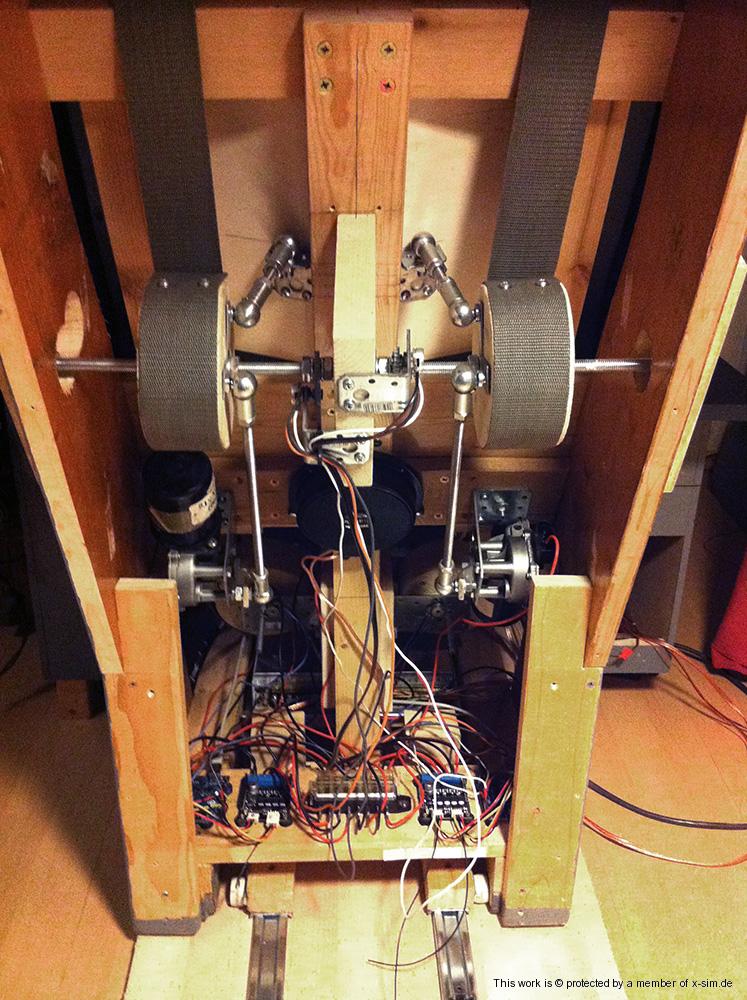

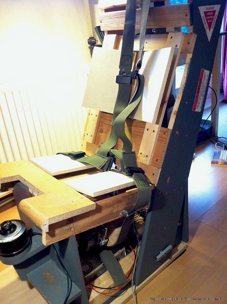

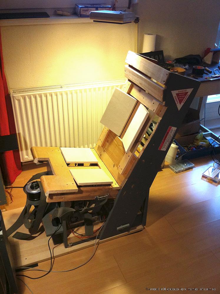

Some updates to my project:
- I Finished building the mechanical units (flap movers and belt tensioners) for all of the four flaps of the seat.
- Installed a bass shaker for simulating vibrations from the engine
- configured the x-sim converter to send x,y and z acceleration values (as well as engine rpm) to the arduinos
Made some very satisfactory test flights with already impressive effects! More updates soon!

Really good made.The idea with the pulley to combinate the back flaps and the belt is very clever.I didn't understand with your first sketch how you will make it but now really great done.
Sirnoname is looking for beta tester for new bass shaker plugin.If you are interested please send him a pm . ;)
