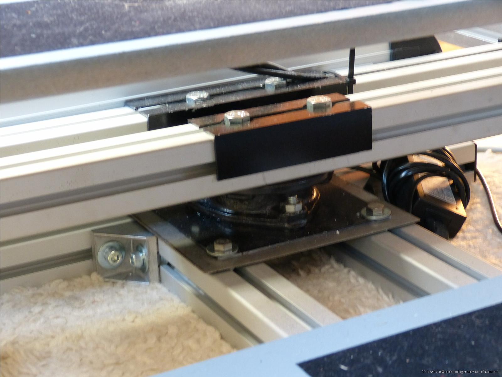

Yokoyoko, what are the overall dimensions of your sim ?
124012281223
I don't know all dimensions from memory - I will add this later here in the thread. But I know that the dimensions in length or width did not change during the upgrade from a 2dof seat mover to the current design. Just the height is increased abou 10cm!
The front bearing is under the pedals ( I use a similar bearing as shown above). The rear bearings are placed under the motors for the seat movement (longitudinal and lateral). ---> You see NO change in "important" dimension.
