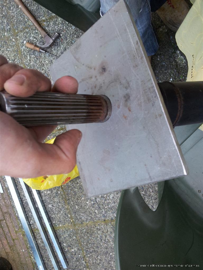

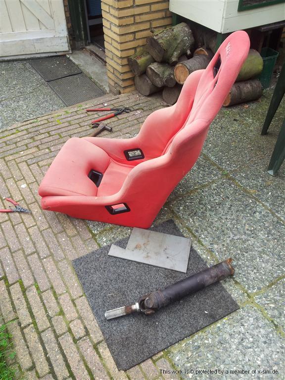

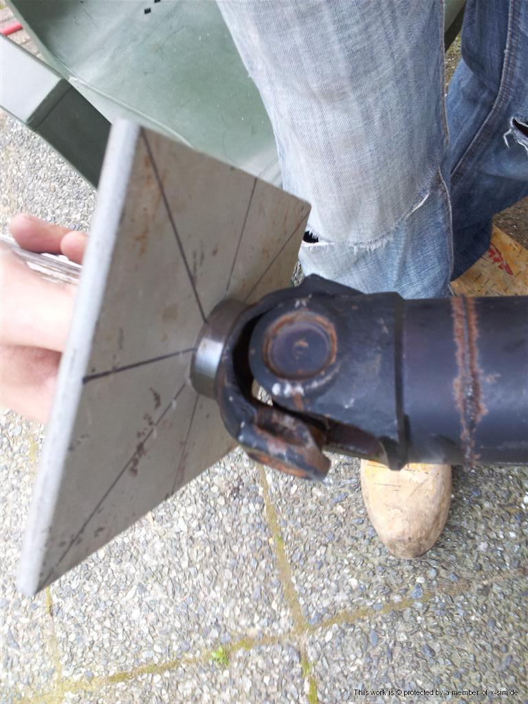

It all started when i got an old racing sparco seat from a friend and bought an old BMW driveshaft:
270

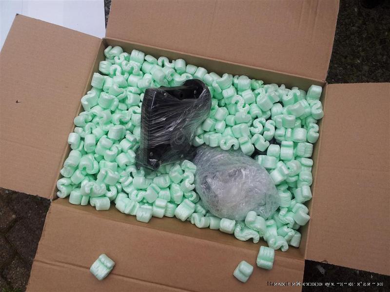

Then the package from Floriske was coming in:
271

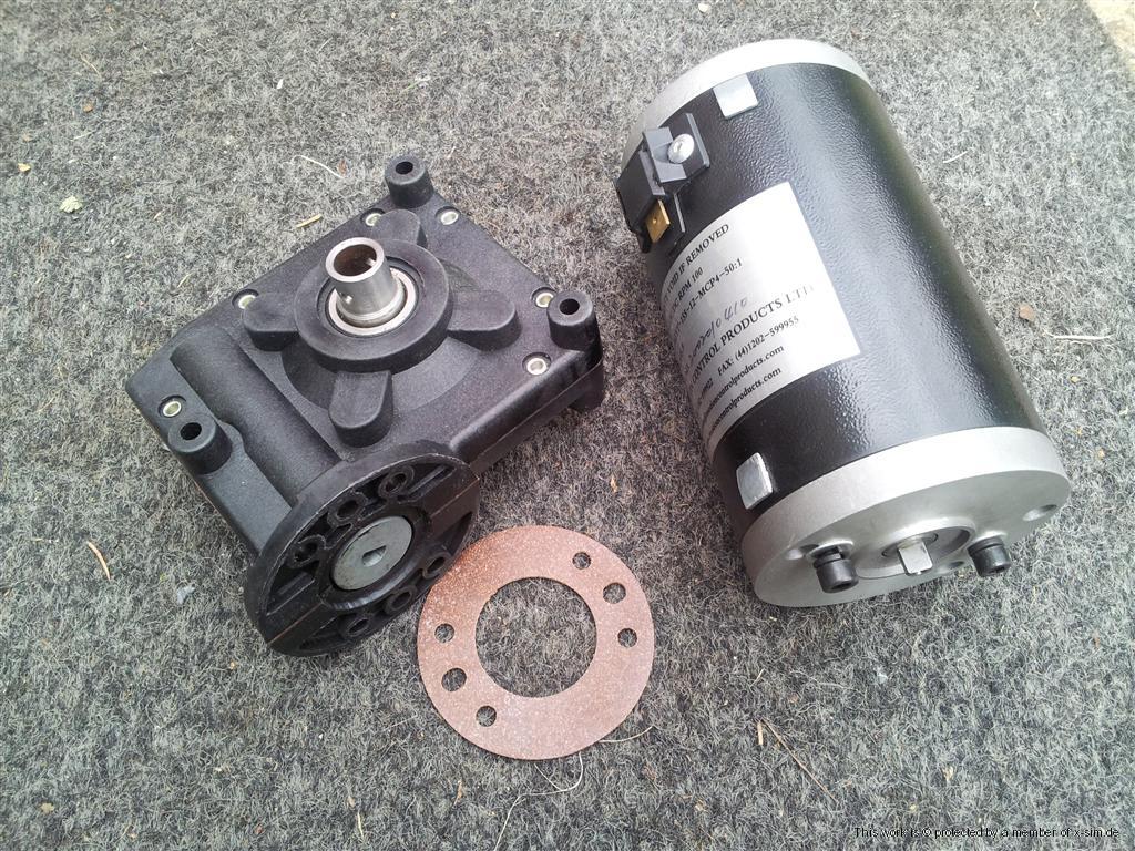

Nice big motors with a 1:25 gearbox:
272

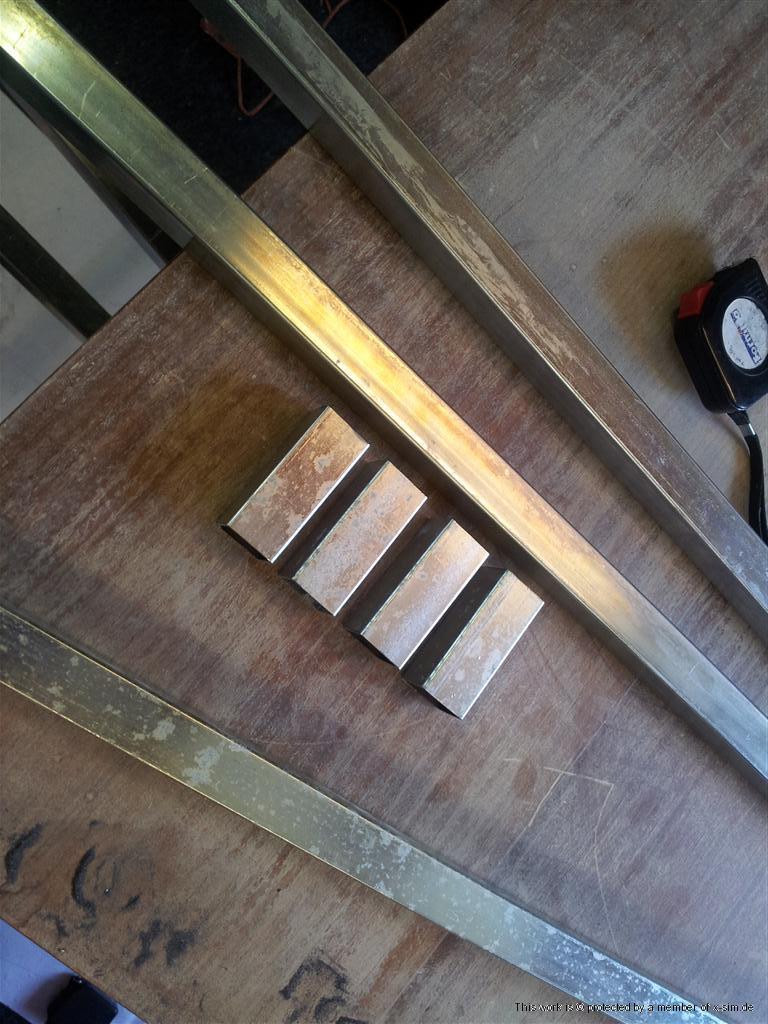

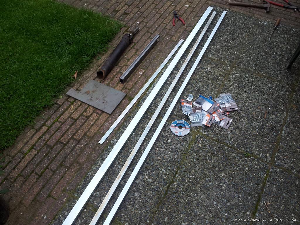

Time for buying metal for the frame:
273

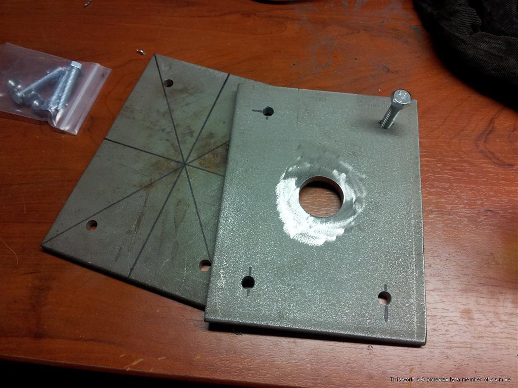

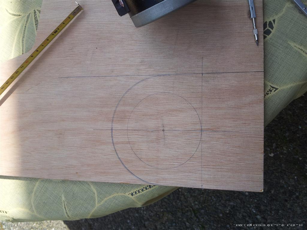

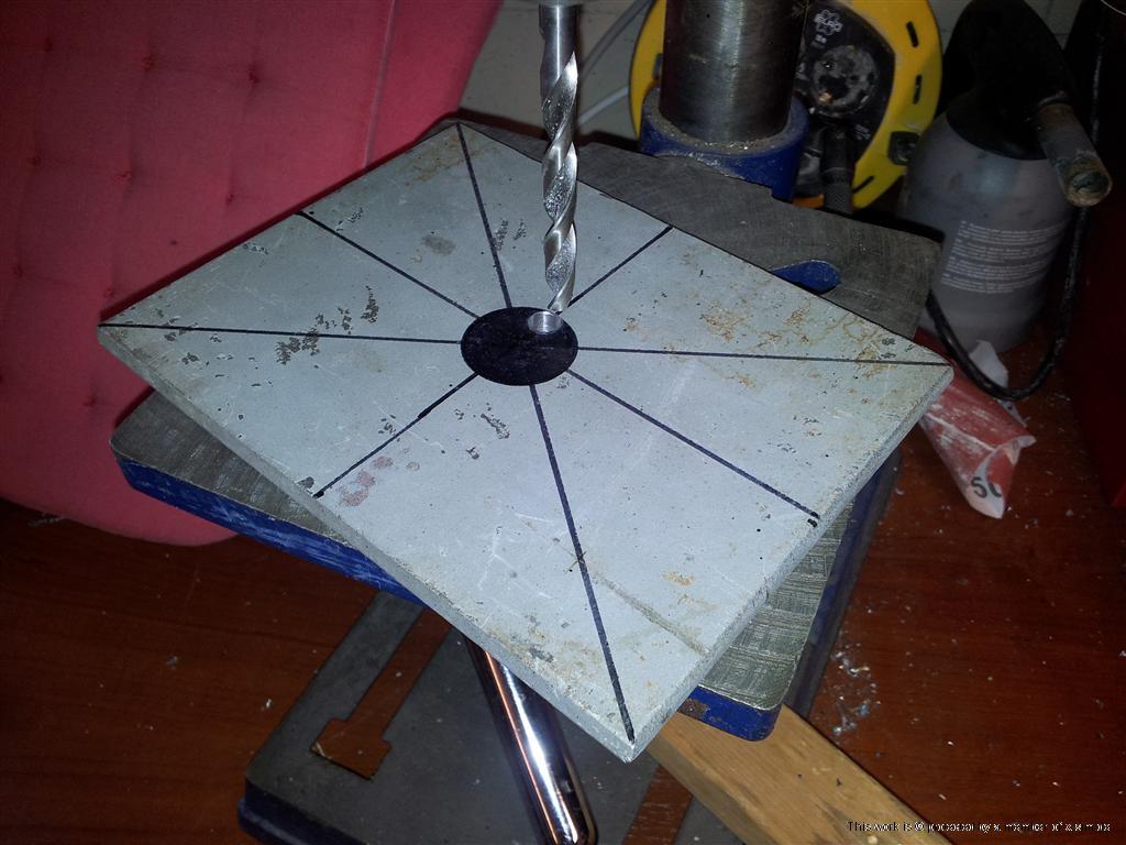

Positioning the center for the pivot:
274
Drilling and so on:
275

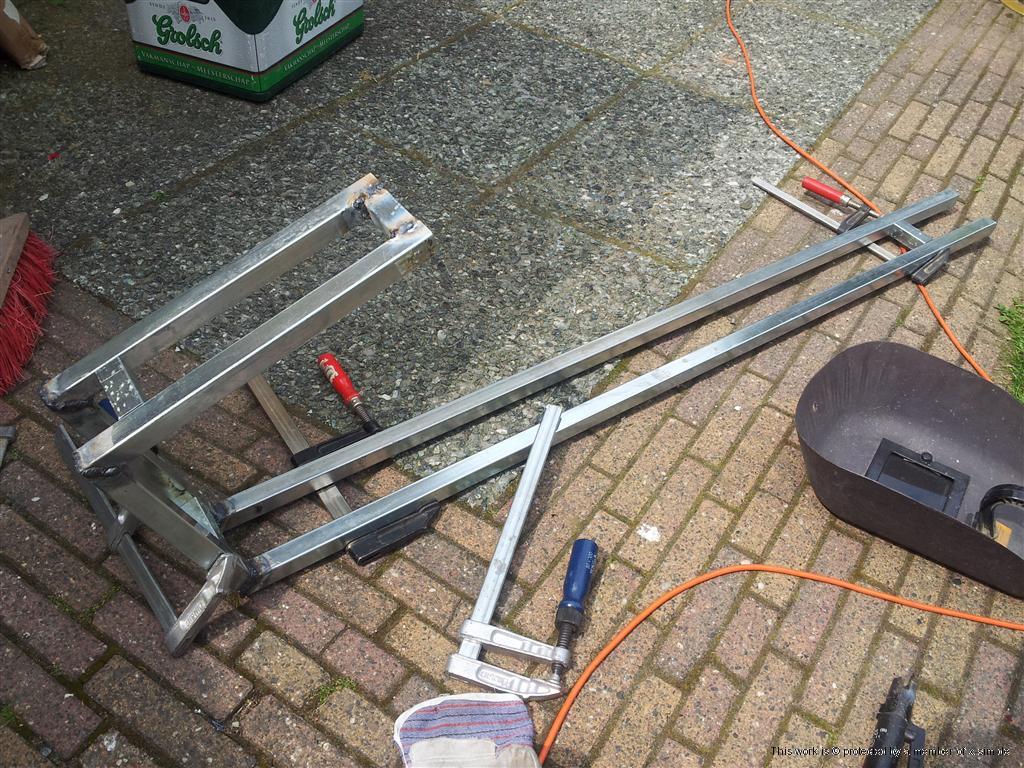

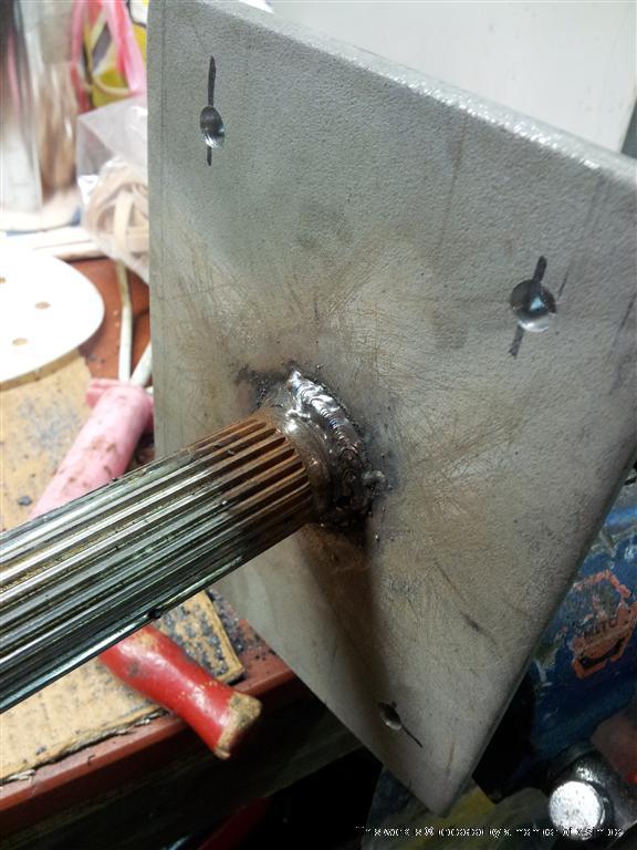

I'm not so good with welding because it's a cheap electrode machine, hope it holds
279
Finally, the pivot:
280

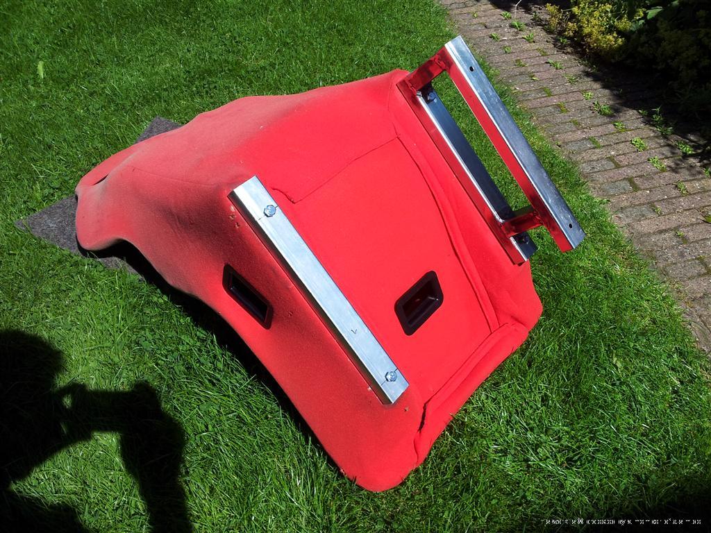

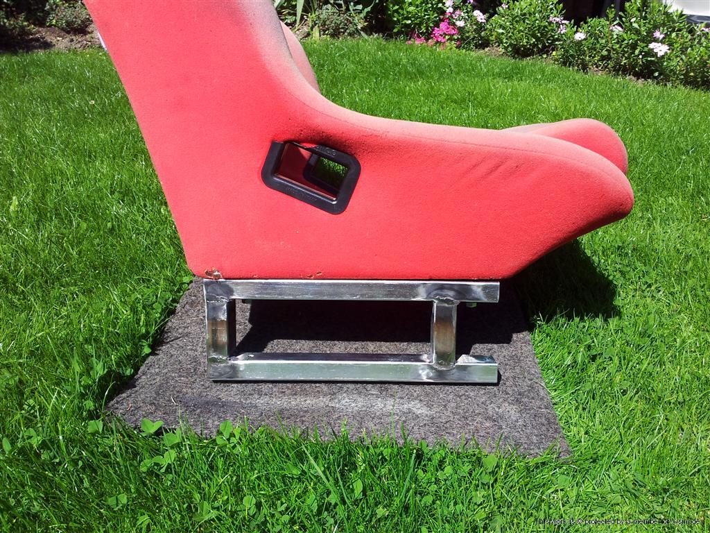

Then the old seat, it needs a mounting, so i made one. It will be mounted on wood.
281

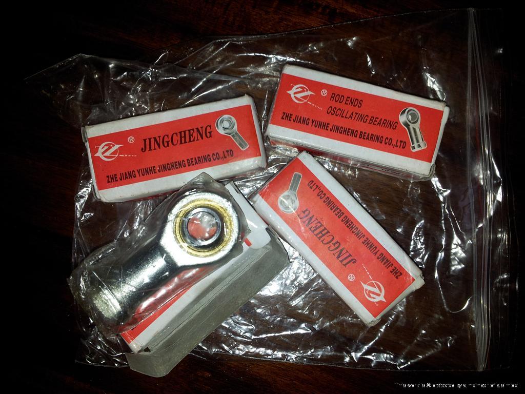

New parts arrived! 8-)
Rod-ends
283

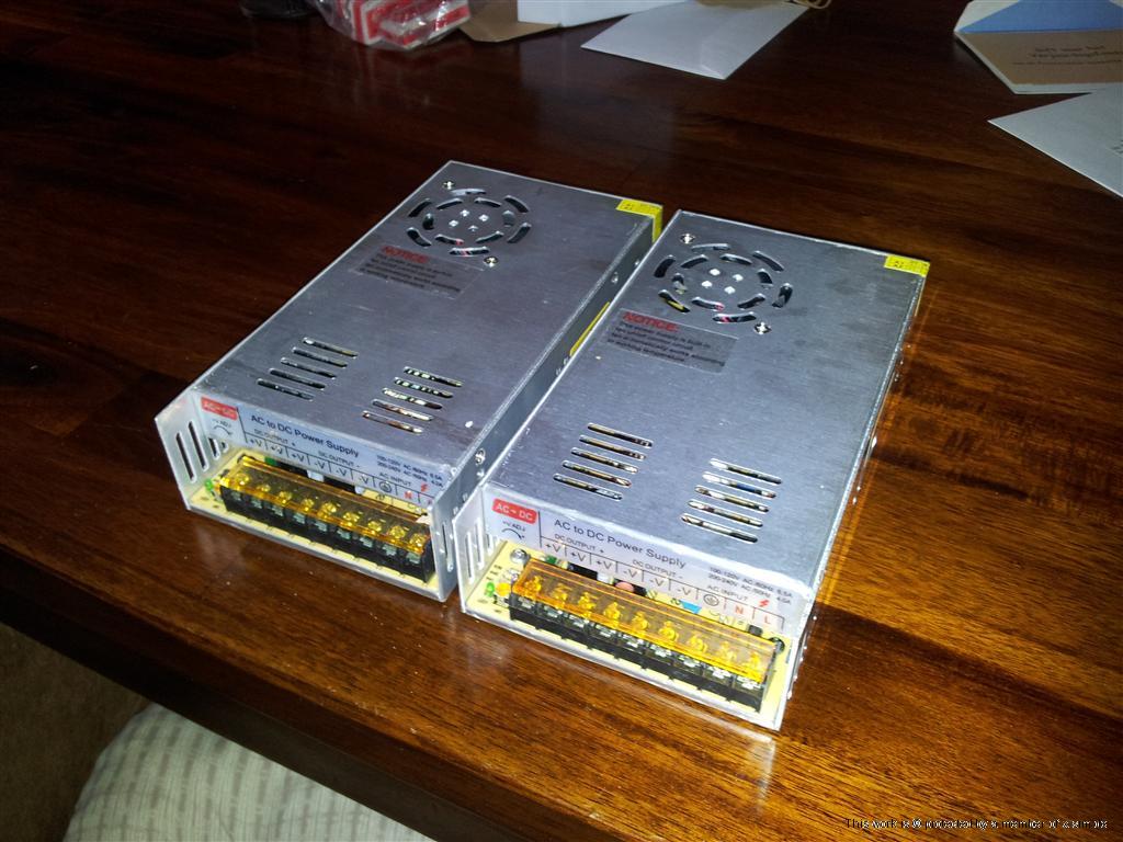

PSU's and springs that are well known on this forum.
286
287

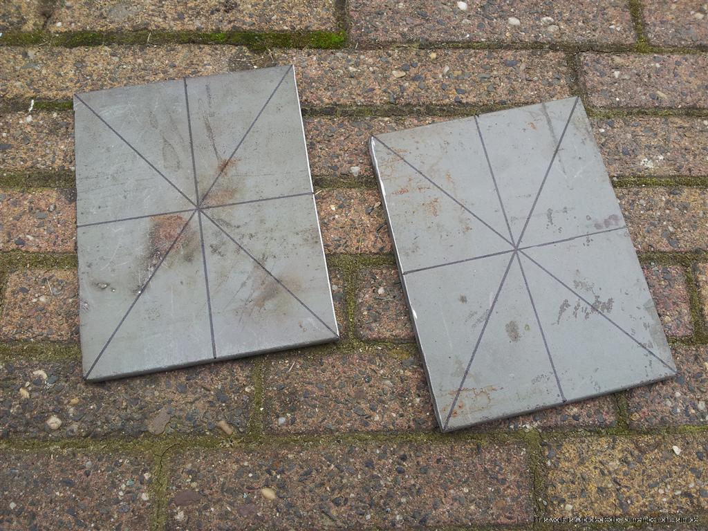

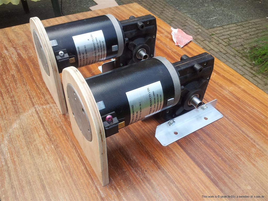

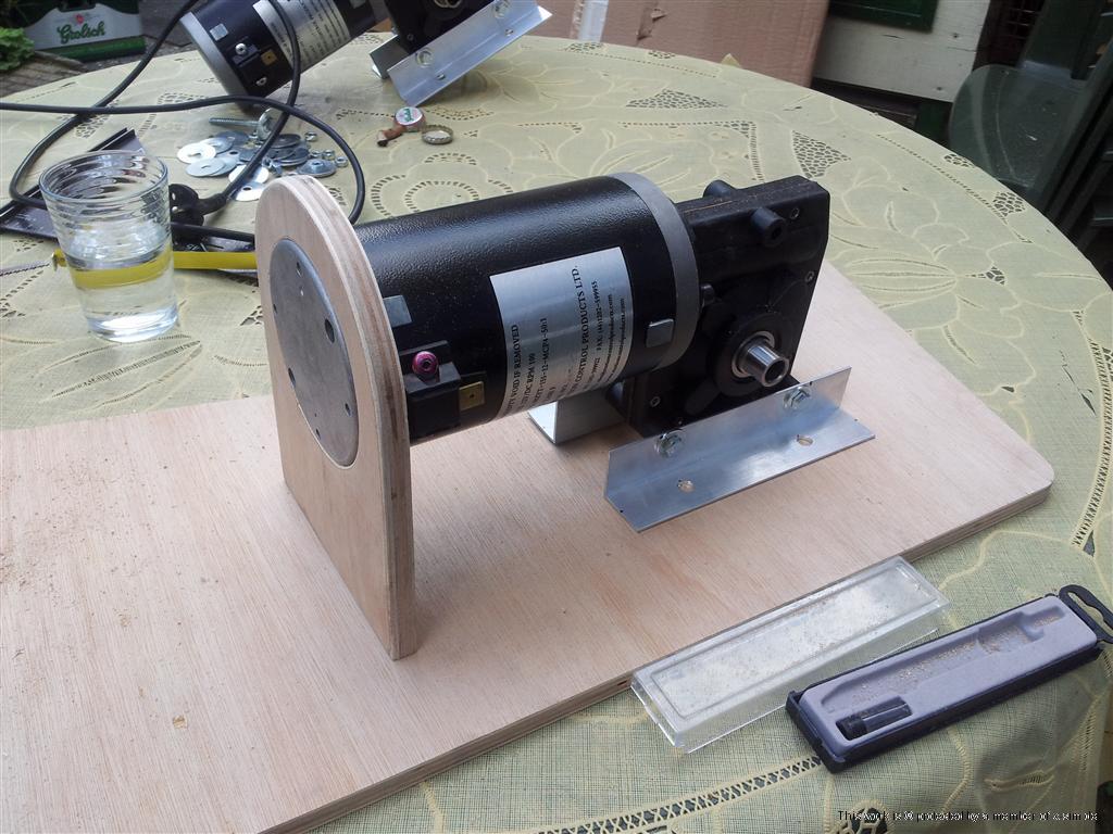

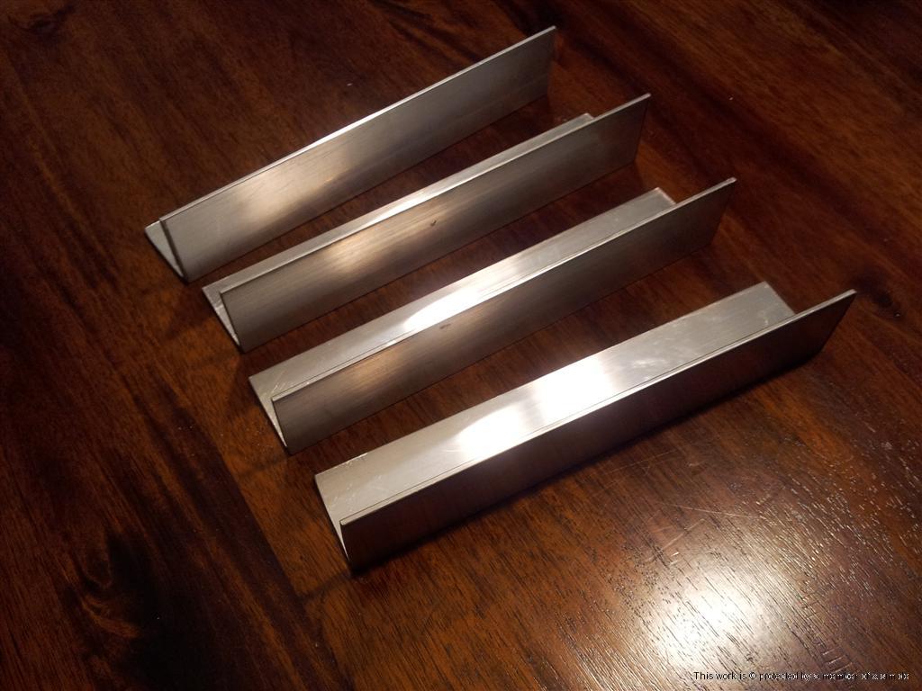

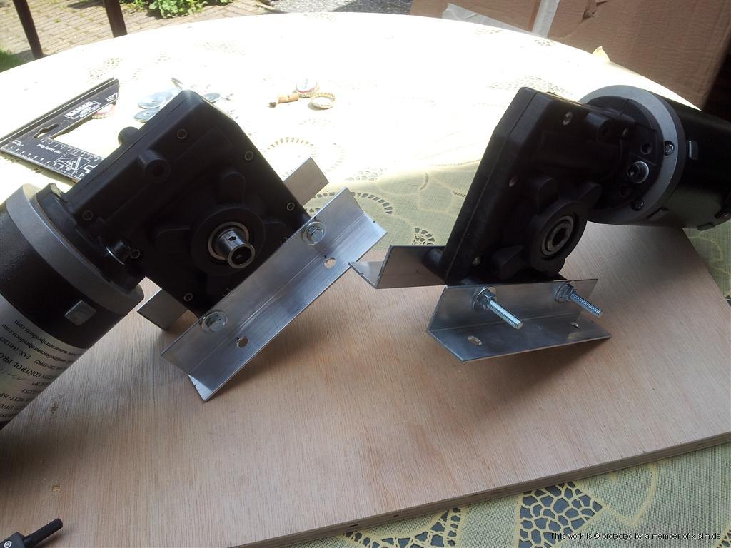

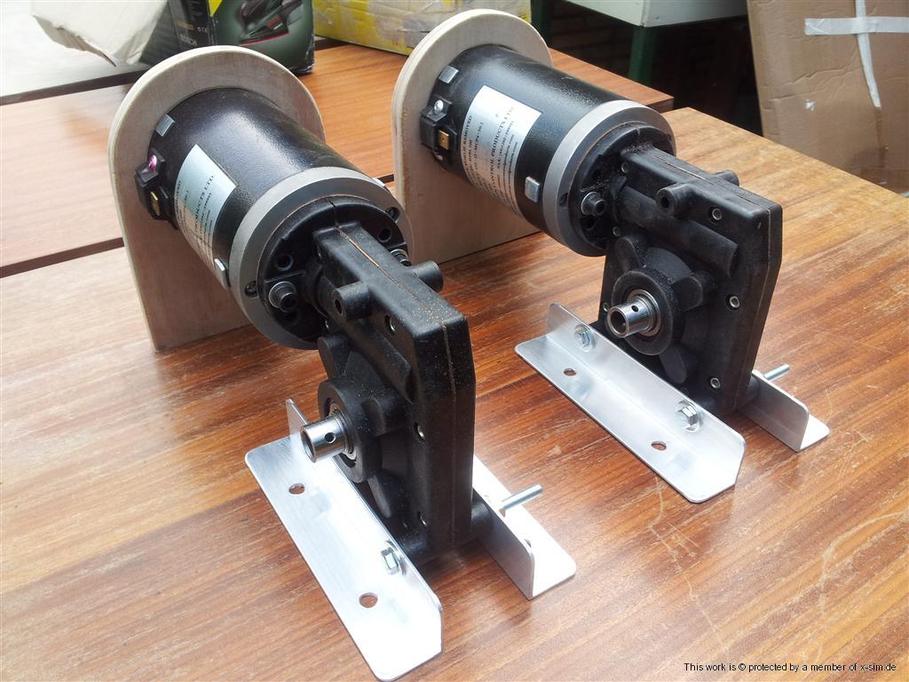

I'm making a custom motor mounting system from wood and metal, starting with the metal brackets:
288
289

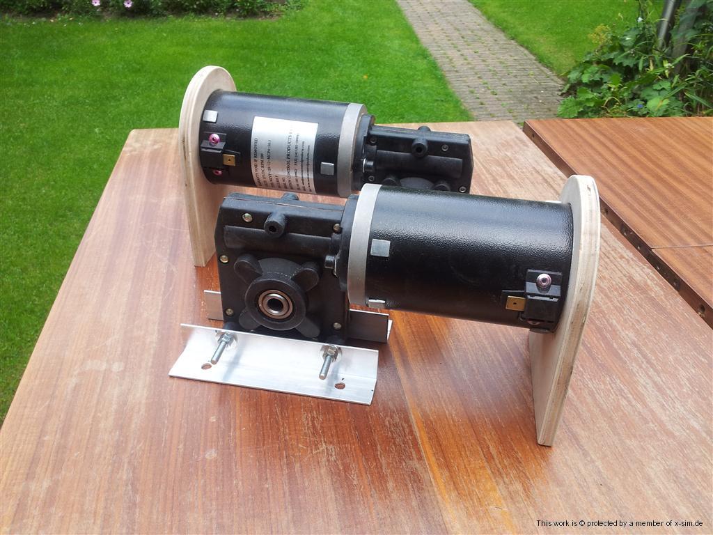

This new mounting system holds the motor up so all the weight of the motor itself will be off the gearbox:
290
291
292

Nice job there, welding looks good, better than mine.
Nice idea about the mount for the back of the motors. That would make them steady. But it wont really take any load off the gearbox.
Good to see progress. The big motors will give you some BOOT for sure!

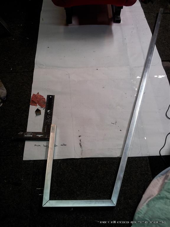

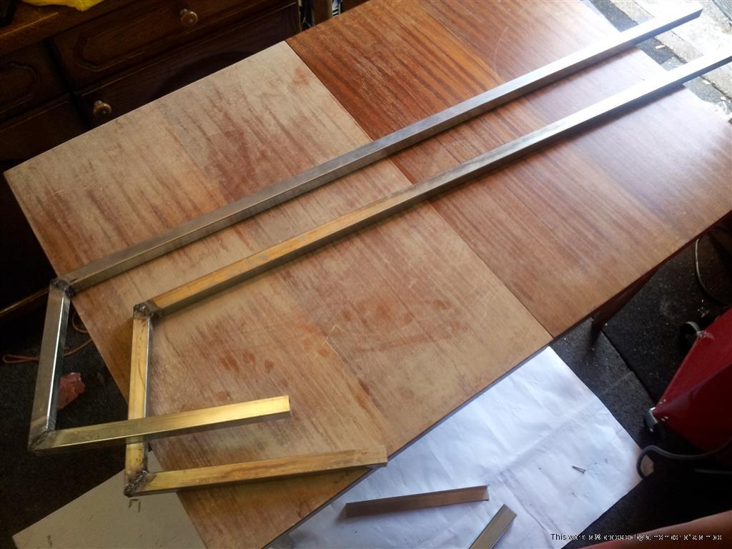

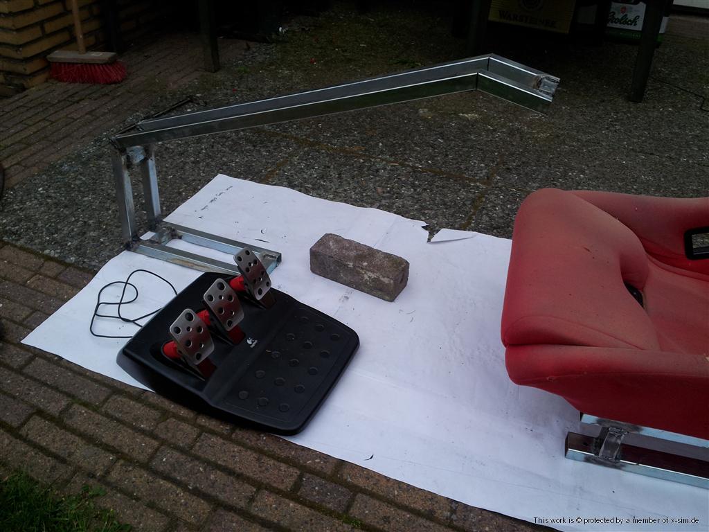

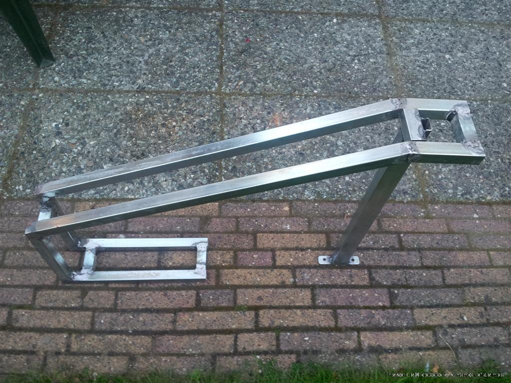

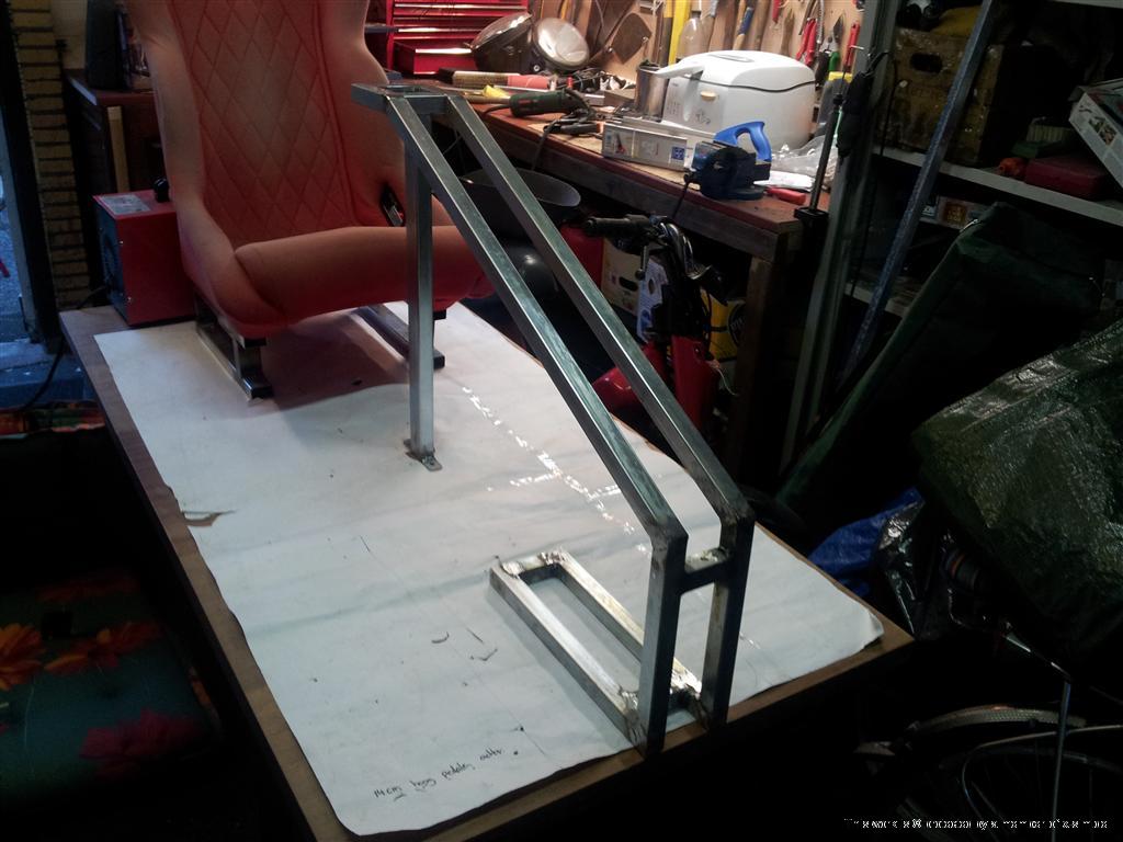

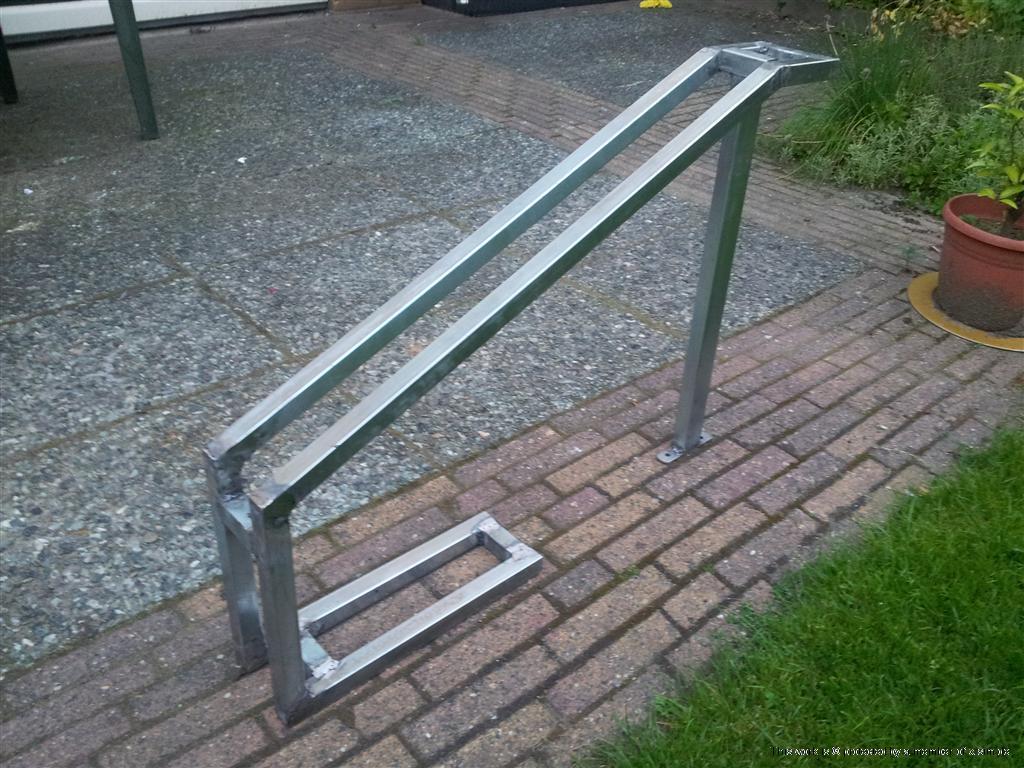

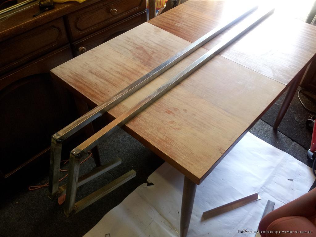

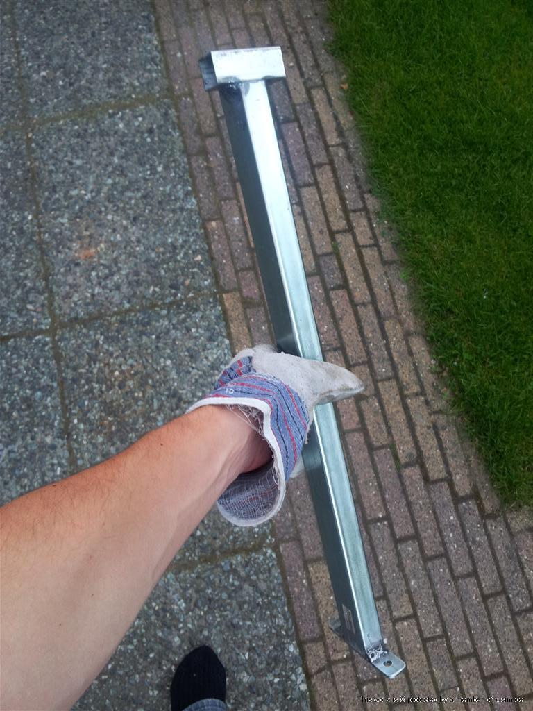

I'm using steel square tubes for my frame that will holds te wheel and pedals. This frame will be mounted on wood later, with the option to mount it in 2 positions, close or far away from the race seat.
296
297
298
299
300
301

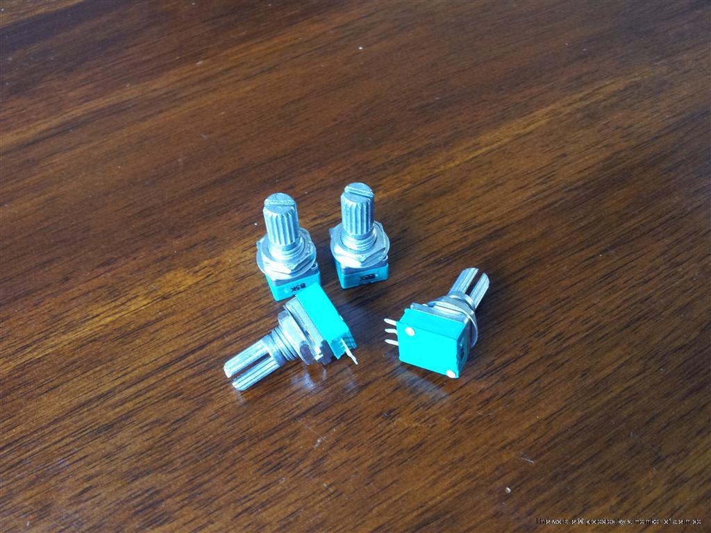

The feedback pots arrived, these are "high quality" 5K pots, 10K normal pots are on there way from China at the moment. I think i will use the 5k at first.
302

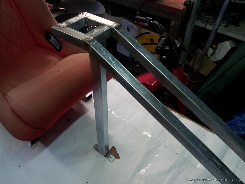

For stability the frame needs a support under the wheel:
303
304
305
The frame isn't done yet, next step is to weld a pedal mounting and start to build a small frame for the G27 shifter.
306
307
308
Do you guys like the simple design?

Postby floriske » Mon 17. Sep 2012, 08:46
Looking good!
Just make sure your balance point is spot on when you are done (determine it with the most frequent driver in the chair of course ;)).
One thing i would do if it's your intention to have multiple people racing on it: make your pedals easilly adjustable. Something I noticed with mine with 3 different people: the steering wheel could stay in it's place, the pedals had to be move for each one of them!
KUTGW!
