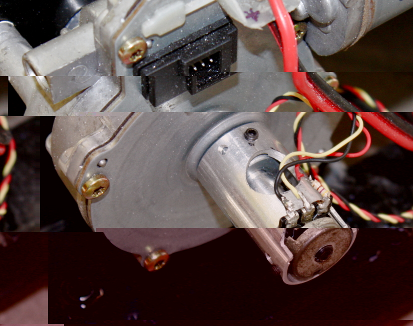

"With a file, try to file a 18° cone down : it has to go well on the motor shaft. " --> how did you do that? What kind of object ?
Thank you

@johnnyfive : the file is this hand tool
http://www.castorama.fr/store/Lime-rond ... 90011.html

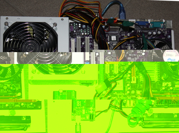

Postby Tombo » Fri 25. Oct 2013, 16:16
Hi,

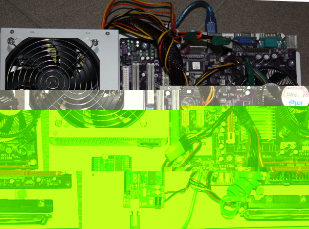

thanks for reply. But I'm not at the step to send serial comands. I have not connected the pot to the motors i'm just at step 1. My psu should have enough amperage because its in parallel with car battery and the motor on the right side is moving very well only the left one isn't inverting. But like i said motors connectet directly to psu they work fine and hbridge without motors work fine too so i'm a little bit confused what i did wrong. :?:
I don't power the arduino separatly only by usb. Or is it necassary to power arduino with external psu?
here are 2 pictures of my wireing with no connected motors.
22182217
Tombo
Posts: 97
Images: 36
Location: Germany
Has thanked: 6 times
Been thanked: 8 times
Postby RacingMat » Fri 25. Oct 2013, 17:43
Tombo wrote:I don't power the arduino separatly only by usb.
It works well for me with no additional external power supply!
I looked at your pics: maybe the cable ground shield (aluminium) may shortcut somewhere?!

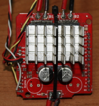

Postby Tombo » Sat 26. Oct 2013, 21:34
Hi,
ok i will make the cables thicker later. At the moment i drive the motors without load and with 10A fuse. Everything works well instead that the one motor isn't inverting. If no motors connected controller work fine. I replaced pot cable and pots. I really don't know what to do the otherside just works fine :?: . Maybe my controller is defective? Would be very bad :(
Like i said before the led for direction that isn't working is not lit up very bright.

Postby Tombo » Sun 27. Oct 2013, 12:30
Hi,
at first test i had no resistors. Than i've readed it and added 2x220ohm becuase i hat no 470 ohm resistor. This will not change anything. I measured 5 vollt line from arduino and its ok. Pots both ave 1,16 Kohm resistanze so they shoud be ok too. Because if i switch them they work fine on the other side.
I made a little video maybe you can see better whats the problem. At first you see behavior without connectd motors everything ok. Second is with motor connected on the left side you see the green led doesn't work good. Sry for bad video quality.
For me everything looks like my controller is defective. So you think this will be a better solution? http://nodna.de/Pololu-Dual-VNH5019-Motor-Driver-Shield-fuer-Arduino-12A
