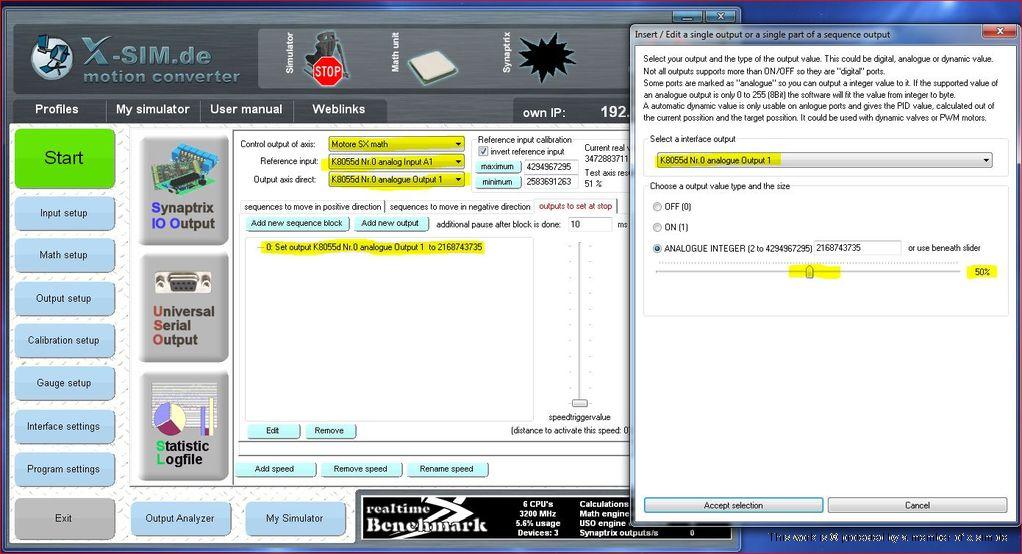

hi
for the moment i use vellemann K8055 and Sabertooth.
When i start Xsim i have always to go interface settings and set the output controll at 50%.
Because Sabertooth gives 0 backward 2,5V Stop and 5V Forward.
So when i start Xsim and power the Motors they always goes to Limit.
I wanna that the Power is set to 2,5 V when i start Xsim. But i dont know how to do this.
I hope you understand
menix
menix
Posts: 36
Joined: Tue 20. Mar 2012, 19:44
Re: Sim Project - 2DOF K8055+Sabertooth 2x12 -Stage 2
Postby prodigy » Tue 17. Sep 2013, 10:20
I think all of us who used K8055 had same problem, this was my procedure:
- I plug-in K8055 USB, open X-Sim Converter, go to "Interface" tab and set output to 50%, turn on motors (release emergency button) and they stay in position.

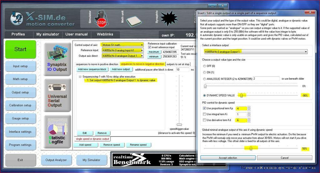

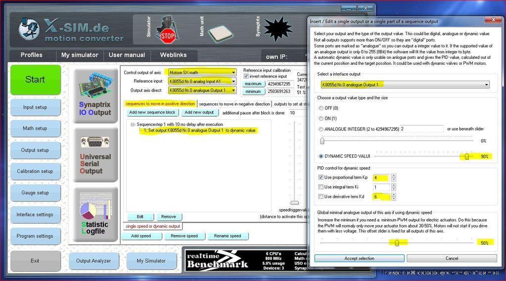

menix wrote:hi
menix
Hello
If you follow these settings you should have no problems and do not have to put interface settings and set the output controll at 50%
114211411140 ;)
