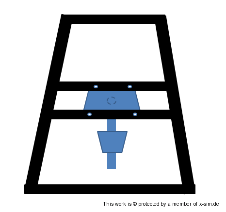

Yes, it's welded on both sides.
But if you don't like this way, you can use bolts:
2932

Thanks Mat, that is a good idea, I reckon I can make that work. It will be much easier getting it up my stairs if I can carry it in a couple of pieces.
I have build the top part and I am loving using it with no motion on my just signed up for iracing account. Now I just need to stop racing long enough to complete the lower frame.
