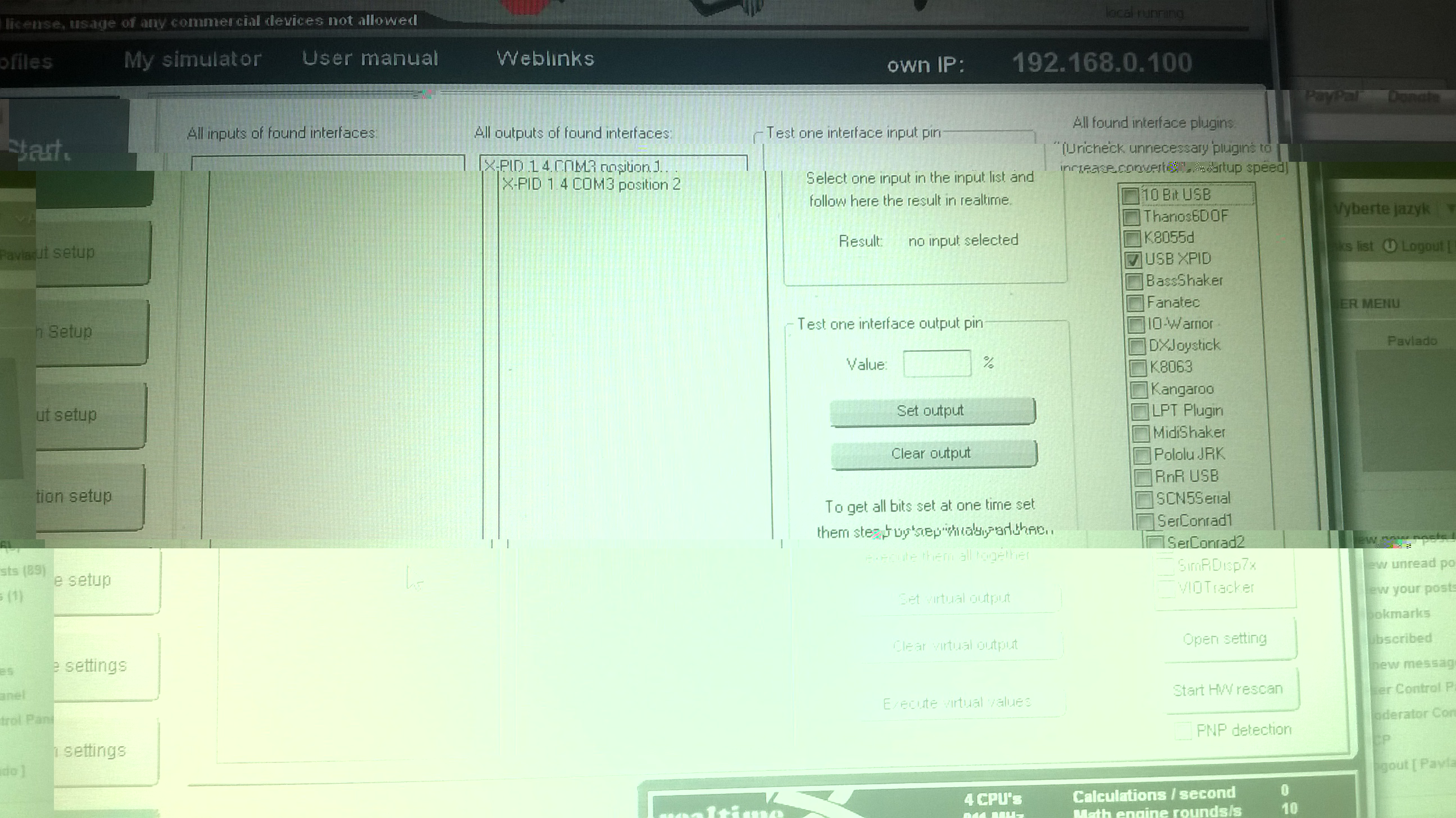

RacingMat wrote:Hi Pavlado!
Probably you have check too many interfaces in Xsim.
It tries to open different serial communication on same ComPort.
You only need USO interface: uncheck other plugins in the different tabs ;)
(Can you send the screen shot of your interface setup ?)
yours
Mat
This is my interface setup.
Pavlado

Postby RacingMat » Sat 31. May 2014, 19:06
Hi!
You don't need XPID !
Uncheck it and follow Sirnoname's advice by running the registry cleaning

Postby sirnoname » Sat 31. May 2014, 21:49
You need X-Pid plugin checked because X-PID is loaded.
You do not need any entry in the USO if using X-PID.
With arduino X-PID loadd you get full GUI support and easy setup to the whole program.
Do not use USO because it is a platform for developer and does not come with the features a plugin come.

Postby sirnoname » Sun 1. Jun 2014, 00:34
Look at the picture -> X-Pid found.
Unchecking the plugin does not change the situation.
You must tell him to change the arduino firmware to your code in the first thread.

Postby RacingMat » Sun 1. Jun 2014, 12:40
Pavlado wrote:So you do not have a set USO?
1- Upload my code into the Arduino
2- setup the USO parameters as described
3- do not use XPID
you can upload the file from Kalarius here
