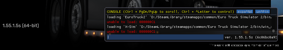

Hello, i am trying to build my motion simulator and i found some problems... I test the Extractor and Converter and it seems works very well on Asseto Corsa, i didn't test on the Arduino but i think it will work fine too. But the giant problem: The ETS2(my favorite simulation game 8-) ) does not work with X-Sim.dll, and don't show up the notification dialog saying that you are using SDK plugins inside the game. I go to the console view and always give the error 000000C1. This happens to X-Sim.dll and EuroTruck2.dll(the wizard dialog of extractor put this file), and i don't have skills to debug the game and plugins to find the error. I will be very happy if works! Everyday on night i spent time trying to make works with ETS2. Please help me!
5024
Observation: I Read in the forum that error can be happen due a ETS2 blocked a function that allows SDK plugins, because can be used for a commercial purpose. I don't know, beacuse some apps of telemetry can get the speed information and the game pop-up the window saying about SDK use... I remove all the other plugins in the folder to not make conflict and don't work!
