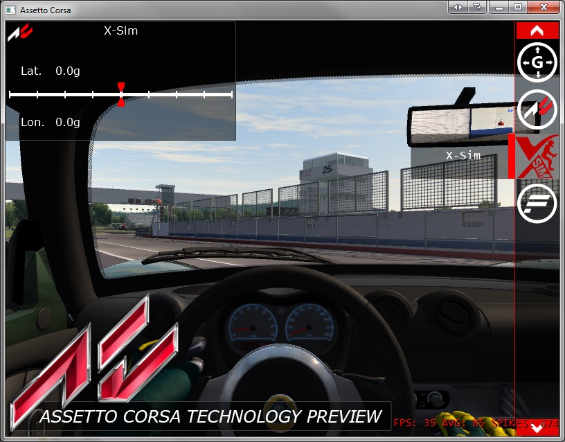

Here is a picture of the other plugin, the app. However the python is not stable and does sometimes not load the scripts if there are phyton calls like writing a file to disk, so it will be delayed until it is working stable:
It is based on the g-meter example and will be rewritten step by step for a simulator usage.
