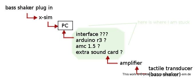

Hi, I built one tactile transducer (bass shaker) like those diy from youtube and tested it with music with good results. :D
Now, since I made it as a gadget for my motion simulator, I want it connected with x-sim.
So how do I interface it to my pc/x-sim ?
Here a picture ilustrating what I miss:
1362
Please any help will be apreciated :)

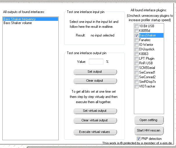

Hi !
In addition to the previous doc, I've read a very useful document attached in this post http://www.x-sim.de/forum/viewtopic.php?f=47&t=78#p444
So, I followed these steps :
- select and highlight "Bass Shaker" then click on "Open Setting"
1517
then peripheral selection
1518
at that stage, I can hear sound in by speaker when I click on the "Test" buttons :D

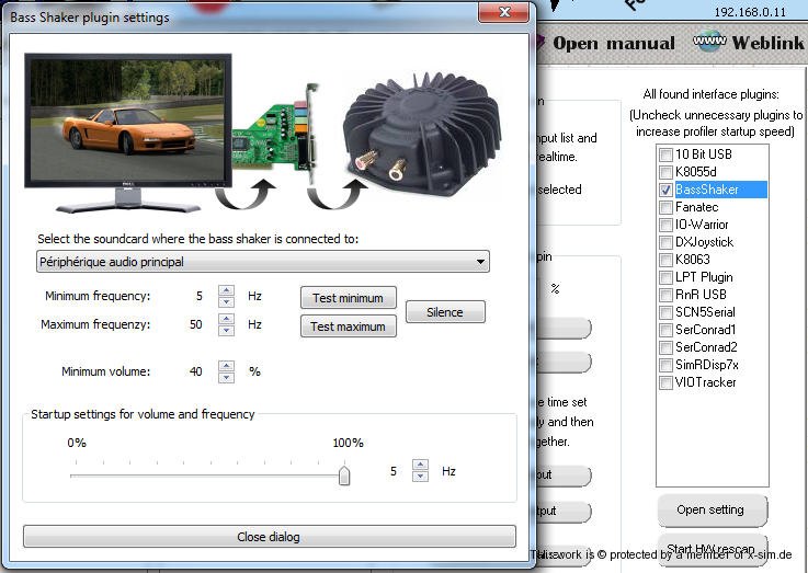

- in "Interface setting", select and highlight "Bass Shaker" then click on "Open Setting"
1517
1518

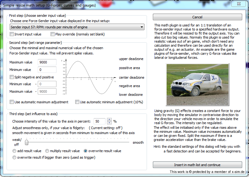

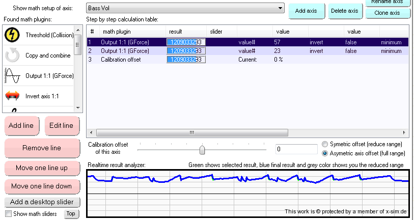

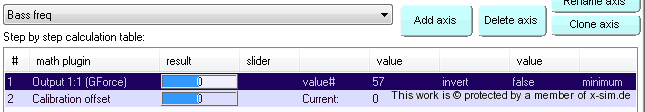

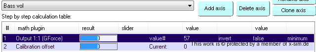

- then, in the "Math Setup", I add an Axis called Bass Volume
i use the "effect 57 : RPM rounds per minute of engine"
(you can later add "effect 23 Gear shake effect")
1523
put volume to 100% : 1526

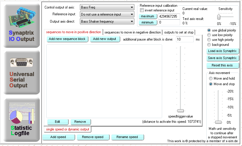

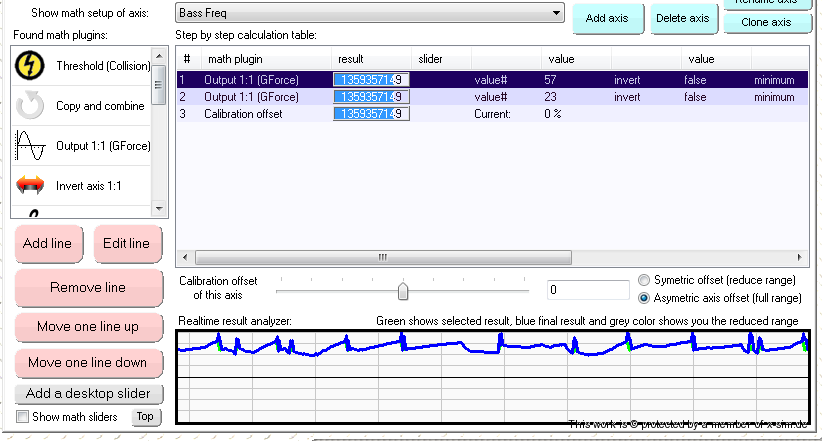

- and I add another Axis called "Bass Frequency"
15211520

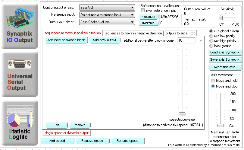

in the "Output panel" / "Synaptrix" :
I linked the "Control Output of Axis" and the "Output Axis Direct" for Volume and also for Frequency
this is mandatory : if not, it won't work fine
15251524
When the game is running and the Profiler started, I can see the graphs changing and feel the vibration !!
volume 1527
frequency 1528
Go !!!!

Postby dESK0 » Sun 19. Jul 2015, 01:43
You should say that for effect 23 must to put "add result value", not "overwrite result value" ;)
