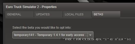

It appears that telemetry data for plugins not implemented until patch 1.4.1.
Default install of Steam FULL version and DEMO version are NOT the latest patch version.
ONLY steam FULL version can be manually updated to version 1.4.1
(inside steam interface) by right click in game list and choosing properites.
Select BETAS tab
Select Temporary141 opt in from the drop down list.
1810
Steam DEMO version does not have this option. ( currently ver 1.3.1d )

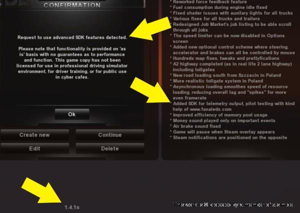

So, I just manually created the "/plugins" folder and put the Truck Plugin dll inside this folder.
"C:\Program Files (x86)\Steam\steamapps\common\Euro Truck Simulator 2\bin\win_x86\plugins\X-Sim.dll"
I selected rFactor plugin as instructed.
Started the game, and when the game started at the character select screen, it brought up a confirmation window to use advanced SDK features.
1811
(SUCCESS!)
When game loads into the game world, data seems to be sent to x-sim and simulator chair responds accordingly.
