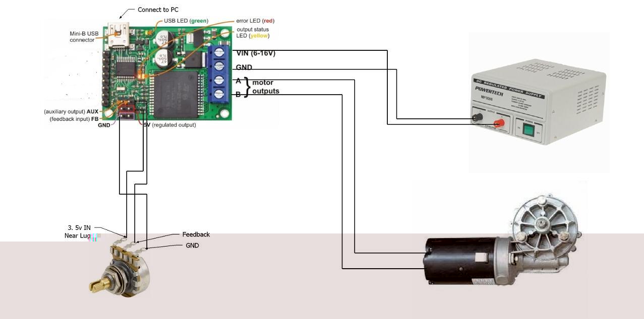

i m about to order pololu jrk12v12 for 2 wiper motors
i can't any info for the conection etc
i need you help guys. a pololu board works by it self ,no h-bridges,isolators ,it is main board for all .is that right ? i will need no extra boards to control my 2 wiper motors ?
how am i gonna conect 2 usb boards with 1 usb from my pc ? sorry about the questions but its new stuff for me !!
thanks a lot

Yes, JRK is one board for all, controller and driver in one.
You need 2x JRK, 2x 5K or 10K potentiometer, a good power supply and motors. One JRK per motor.

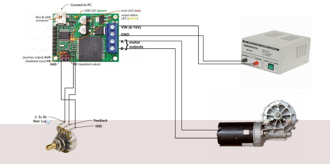

Connection is pretty easy, 7 wires. Here's a scheme from MotionDave:
Each JRK has own USB connection so you need 2 free USB slots in you PC.
It's best to connect them in backside USB's slots to avoid COMport errors, front panel USB slots sometimes don't work good for JRK's.
