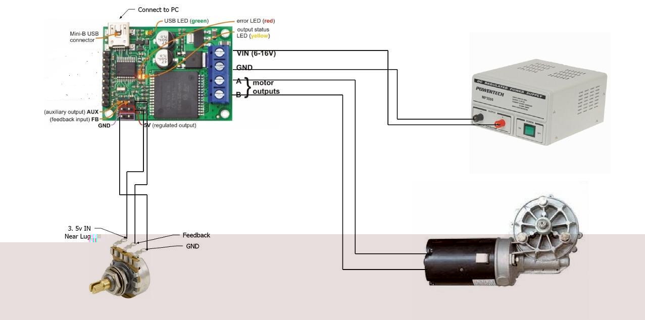

Here is the wiring diagram for each JRK
download/file.php?id=1390&mode=view/jrk%20to%20wiper%20wireup%20fixed.JPG
As for power supply, Floriske uses two power supplies, one for each JRK and you can find more details in his project topic. And as I remember MotionDave uses power supply + car battery to power upt his JRK's. They can explain better.

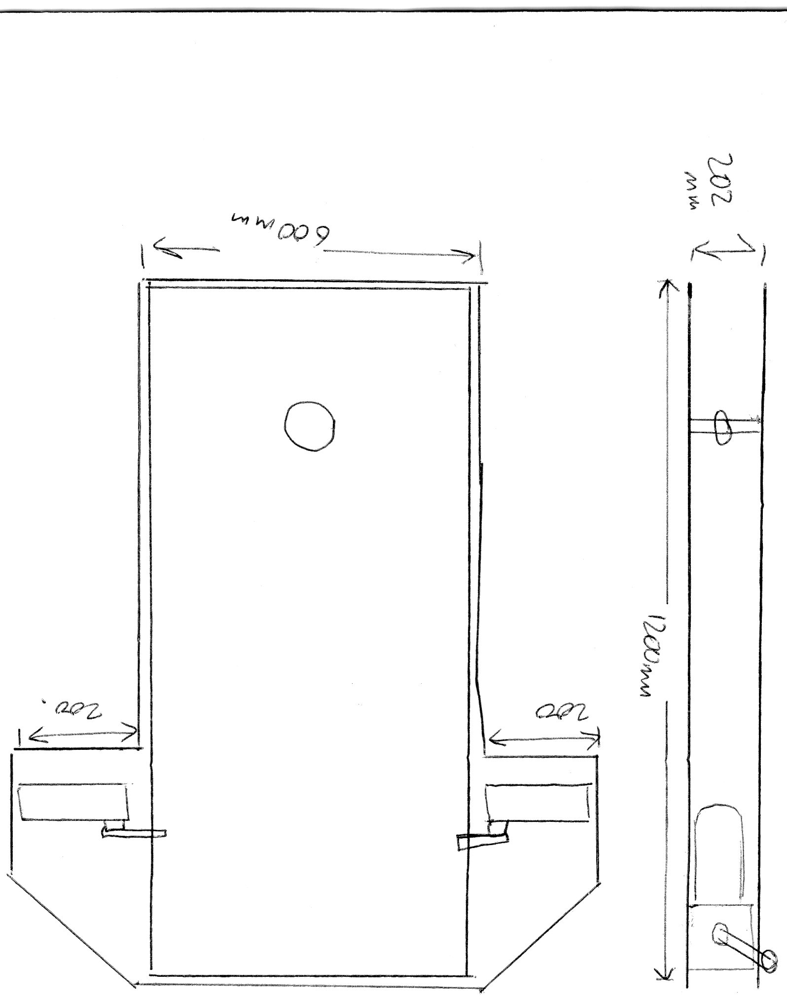

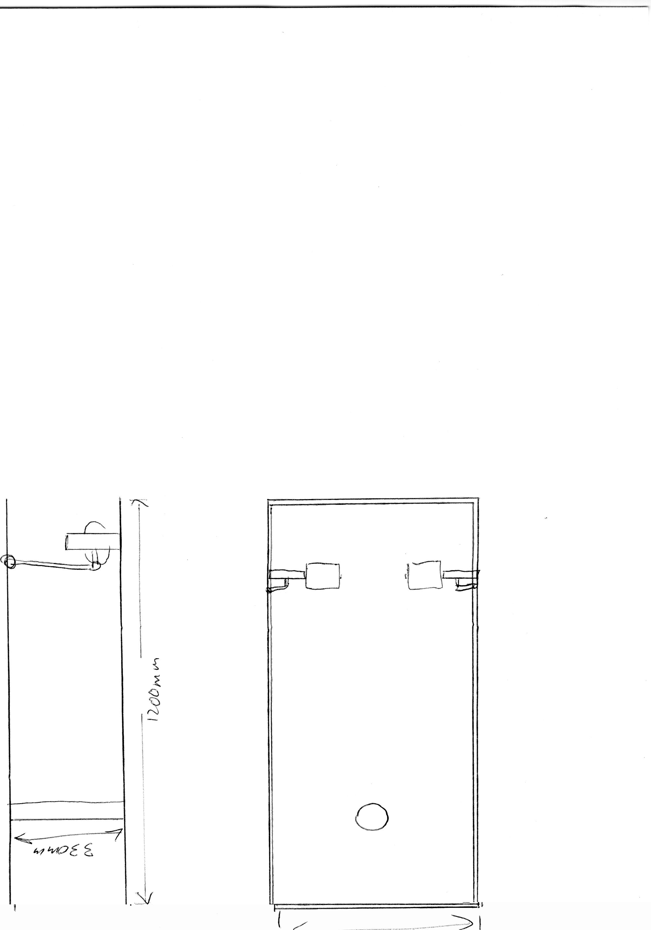

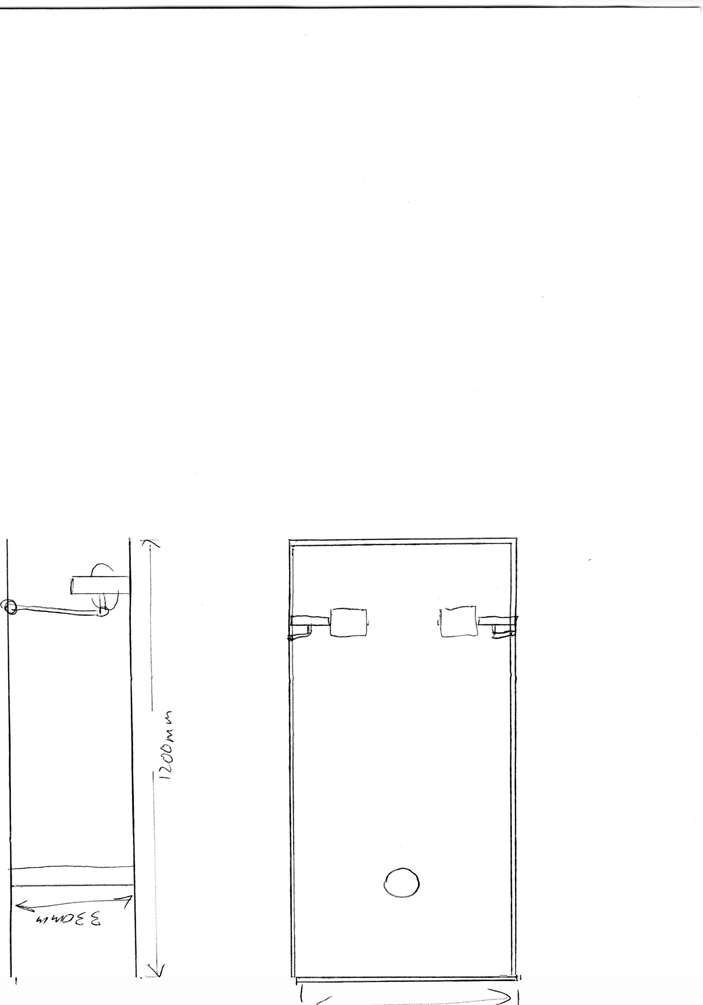

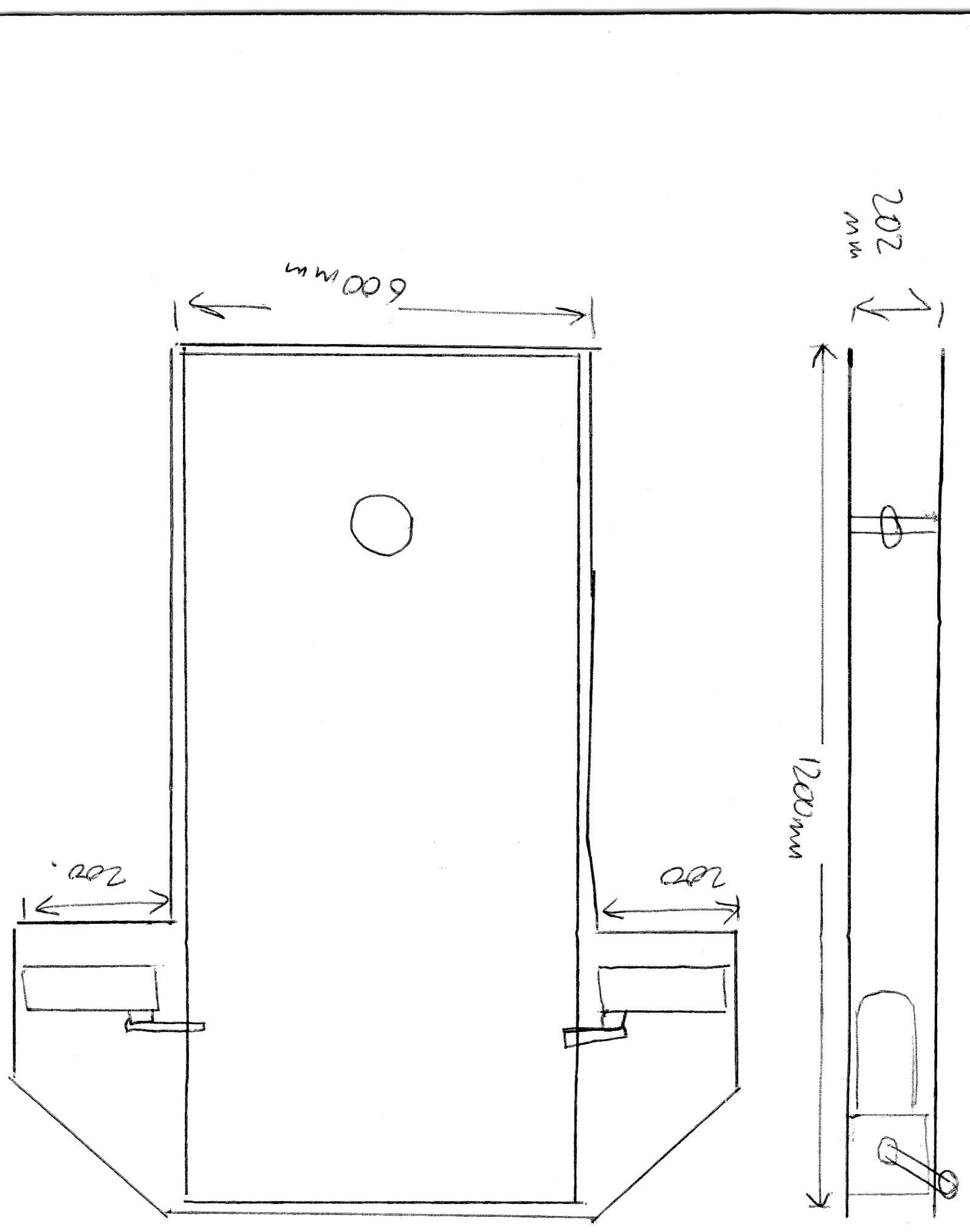

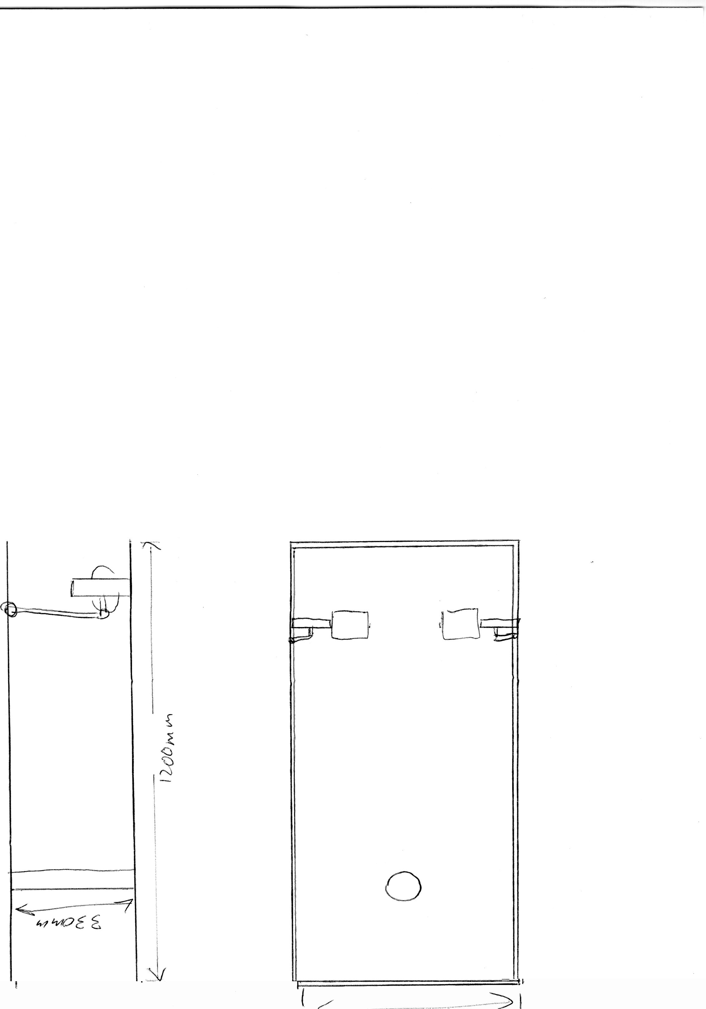

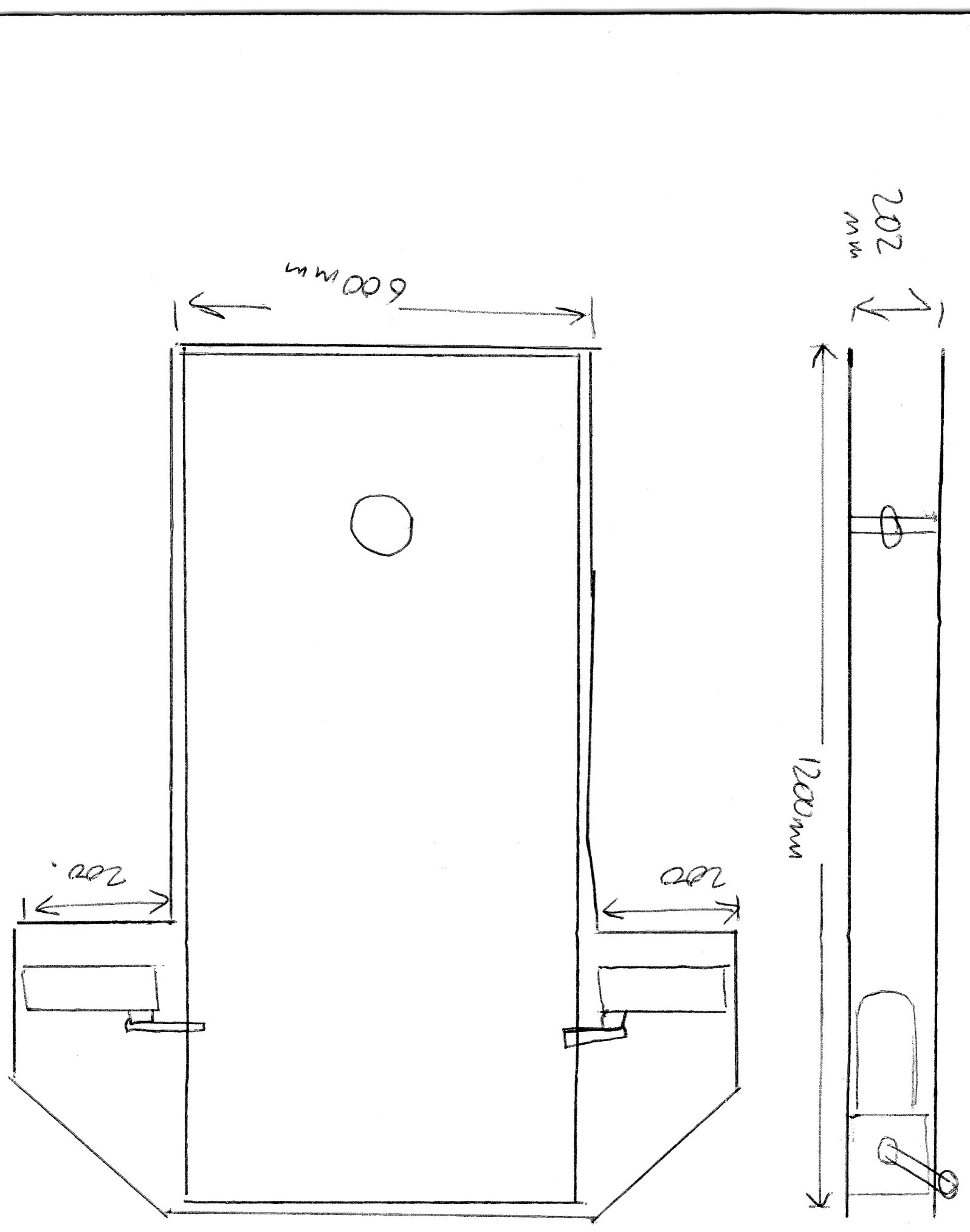

Maybe a big MDF base underneath, and put motors at front, like in the sketches.
