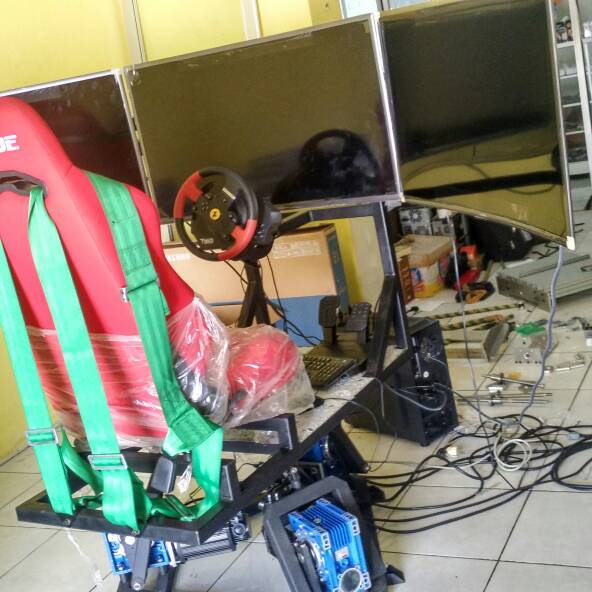

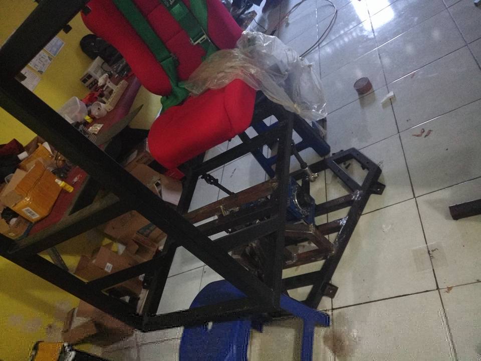

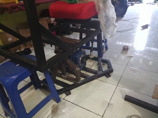

Today we made a new car with motion use AC servo motor 1.5kw 1:15 with 60Nm torque and we use 2dof
You can look at the picture
we use Eclipse for programing and i want to try X-motion so i want help for you all friend
that is my construction and we use Cross joint to made all joint
pleasse comand this we will happy
