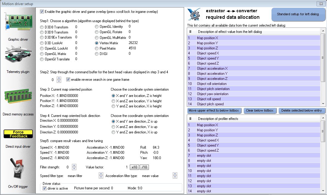

So far I have rFactor 2 working fine (with developer plugin from rFactor 1) in xsim3.
Then I tryed to get some motion from the Graphic Driver and I picked the only other game I have Installed right * pCARS.
I dont really like pCARS too much even because it dont had motion with xsim2.
Well, I have driver active on status bar and frame rates that vary from 25 to 60 when in the game main menu.
The only problem is that when I got on the track the game freezes immediately.

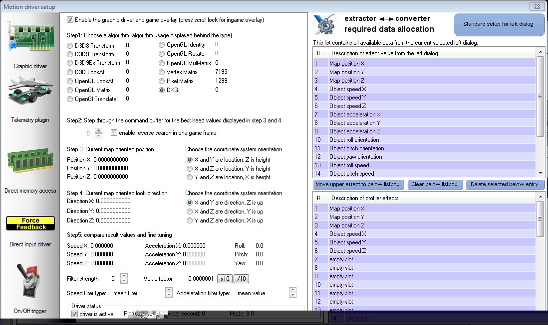

I tryed all DX algorithms available. Here I attached some pictures from the GD.
I will install some of my older games and try to get some motion from the graphics driver.

Dou you use the ingame overlay display or do you switch with alt/tab?
Re: My first try to use Graphic Driver
Postby RafBR » Thu 29. Mar 2012, 19:58
I tryed to use the overlay but did not work for me. I will try a little more.
Anyway the game crashes even if I do not alt tab. I set everything up before by * the profile and click to "play game" and it chrashes when it gets to the cockpit. I also tryed to run the game in standard and dx11 modes.

Postby sirnoname » Fri 30. Mar 2012, 13:22
I dont use keyboark or joystick to play pCARS. Only mouse to start game and steering wheel and pedals to play.
I say it freezes because I cant get out of the game or alt tab. Only ctrl alt del to close it.
This is very interesting. The framesrate is available while it freezes. Can you provide the game download?
The graphic driver will be the focus of the next year. Not all algorithms are included for now and they will be added step by step acording to the delivered not working games.
The stable algorithms are all exept the last three ones. This are pixel shader solutions and you know this is handled in the graphic card hardware.
