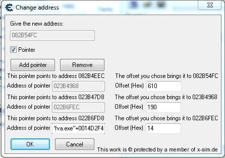

Hi to all,
this is what i found with CE,
how to setup in DMA in the extractor?

You need to enable the memory driver and then you have to read the manual where you have to set the pointers.

Hi sirnoname
The problem is what i need to write in the dma if you see the picture what is the base pointer and the ofsets aren't complete! Can you do a screenshot whit dma compeled whit my values? Thanks

This view is not what you have to find with the cheat engine.
For example the last fva.exe offset is not possible in X-Sim and do not make sense.
You can only enter numbers.
Do you have a explanation for that entry?

i now that only addresses are allowed fva.exe is a dinamic address i found the static address that generate fva.exe, found speed and gear value, all work with extractor now! now from speed i've calculated the longitudinal force but when i drive reverse gear the longitudinal is positive for the speed, so i think to find the real force but is to strong to do, any suggestion? the problem is that the game don't have a pause menu, only back to box when i press exe!
