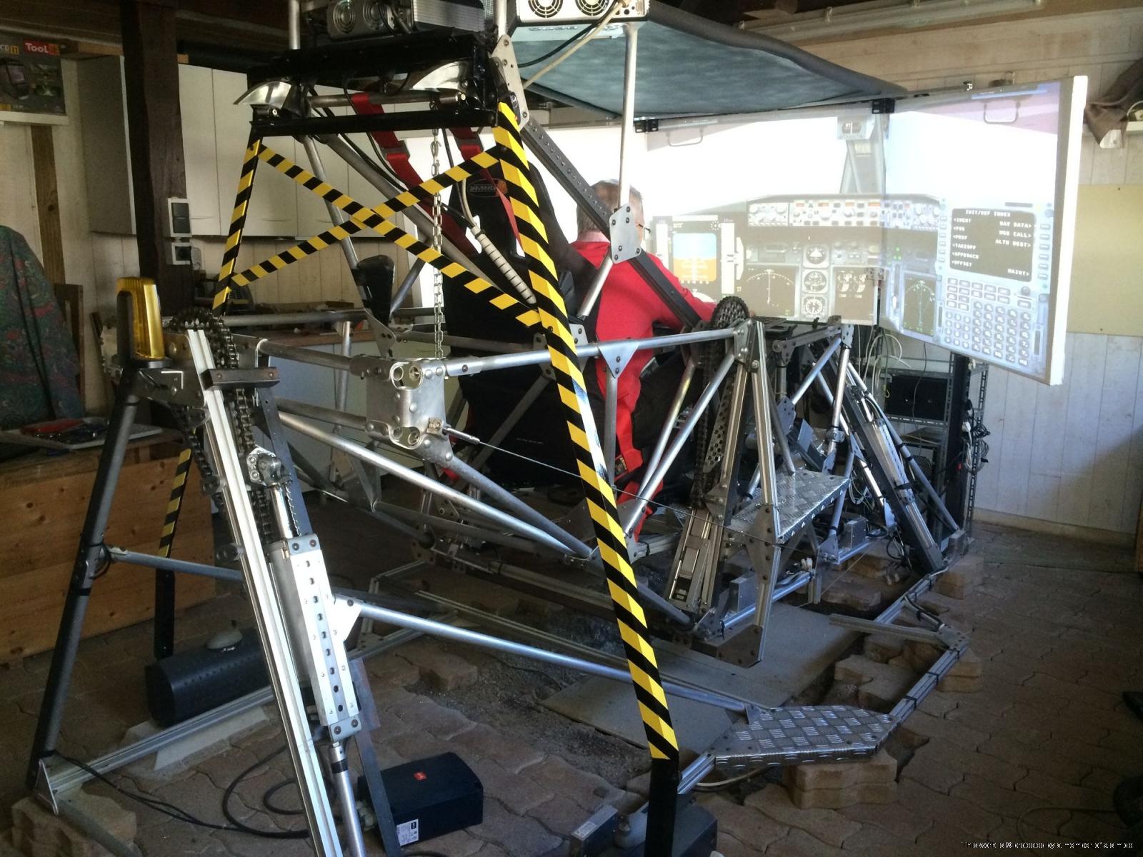

Is there a simple way to activate a switch or a led or whatever when the "Start" button of the Converter is pressed ? When inactive, my rig is held in place by a kind of hoist (see picture), which I regularly forget to retract when I start the converter (you can imagine the disaster for the poor actuators...). The ideal solution would be for me to automate this retraction, based on a signal or status received from the Converter...
3744
Thanks in advance for any help or suggestion

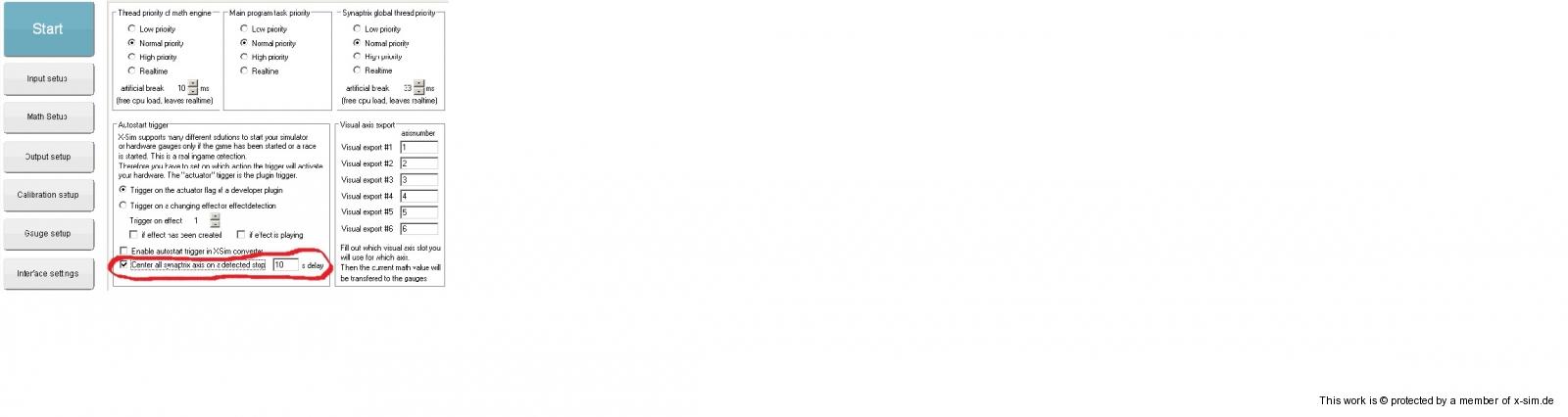

- "center on stop in program setup" : did I understand well, this is here :
3756

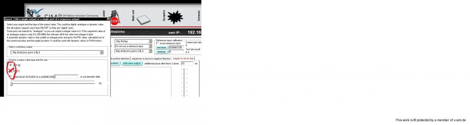

- "set on stop to zero and all other to 1" : did I understand well, is this the right page to do this :
3757
