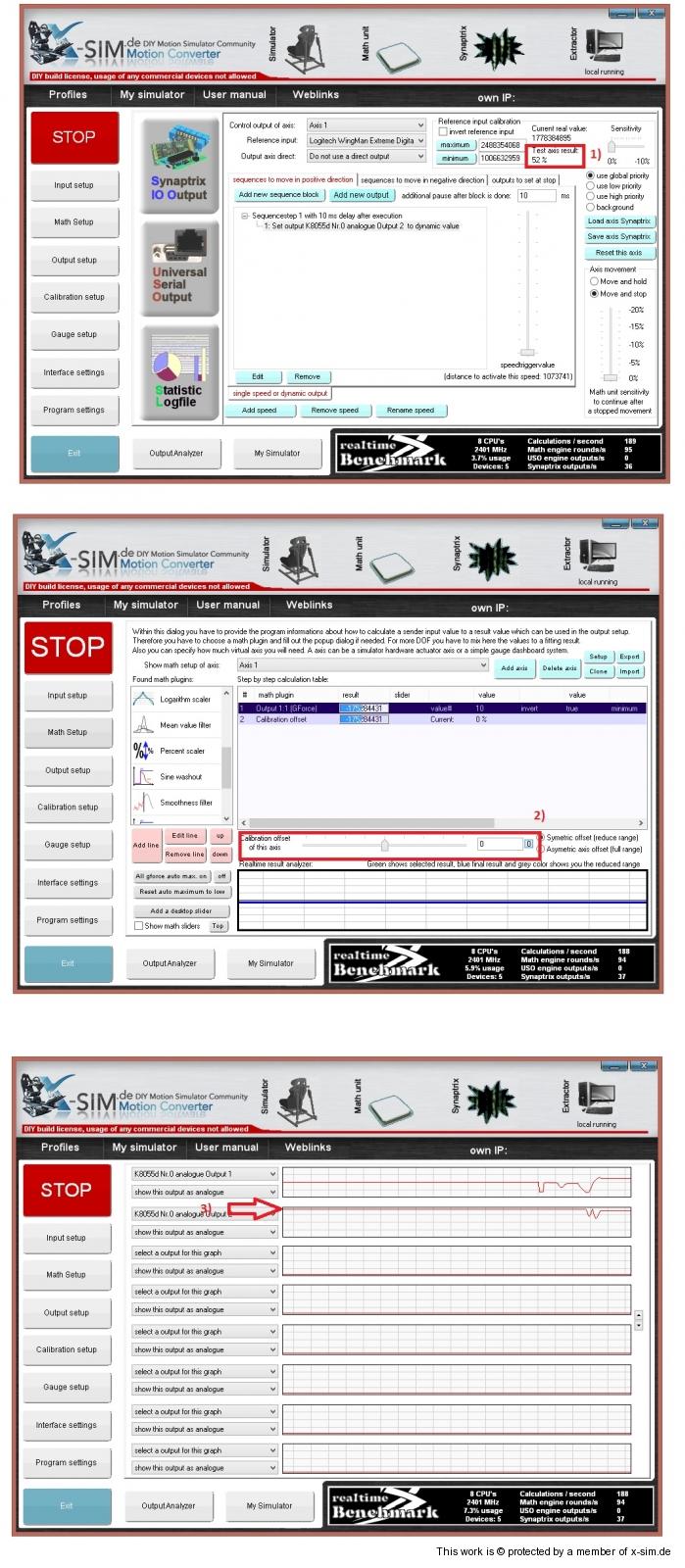

Hello everyone
I found out the following problem and maybe someone knows why that occures. In the picture you see 3 screenshots:
3160
1) As you can see, my simulator is in a horizontal position of more or less 50%
2) The calibration offset is 0
3) Why is the output value so high? Also the value from the RollerCoaster software is more or less "centered" means, there is no tilt motion because standing at the start place. But the output value is increadible hight...
Could anyone help me?
Thanks a lot and have a nice weekend
Andi
