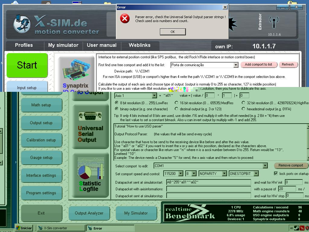

Please, I'm having problems with the initial configuration of the X-Sim 3.0.0.6.
What can this be? :?:

Postby sirnoname » Sun 1. Jul 2012, 09:39
one tilde is missing before a01!

sirnoname wrote:one tilde is missing before a01!
Sirnoname Thanks, that was it solved the problem of error! / Valeu sirnoname, era isso mesmo, resolveu o problema do erro!

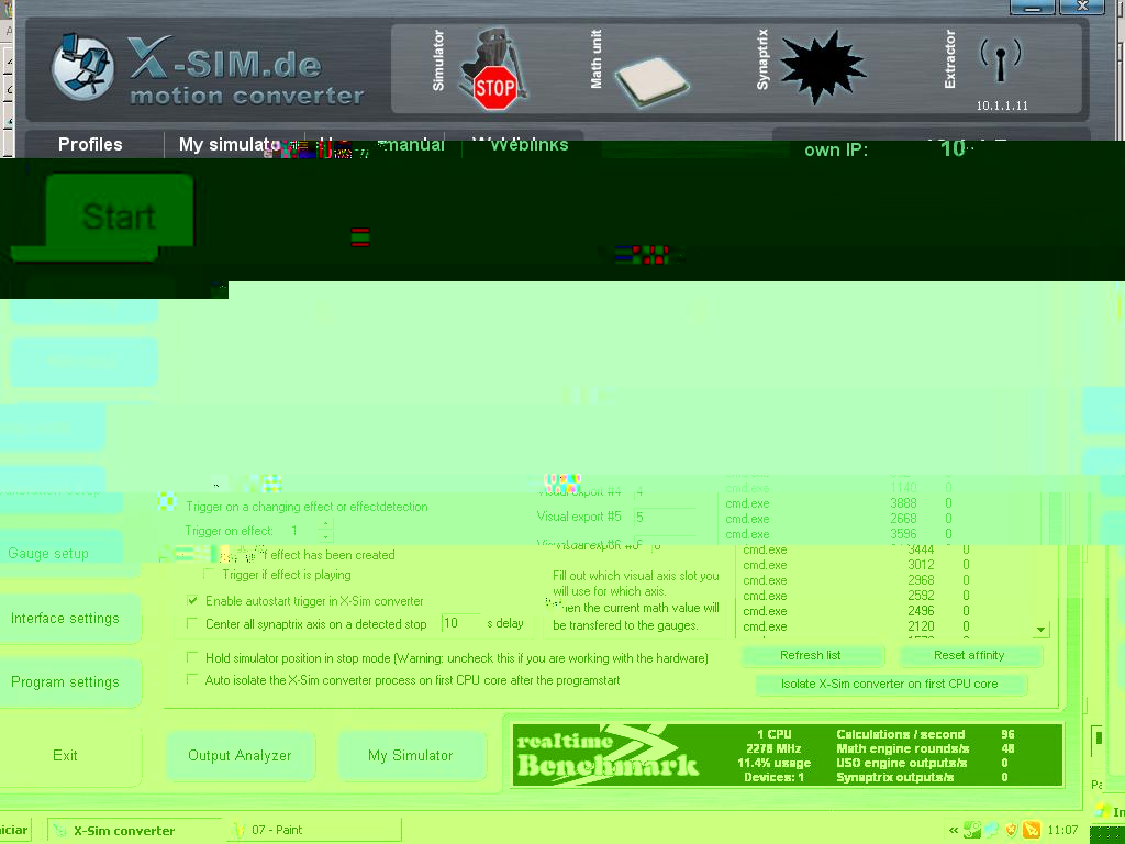

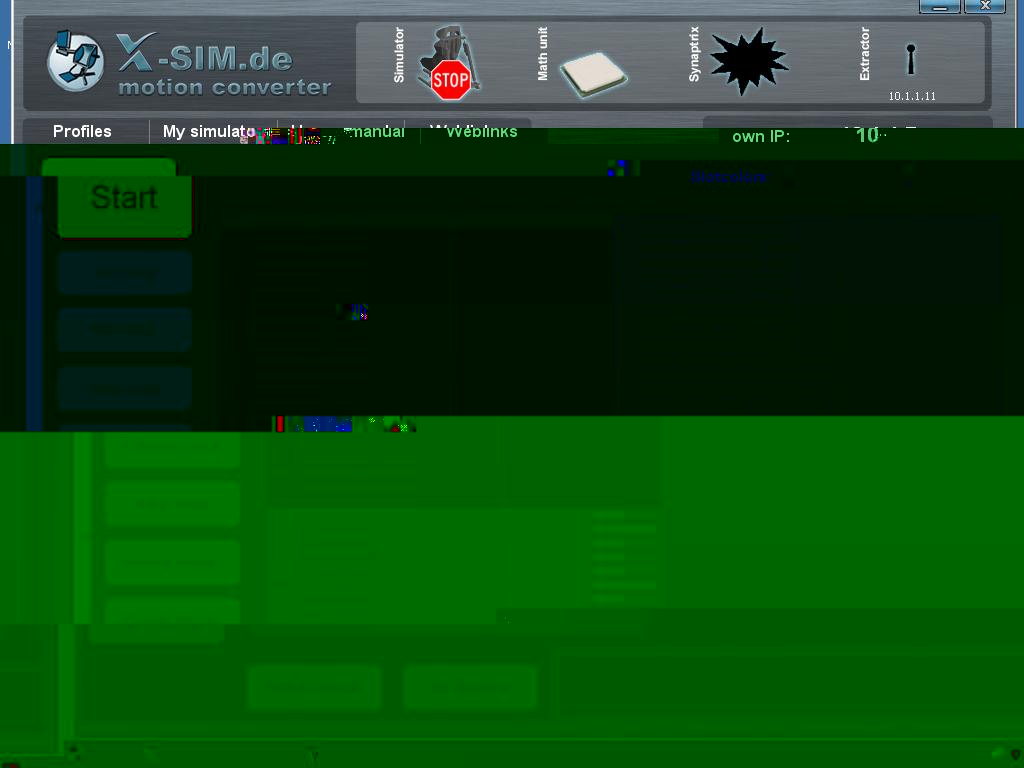

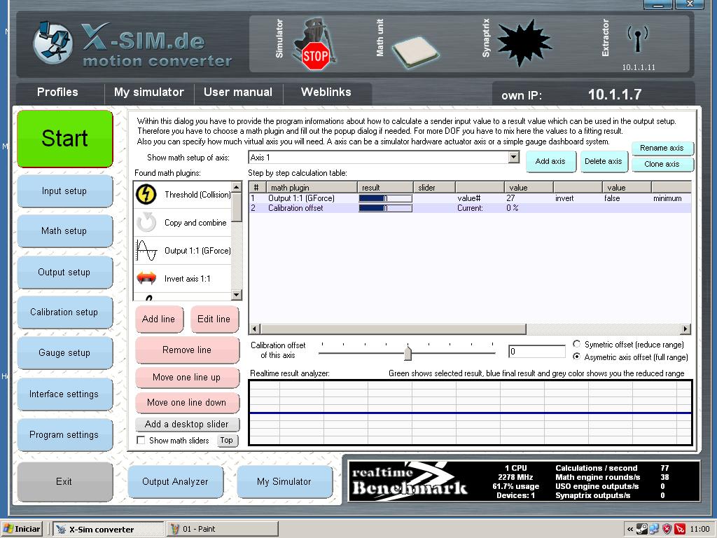

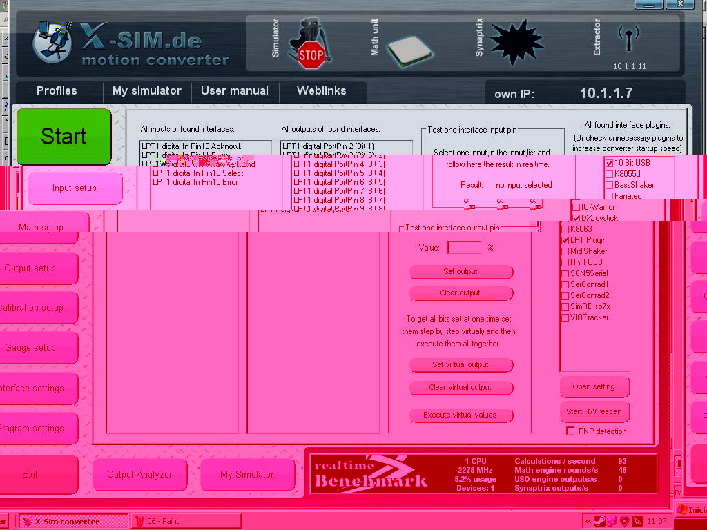

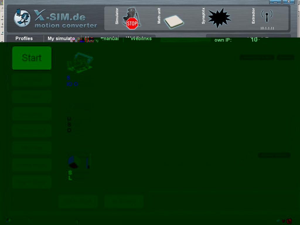

Now I have one more question, because there is still something wrong, since revised several times and setting this equal to the X-SIM2 but I have no nesata screen: / Agora tenho mais uma pergunta, pois ainda há algo errado, já revisei varias vezes e a configuração esta igual a do X-SIM2 mas não tenho resposta nesata tela:
I'll post all the configuration screens, so that information can help:
Vou postar todas as telas de configuração, para que as informações possam ajudar:

Postby tonquites » Sun 1. Jul 2012, 16:12
This next screen is on another computer on the network, the PC I'm running the game, and they comunição well!
Esta proxima tela esta em outro computador na rede, no PC que estou rodando o jogo, e eles se comunição muito bem!

Postby tonquites » Sun 1. Jul 2012, 16:23

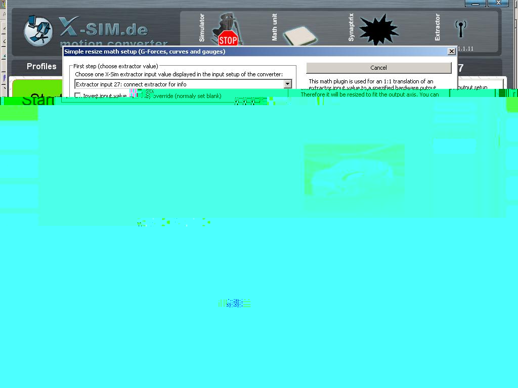

This screen I do not know what it does, the options are all locked.
I think it may be because this screen, the communication between Converter and Extractor is not occurring.
I also do not remember a screen of the X-SIM2.
I think I'm very close to getting, hehehe.

Postby sirnoname » Sun 1. Jul 2012, 16:36
Change to the plugin driver, select the rfactor plugin (it seems to be setup already).
Then here in the forum is a thread where you have to copy the rfactor2 plugin.

sirnoname wrote:Change to the plugin driver, select the rfactor plugin (it seems to be setup already).

Postby sirnoname » Sun 1. Jul 2012, 16:52
The rfactor driver is designed for 1+2 but the rfactor2 plugin file which has to be copied to /core of rFactor (read the thread) is also needed for the game itself.
You have to press the default button in the above screenshot and then it works.
a.) copy rfactor2 plugin out of the zip file to the fitting game plugin folder
viewtopic.php?f=30&t=110&hilit=rfactor2
b.) activate rFactor plugin in the plugin driver
c.) press default button
d.) play game with play button
