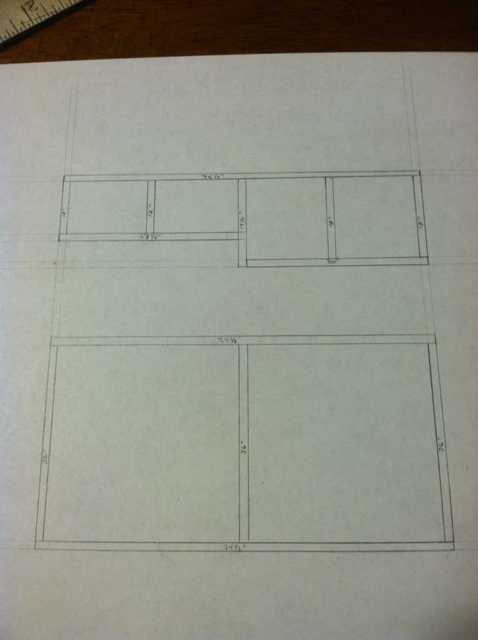

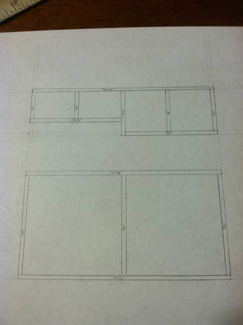

Postby eloverphx » Sat 30. Jun 2012, 06:27
Ok finally getting some work done on my sim after a lot of down time. I have to get this mostly built before I move to Wisconsin around August. I have more resources and friends to help me here in Phoenix.
Anyways here is my drawing of what I have in mind for my cockpit portion of the simulator. Side view and top view just for width dimensions.
Please give me some input if I am not on the right track as I plan on getting materials this weekend. Thanks everyone.

Starting a joyrider setup
Postby eloverphx » Sat 30. Jun 2012, 18:36
Thanks bob. I was going to start a project page as soon as I started the cutting and assembly of the project. I just wanted to make sure I was on the right track.
