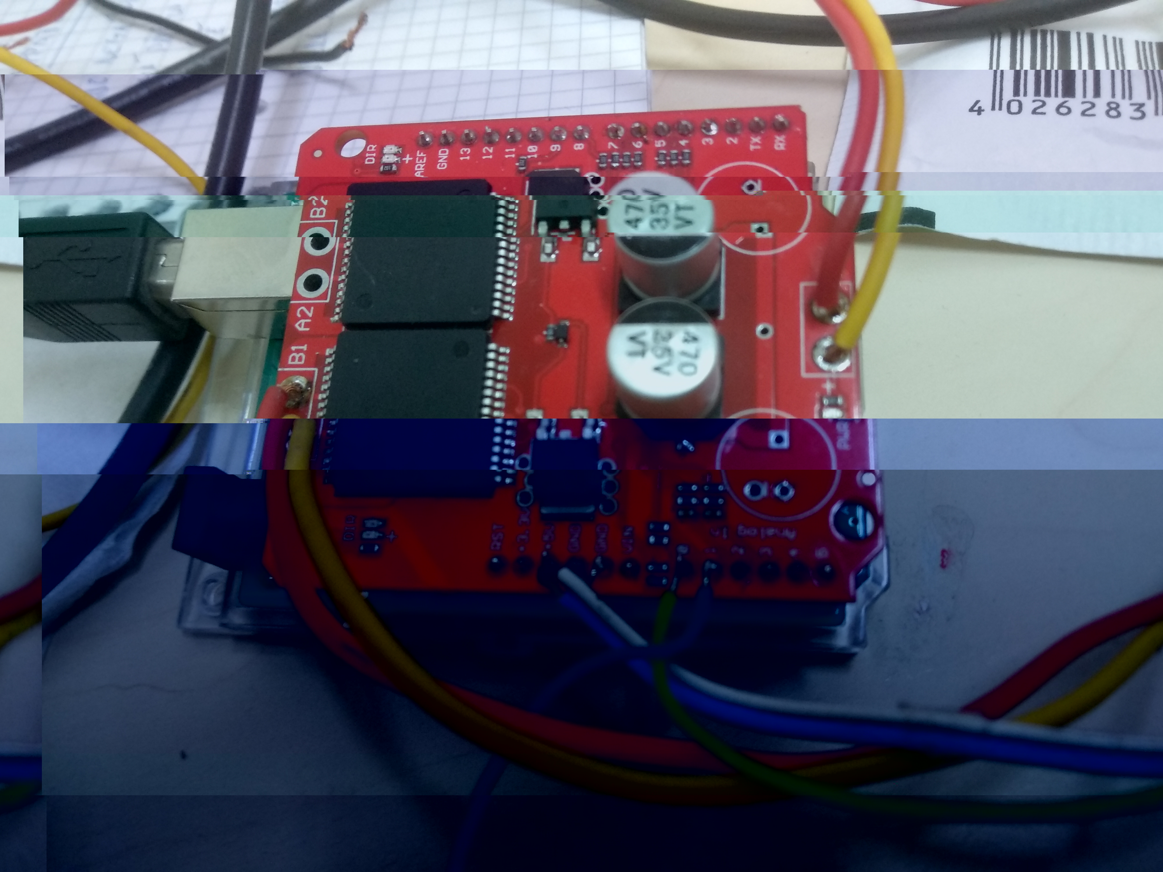

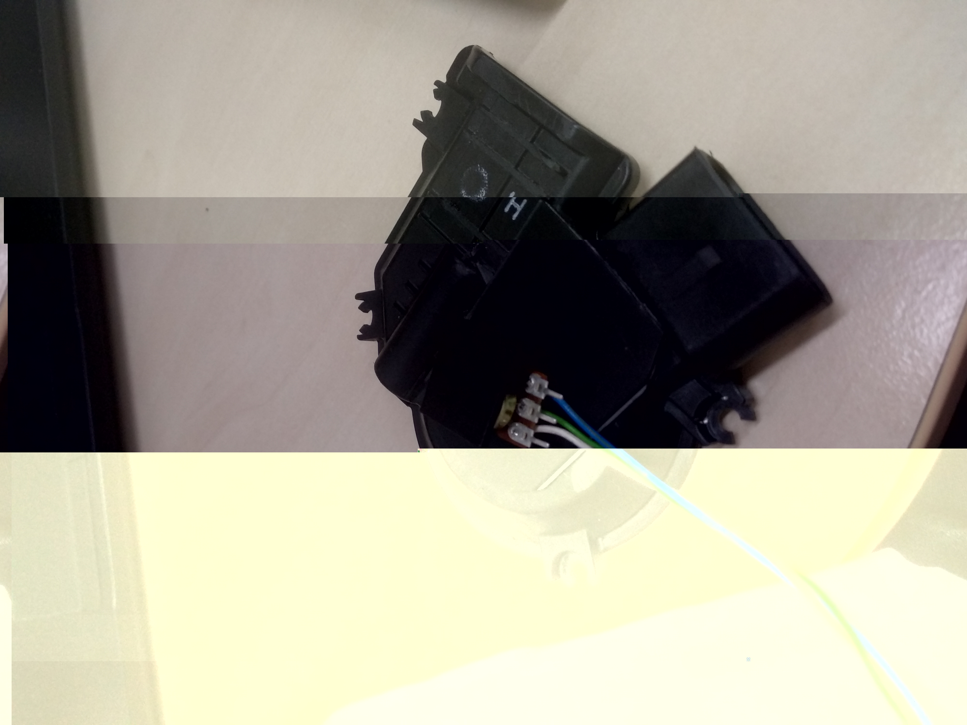

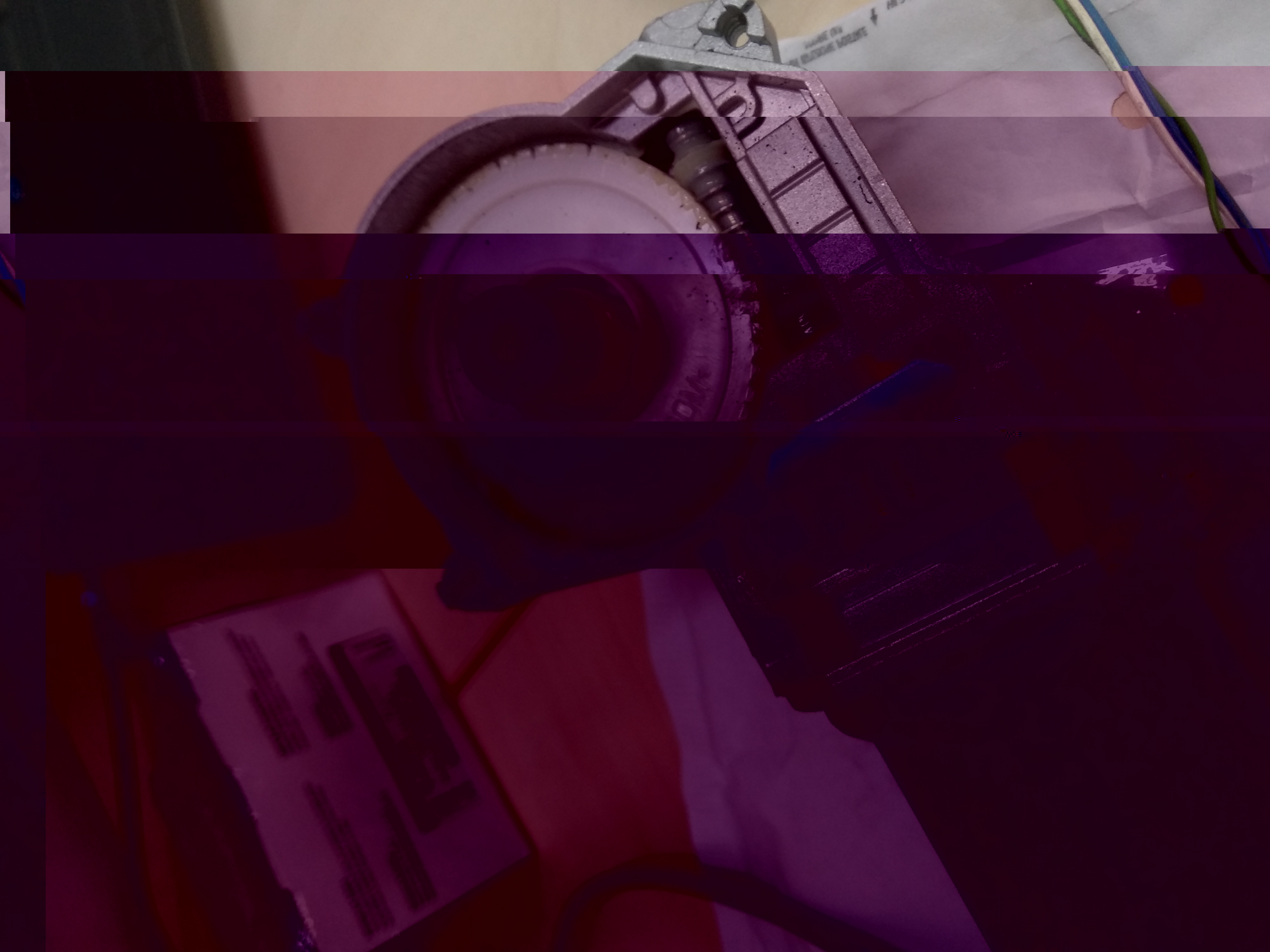

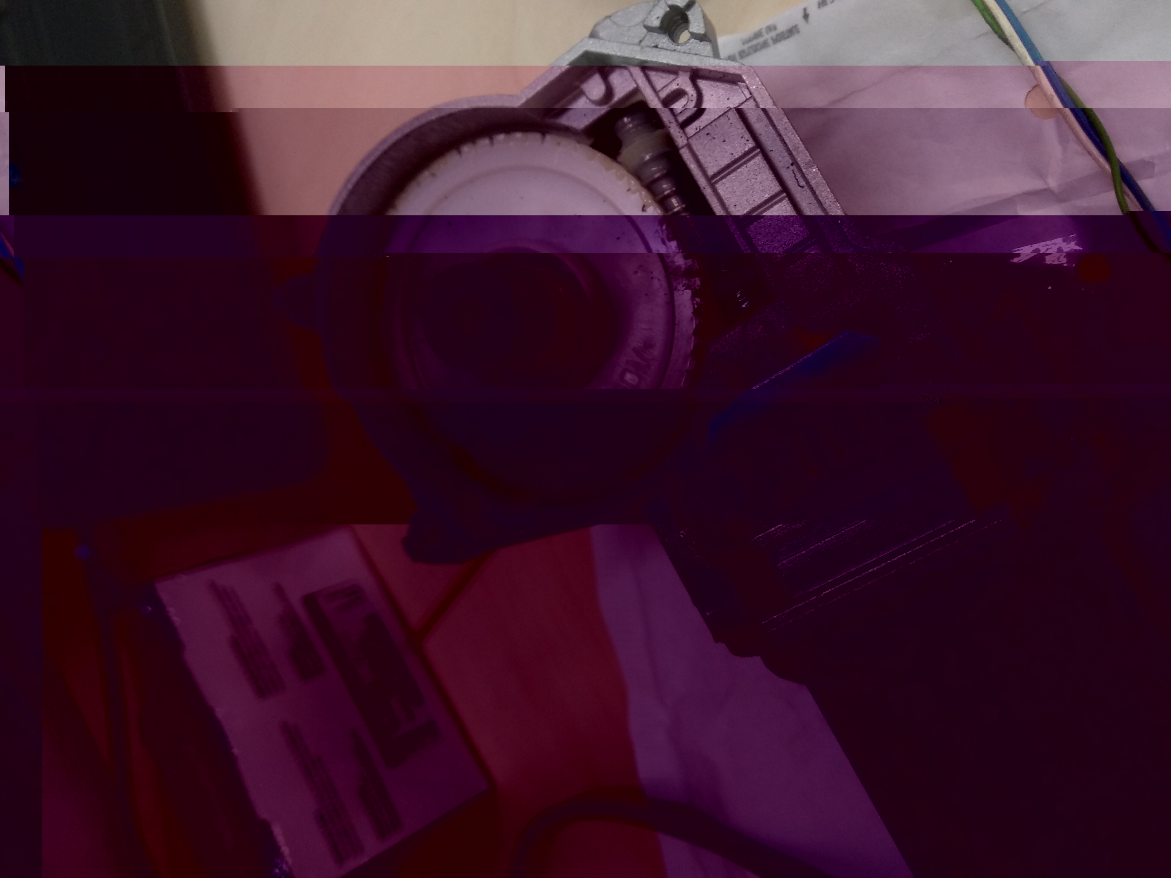

Postby RacingMat » Thu 22. Aug 2019, 12:00
please post pictures of your electronic board, your motor and pot!

Postby nevendary » Thu 22. Aug 2019, 12:24
The grey wire is not connected to anything at this moment. Sorry for bad way to connect stuff, i just had no other option at that moment. I already ordered some terminal connectors and such.

Postby nevendary » Mon 2. Sep 2019, 08:14
Solved it! It was faulty Monster Moto shield.. switched it and works.
