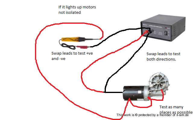

I learned by myself that you have to take care about your motors!!! I grilled one of my Jrk's because of a leak of ground.
The goal is this:
http://www.x-sim.de/forum/gallery/image.php?album_id=2&image_id=246 (thanks Bobbuilt)
1. Test the motors with out the Jrks plugged into it. basically if your power supply can run one or both motors in both directions, this can be do by wiring the motors directy to the power supply, then a quick on/off or diconnect your pots and test that the power supply can spin them in both directions.
While spinning test with a test light by placing clip on positive of powersupply and the probe on the casing, test in serveral spots if it lights up ya go a power leak not good will cause jrk to drop out evem blow up if there is enough amps.
The place the clip on the earth of the power supply and probe on the motor body in several spots and if it lights up you have a earth leak.
If it fails this and you cannot isolate them then i suggest finding some new motors.

With JRKS just wire it up right, there is not much chance of blowing the jrk, just get VIN correct mainly. Put heatsinks on the big chips and fan cooling, but keep heatsinks clear of any other components on the board. Use 12v12 for sure. Also triple check the wiring for the pot.
Make sure the motors are earth isolated, otherwise stray 12v going through the frame could go through the pot and blow the jrk.
