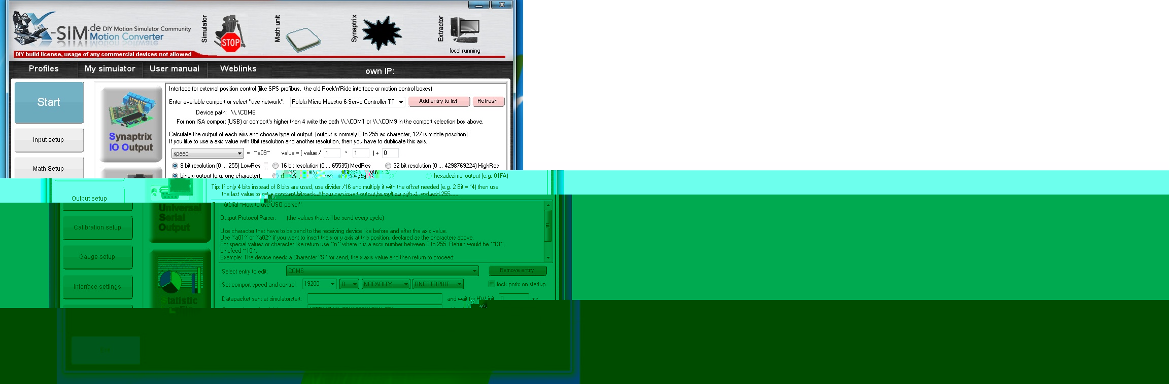

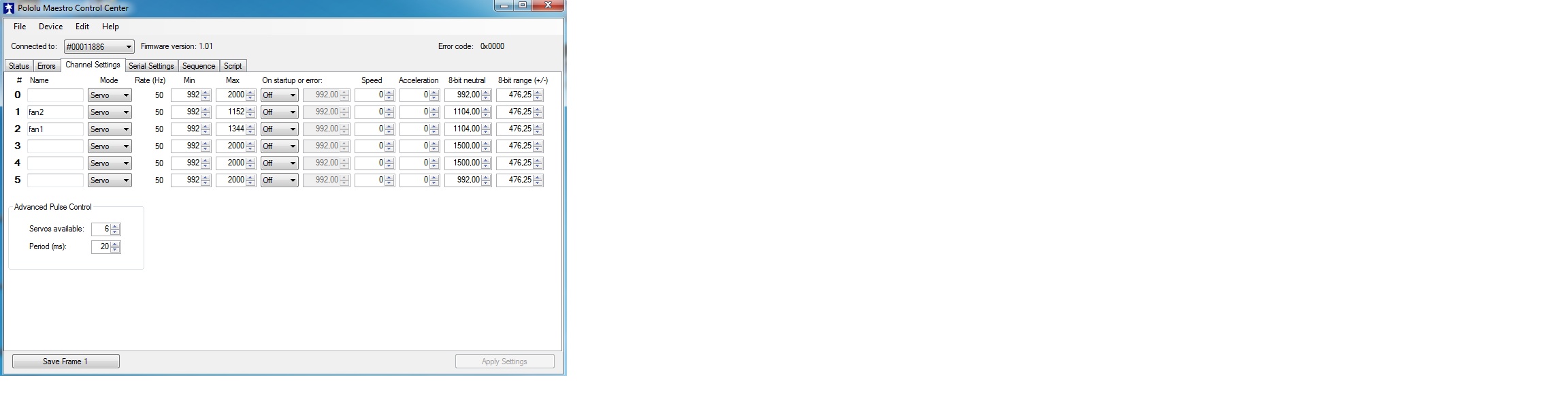

Postby chris1962 » Fri 20. Mar 2015, 18:39
Hi,
I further try to set up my fan system without success. Only one time one fan has been started if the speed in the race has been increesed and I could controlled the speed of the fan in the same way as the speed of the game. But I lost this adjustment in the next moment and I don't know wy and now there is no corrosponding between xsim and Polulo Maestro or better with the controllers of the fans
There are a couple of pictures which shows my settings and I hope someone in the forum has the same fan system and can help me.
Many thanks in advance

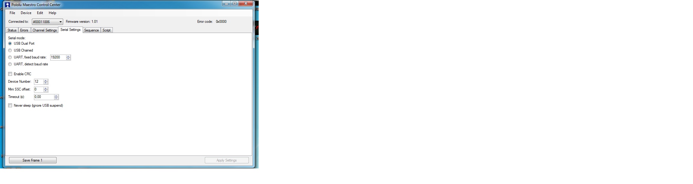

Postby chris1962 » Tue 24. Mar 2015, 20:43
Hi Guys
I think I have a problem with the communiction between xsim and pololu maestro 6 channel.
I use the TTL port and the Dual USB connection.But even if I start Xsim an error occure on the Pololu Control Centre 0x0010, and the connetion between Xsim and Pololu is interrupted. My guess is there is a mistake n the settings of my Comport. Does anyone know what I could do to establish the connection via the Comport?
Many thanks
