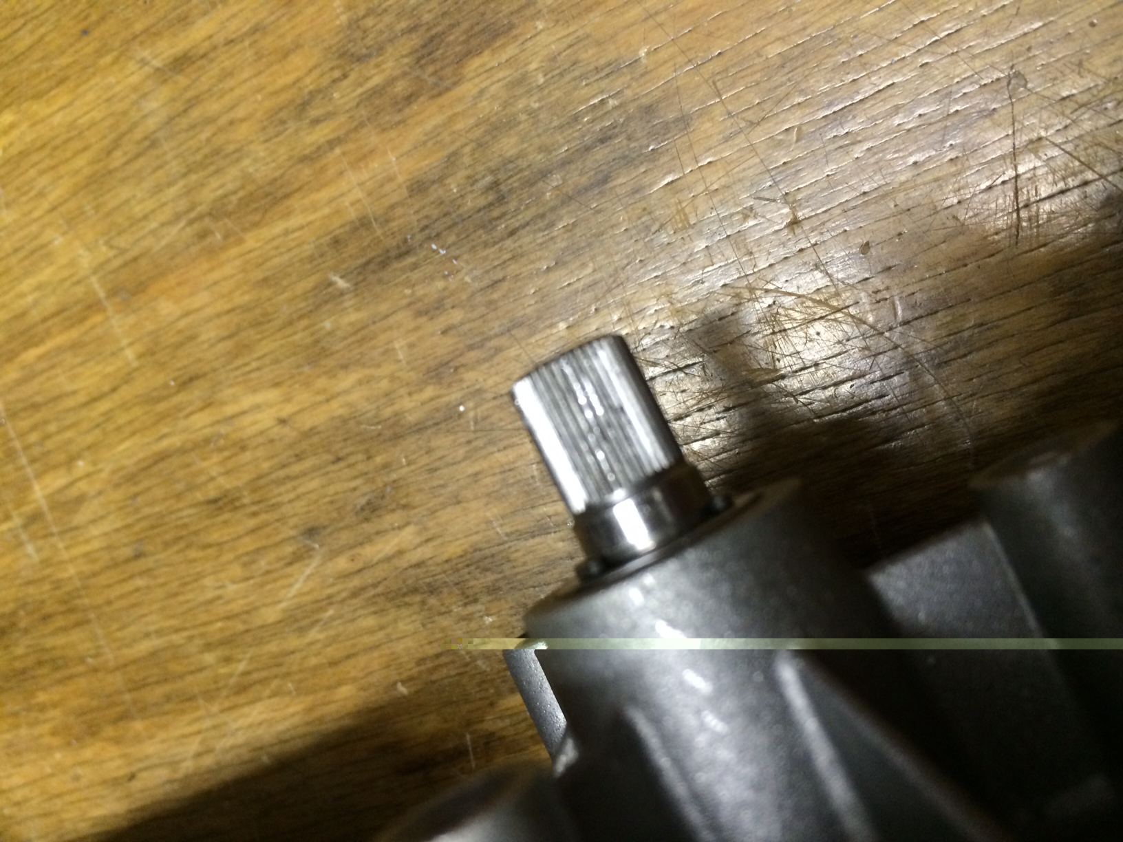

The speed of movement I need is not that big as in a race simulator because I want A flight simulation movement of my chair.
I have one problem which i cannot solve before I can go on with my project.

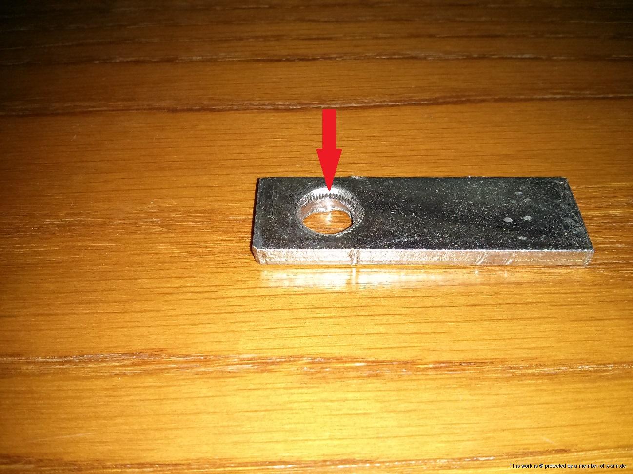

How do I connect an alu strip/ metal strip or something else on my wiper motor ax to move my chair?
Can anybody help my or give me good advice or explain me how i make an strip/rod with internal spline connection?
something like this:
gallery/image.php?image_id=3055

Is there a hole into the shaft? Can we have a look on the side?
Mat

Hai Mat,
Sorry there is no hole in the shaft.
The ax is solid with splines, exactly what you see on the picture.
Only welding i see as an option at the moment but also that is not easy i think.
Best regards
