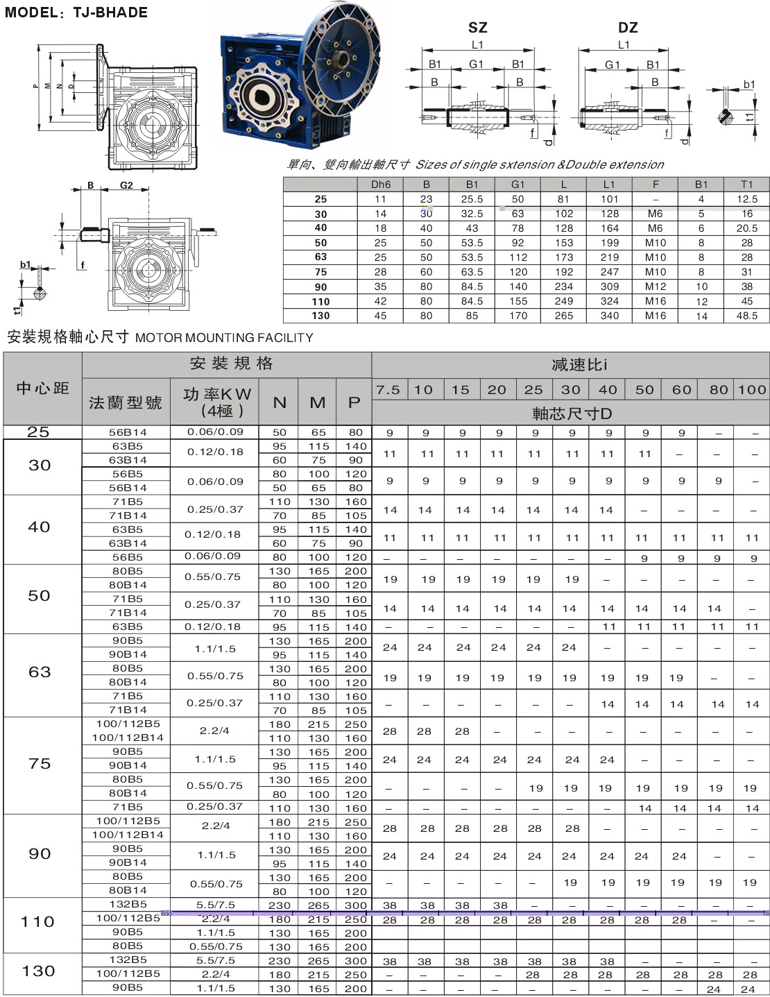

Has anyone experience with buying worm gearbox motors from China? They are much cheaper then here in Europe.
I've attached the spec document from the manufacturer. Motor type would be the K47 = 0.75kW for 6DOF configuration

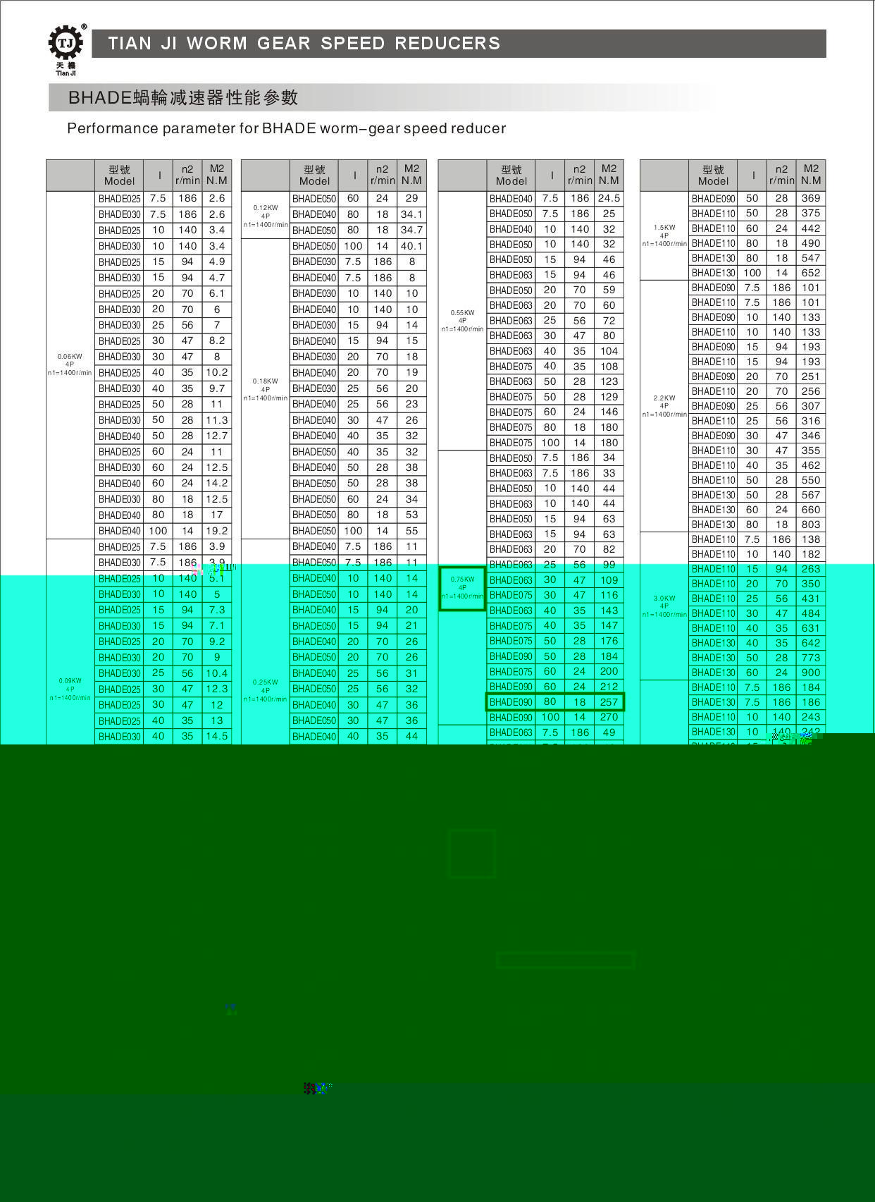

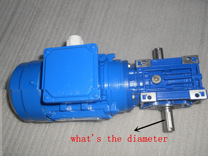

That would be very welcome. I'm currently orientating myself on AC worm gearbox motors for the Thanos 6DOF configuration in the Chinese market.
I think I might get them much more cheaper than here in the Netherlands. And most probably also with more precise specs for optimal 6DOF configuration.
I've attached a spec sheet with directions from the vendor what gearbox motor he could offer for me. Maybe you can have a check. Would be most appreciated :-)
Motor + gearbox
Gearbox spec sheet
Motor Spec sheet

I can tell you about these worm gearboxes will be fine. I have used them before on 6DOF with no problem.
https://www.youtube.com/watch?v=V9lN9RIt7UI
Fabian did use similar ones as well:
http://motionsim.blogspot.com/2014/06/6dof-fabi-progress-update.html
http://6dofabi.blogspot.co.uk/2014/03/project-start.html
Thanos
