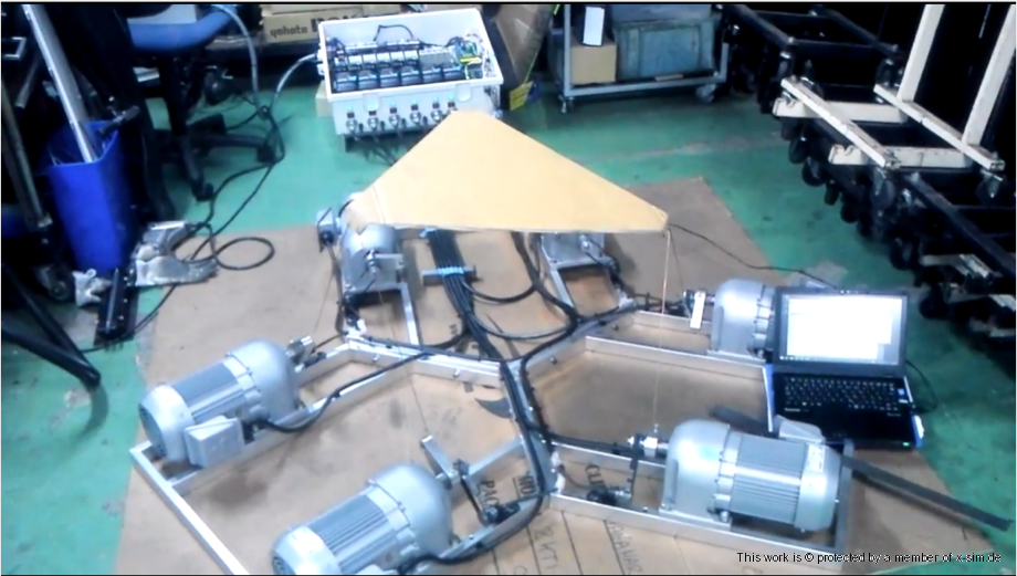

I am thinking about this other design which looks very promising from a member here:
2706
I would simply reverse the motors so that the outputs are towards the outside, instead of the inside.
I notice his motors are parallel to each other, but in the Ckas design, they are not:
2352
Is there a better way to place the motors?
