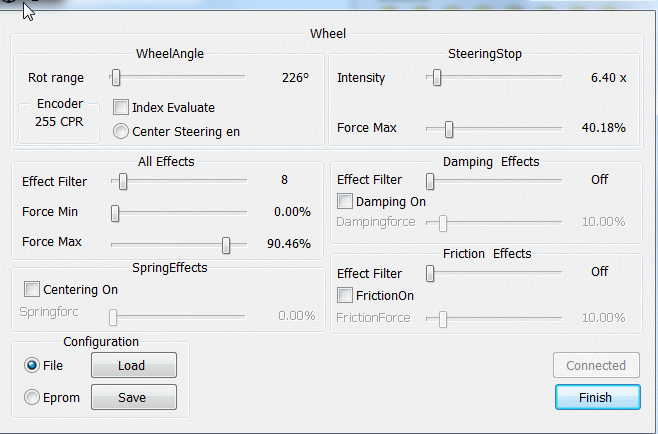

Just tried this on my spare STM32F4 discovery board... It works well! But how you get over the 3v PWM signals issue? Amplifier? Also the pedal axis give me only 50% travel range... Hmm...
The control panel utility looks good! :D

Postby metallo97 » Sat 2. Aug 2014, 10:33
How have you managed to make the control panel in English? Tried yesterday and it was only in deutsch... So do you think it's not suitable?
